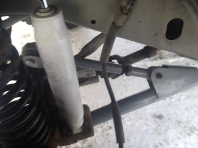

Teaser

SCHWEEEEEET!!! love it I love the look of LONG ARMS looks 100 times more stable.

Originally Posted by MOBBiN View Post
Teaser
radius arms, not long arms lol
what brand? tnt?
can you explain the difference to me? I haven't been able to figure it out lol
y have radius arms, they are 2 lower arms with uppers coming off, true long arms are the same set up as factory, just longer arms. like BDS is a true long arm set up. radius arms bind more than true LA. but true LA require usually 4.5-5"+ of lift to clear the upper arms for clearance up up travel.
nice! hows it feel? flex?
I've only done a little pavement pounding since the install. I need to install longer brake lines before I take it off roading
Gotcha
Gotcha
nice, i wanna do BDS 4 link. but $1000 is a lot of money lol did u buy them new or used? price?

I bought a parts Cherokee for 700$. Had the 7.5" RE LA kit on it. I traded the 7.5" springs, shocks and leafs for 5.5" RE springs & leafs with OME shocks. I'll be installing that stuff in a few weeks
ah i remember reading that haha read so much on here i forget what goes where haha for that i would do it too.

thats a heck of a deal! looks good though, I never knew the difference either, either way better than stock I would imagine.
