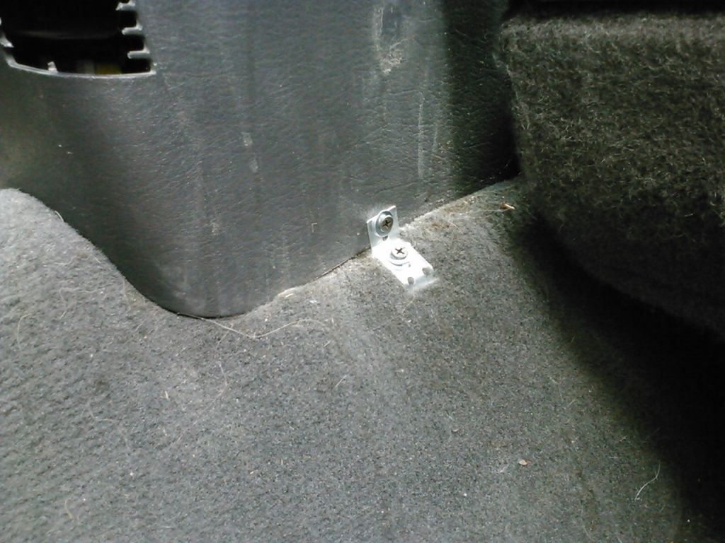

First thing I did was address the wobbly center console. The screw mounts inside the cubby were broken off so I used some self tappers, washers, and brackets that I had in the garage to secure it down:
It's not pretty but no more wobble to the console as I'm bouncing through a trail

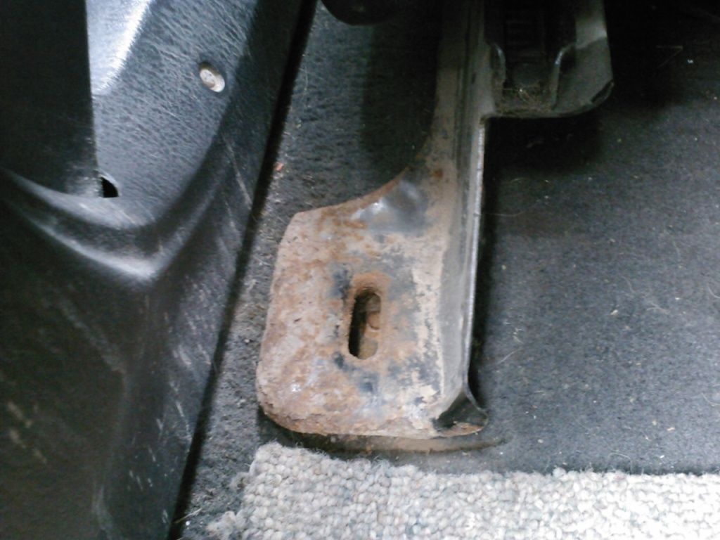

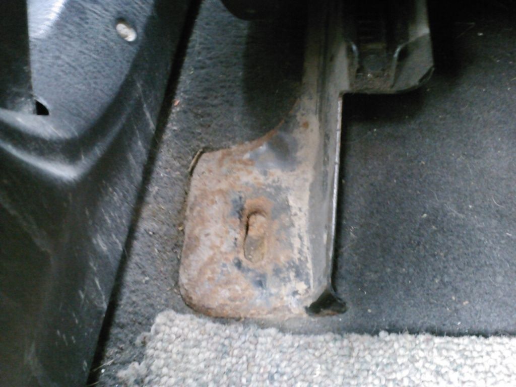

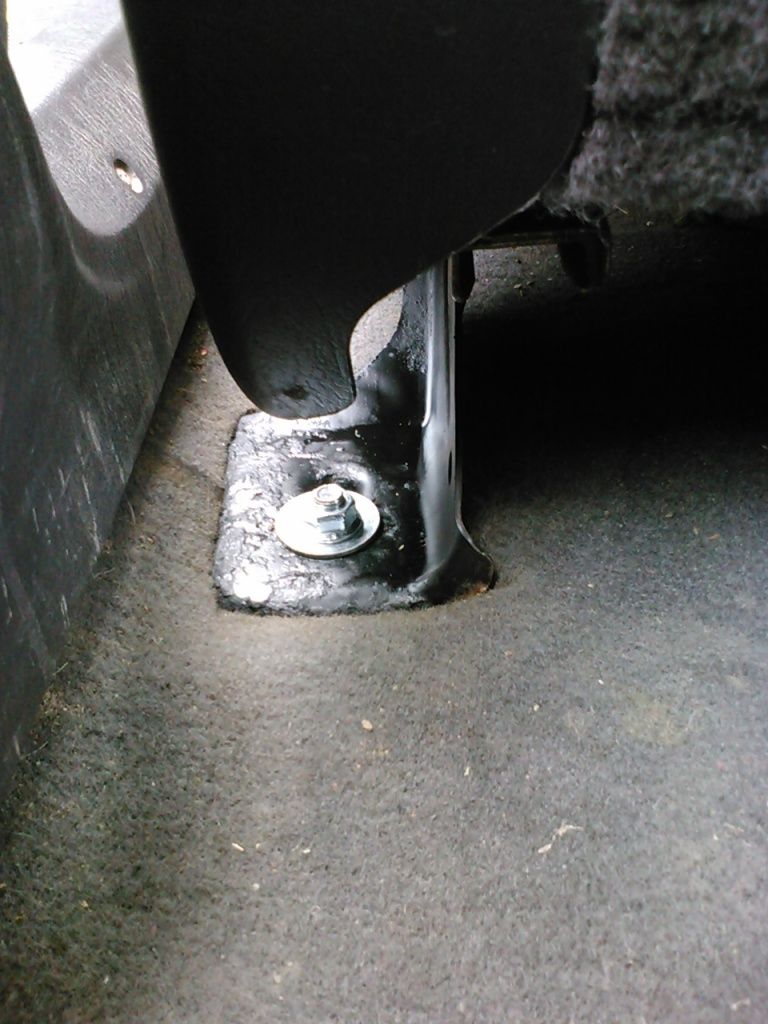

The next thing I did was put the screws to the seat brackets. Neither the driver nor the passenger had bolts running through the back outboard mount:

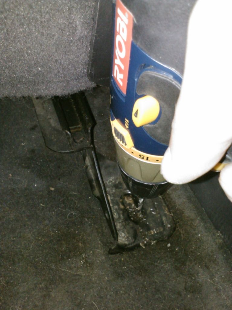

So I drilled through the floor board with a pilot on up to a 3/8 bit and bored it out some:

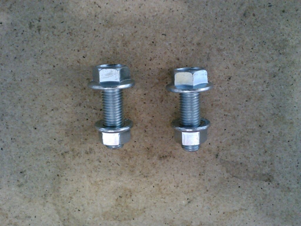

I ran up to the hardware store and got some M10x1.25 flange bolts and nuts:

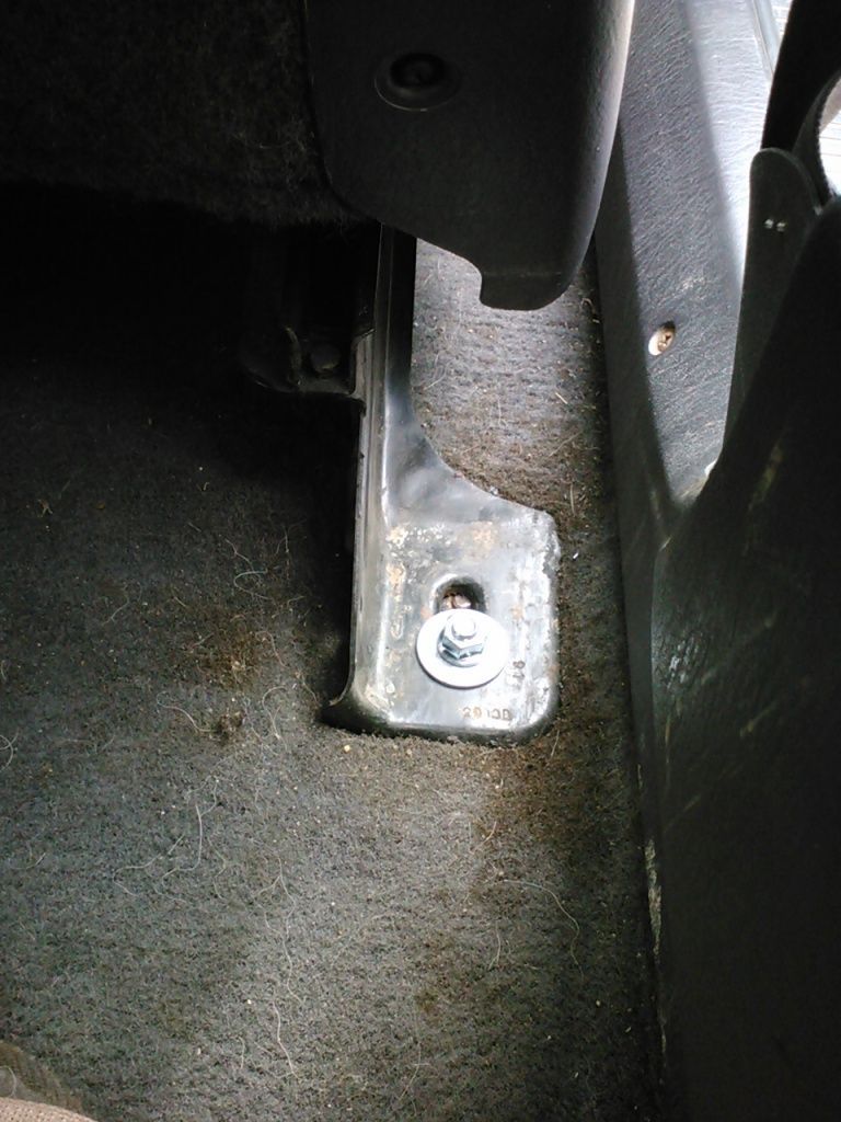

I sanded the rust down best I could on the driver side and sprayed some Rustoleum on it and after it dried I used some washers I had in the tool box for the underside and topside and bolted the mounts down:

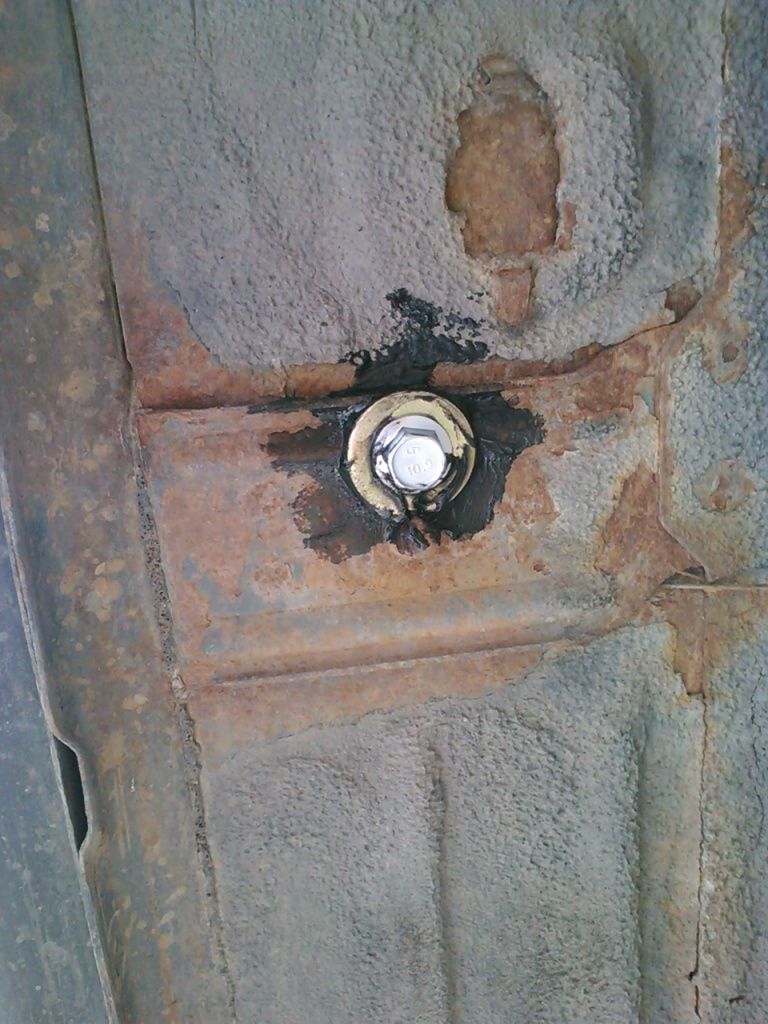

Then I coated the underside bolthead/washer with some rtv:

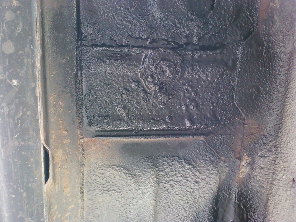

Once it was good and skinned over I sprayed some rubber undercoating on the underside bolts:

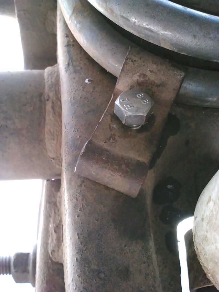

The other thing I did was figure out that the coil spring retainer clip bolt is an M8x1.25 thread bolt. So I cleaned the threads up and hole with a tap/die and resecured the passenger side clip. I used a different bolt I had laying around but I might come back to it and retap with a different size bolt 'cause I'm not convinced this did the trick:

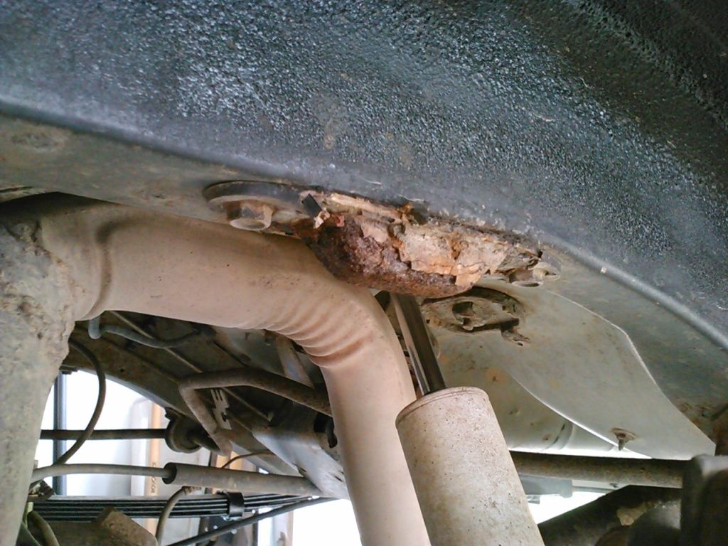

Well I have no rear bumpstops as of right now
The other day I noticed this:
So I ordered a set of 4+" oe rear bumpstops from Quadratec - at 9 bucks apiece I figured why not. They were delivered yesterday so when I got off shift this morning I took a look at 'em and they're Crown manufactured and seem to be pretty stout quality.
Anyway - went to take the old stops/mounts off and 3 outta the four boltheads snapped right off - easier than a twist off bottle a beer
I attempted to drill 'em out but w/o the bigger jackstands I'd borrowed last week I couldn't support the body to let the axle drop far enough to really get a drill in there.
In my head this was such a simple job In the end I got nothing done.
I mentioned the other day this thing can be a cranky mofo sometimes and today it held up to that

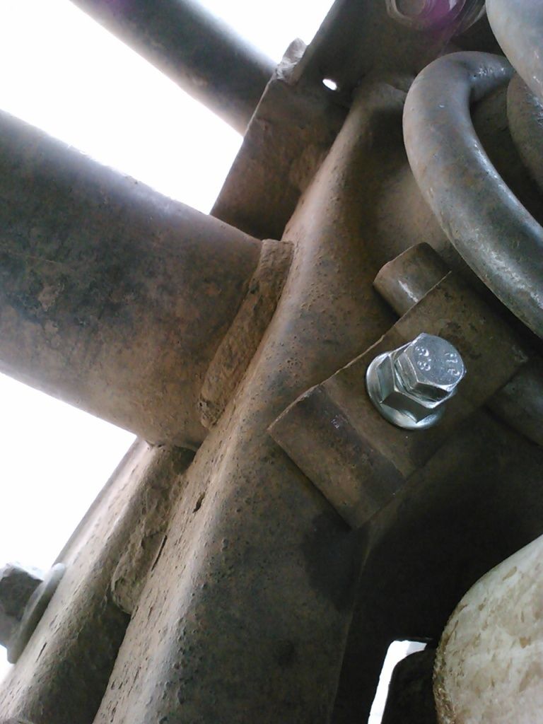

I got the passenger coil reseated/rotated in a better position today. Also redid the retainer clip bolt. Drilled it out and retapped it for an M10x1.25 and put a new bolt to it.
The bolt head is too big and hits the clip on the coil side so it doesn't seat the all the way down but it is tight.
