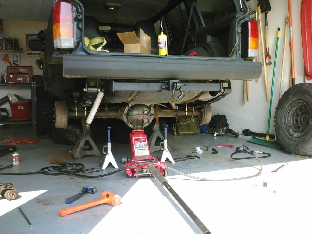

Okay - got the new springs in so the XJ is back in service.
This is where I left off last night:
It was't as bad as I thought - but it wasn't easy. The front eye bolts were not budging after days of PBB and the airgun at max torque. I had to get a 1/2" drive 15" breaker bar and some MAP gas and torch tip.
After heating the crap outta the bolt and wackin the **** outta the breaker bar with a BFH I was able to get 'em out
Once I had them out I was able to see that the front bolts I had weren't gonna work - wrong thread. So I made a trip accross town to a dealer for these:
I took a pic with them in the packaging for anybody needing a part # for reference.
Once I got the old springs out it was time to lather everything with anti-sieze (I dabbed some in the front eye nutsert as well):
With everything lubed up I started with the front eye (hand tight); then the u-bolts/plate/disco connection (again hand tight); then finnagled the rear into the shackle. Using handy jackwork under the pumpkin will enable an easy alignment while you pull on the rear of the spring and hammer home the shackle into position:
Once that's done I jacked up the pumpkin to "load" the springs and finish cranking all the bolts down:
I didn't take any before measurements so after measurements are pointless. I think to the naked eye the backend boosted up a bit - not much - but the sag is gone. I had to go pick the pup up from the vet so I figured what better way to take it for a test spin.
The rear springs aren't exactly a soft ride but who cares? They don't sag, they seem to hold weight better than the tired stocker/AAL, they have a built in 4* shim that puts my pinion at a better angle, and they're brand new

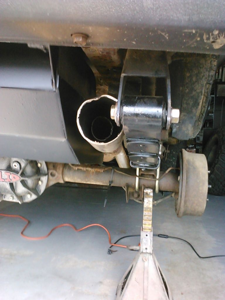

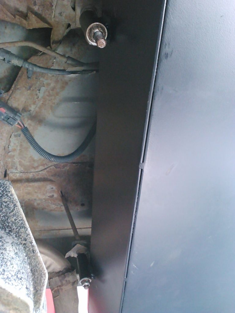

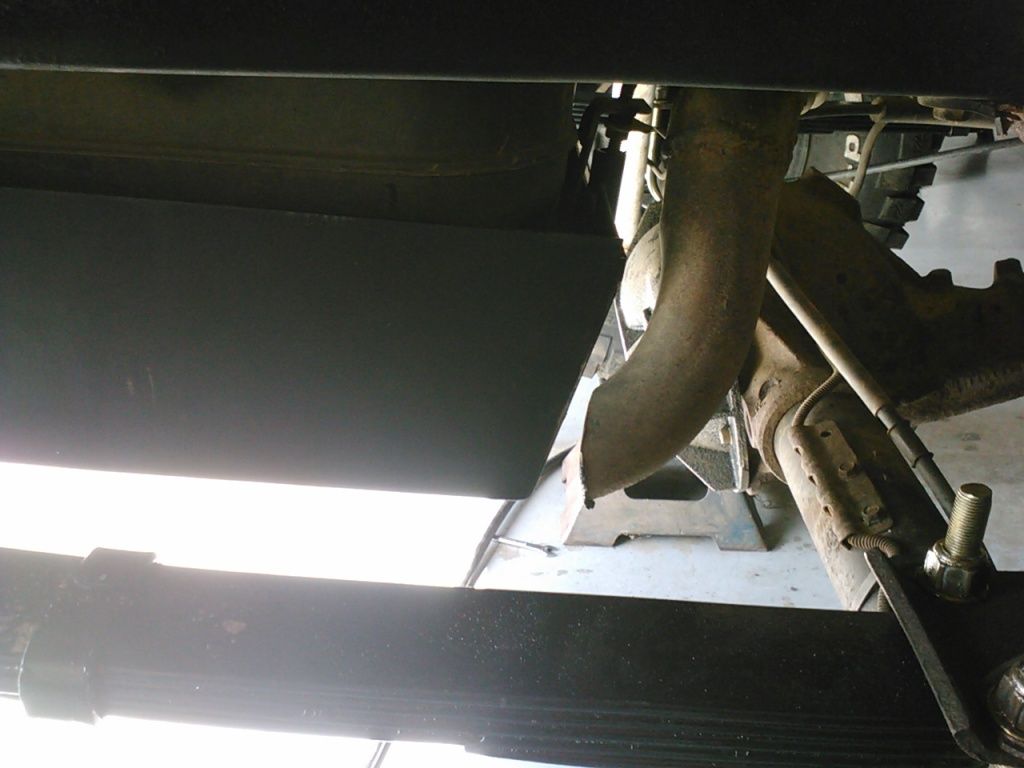

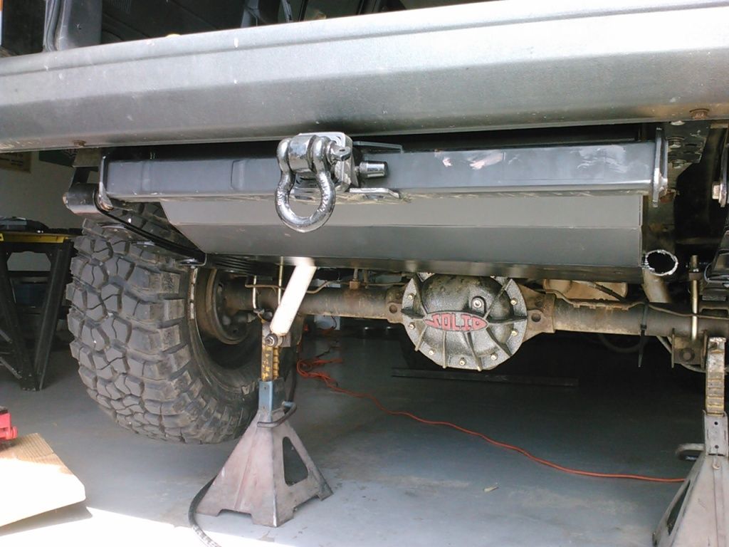

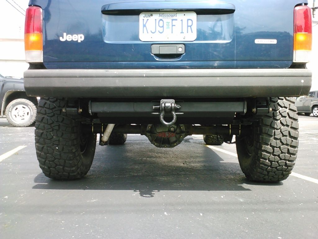

This morning I took to the task of installing the Tomken fuel tank skid that was delivered a couple days ago. I decided on this skid for a couple reasons. The cost was good as I got it from a vendor on JF for for a good price including shipping. As well, the way it mounts is front and rear of the fuel tank so I wouldn't have to dismount and remount the hitch (which was a complete PITA the first go around).
As it turns out, I had to pull the hitch off anyway in order to install this skid plate. Once I got it in place w/ a couple bolts to test fit it I realized a couple other modifications would be needed. First I had to get rid of the heat shield on the passenger side of the fuel tank. Then, I had to cut the tailpipe back because it just wasn't gonna work:
After that was out of the way I tightened everything down:
Then tucked the hitch back up (which was actually pretty easy this time):
And for anyone needing/wanting to know if the Tomken fuel tank skid fits with a factory hitch - the finished product:

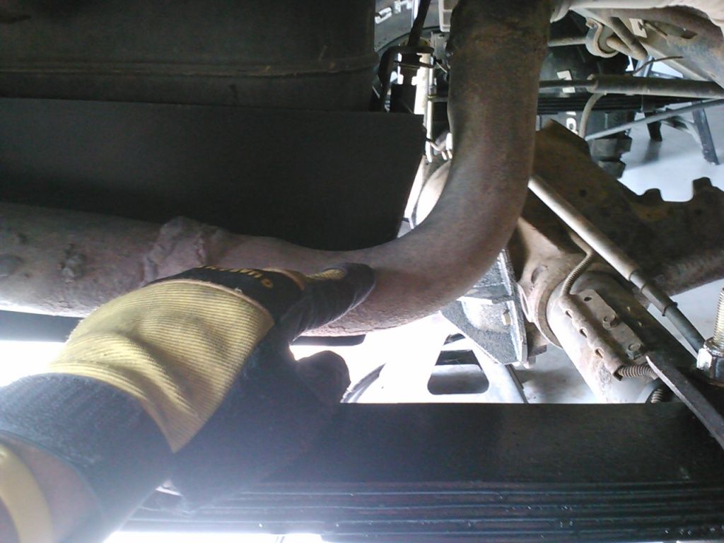

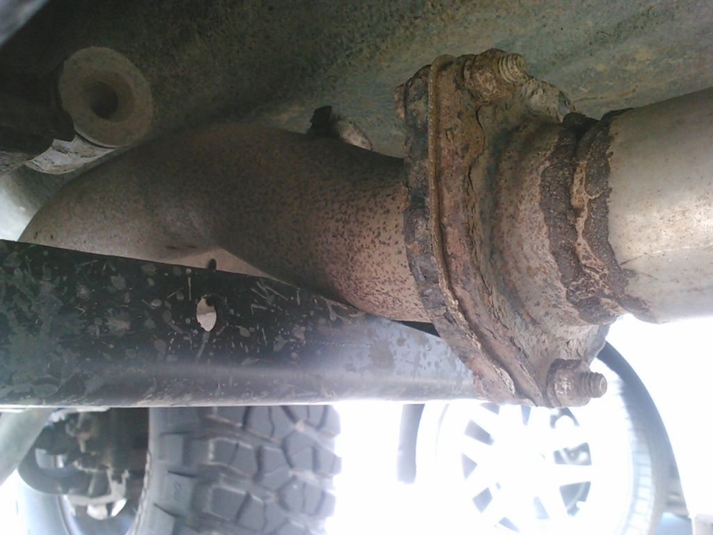

Been having a knocking/thumping feeling/noise under the driver floorboard since that wheelin trip. Mostly on ignition start up. I've searched JF, NAXJA, www, etc. and found everything from tranny mounts to motor mounts to ujoints to exhaust hangers to CA bushings to blah, blah, blah. I've crawled all over the underside of this thing looking, grabbing, pulling, shaking trying to get an idea of the culprit. This morning I noticed the exhaust hanger pin coming off the trans mount has snapped off at the exhaust tube. Now, when I put the belly pan in I knew the exhaust basically sat right on the pan - but I didn't have any knock/thump until recently.
Anyway - I'm gonna see about prying the exhaust off the belly pan later today and see if that resolves the issue.

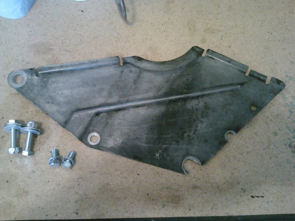

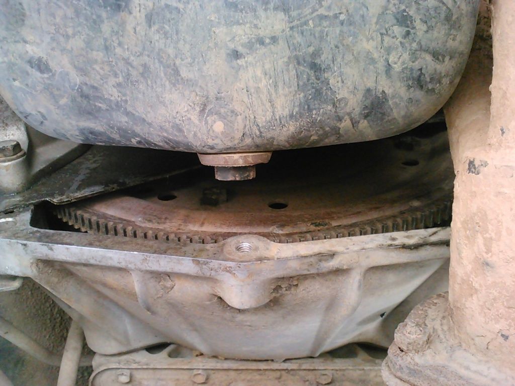

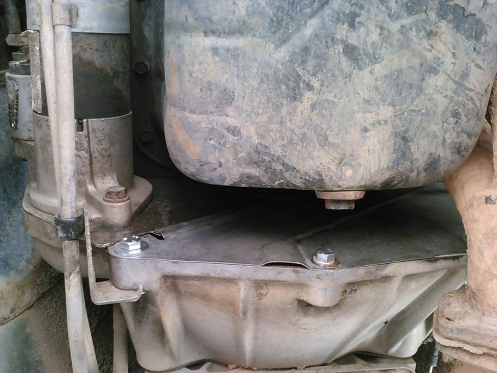

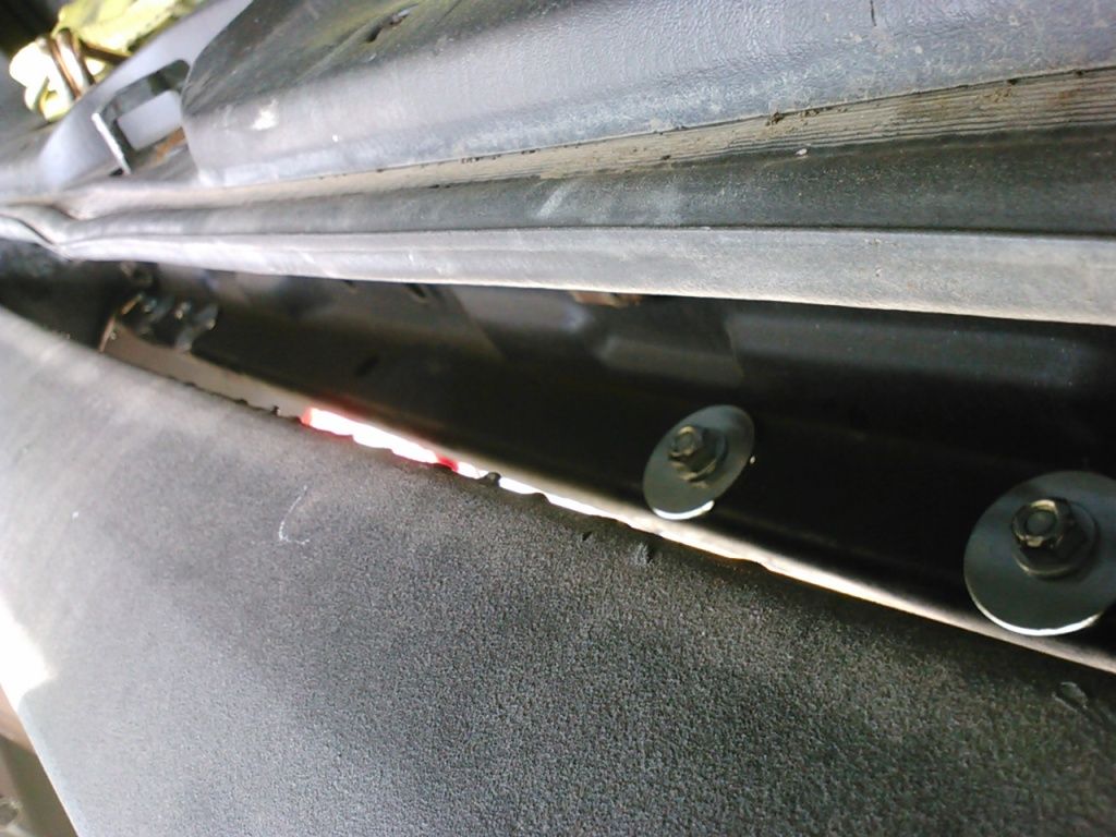

I still haven't resolved the floorboard rumble but I suspect this is what's causing it:
The belly pan really tucks up in there and you can see where the hanger broke off - I thought of welding it back but it wouldn't pull the exhaust off the skid anyway. I gave the exhaust tube some pretty good prying and whacks with a heavy soft mallet but I couldn't get it off the skid and I really don't wanna manipulate it with too much force because I don't wanna crack the exhaust.
I crawled under the Jeep and had my fingers on the tranny mount bolts while I hit the remote starter and I don't feel a rattle on the bolt/nuts. I don't necessarily feel it on the point of contact of exhaust/belly pan either though Guess I'll have to deal with it for now.
The other day I was helping a friend with a motor install on a CJ and he happened to have a bellhousing dust shield laying around which was perfect because mine was AWOL.
I picked up the hardware for it this morning. I searched all over the forums and www to track down the bolt size to no avail. So I went diggin through the garage and found a random bolt that fit the threads in the flange.
They are M8x1.25 for anybody needing to know and the length is pretty much to your choosing.
So I made this:
Look like this:
