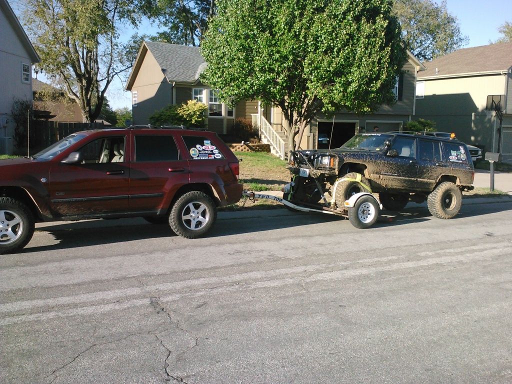

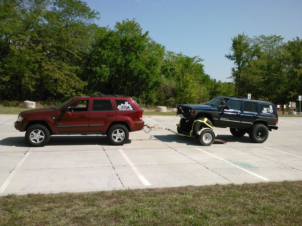

So - I got everything put together yesterday for wheelin on Saturday. Gave it a good test drive all over today. The WK pulls it just fine but I will say the drive to the ORV park will be slow and steady as the XJ wants to start swaying above 60mph. This could be the first and last time I bother with a dolly - idk - I'll see how it goes but I'm anticipating a long drive

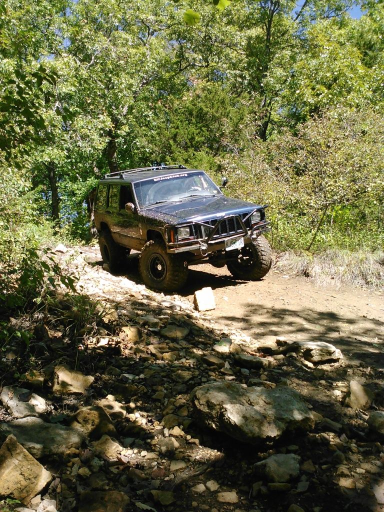

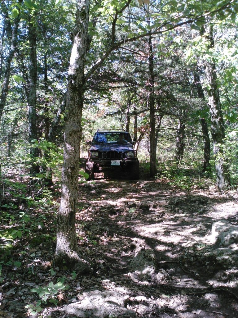

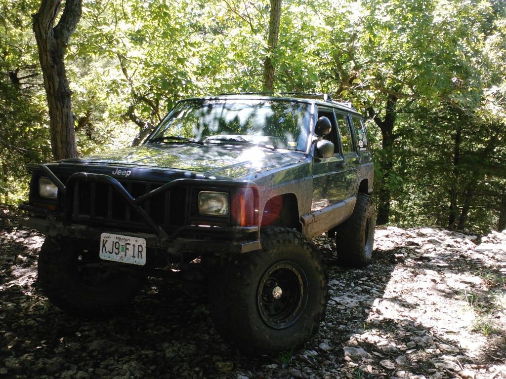

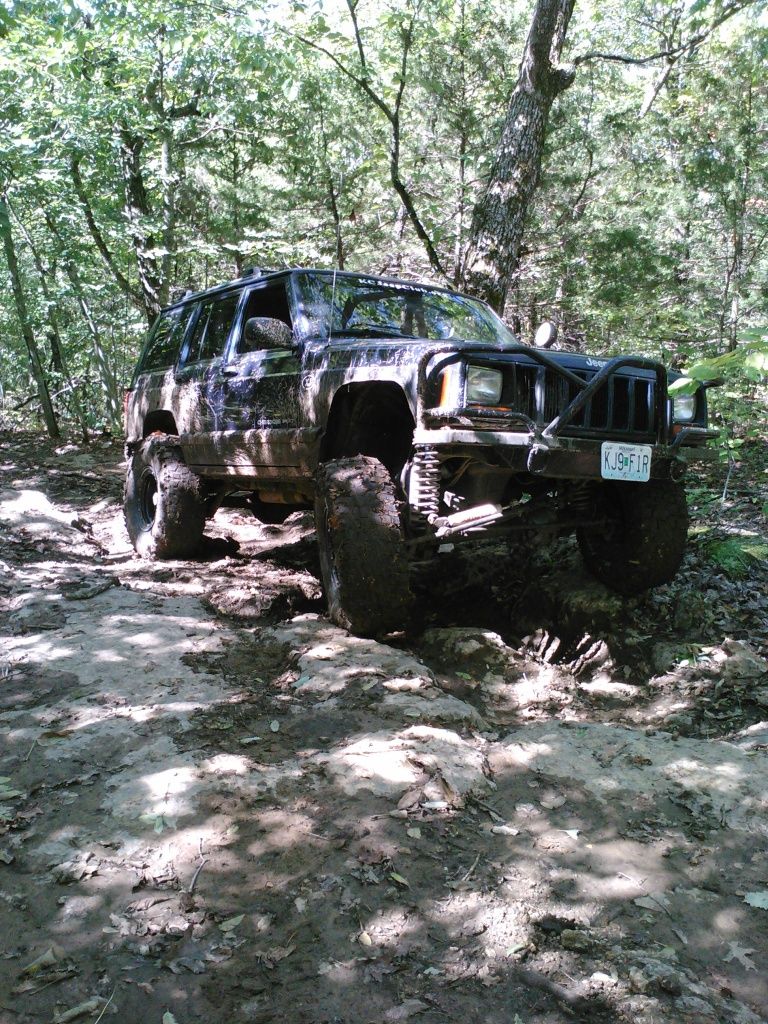

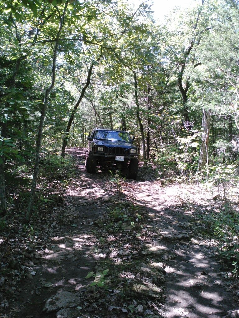

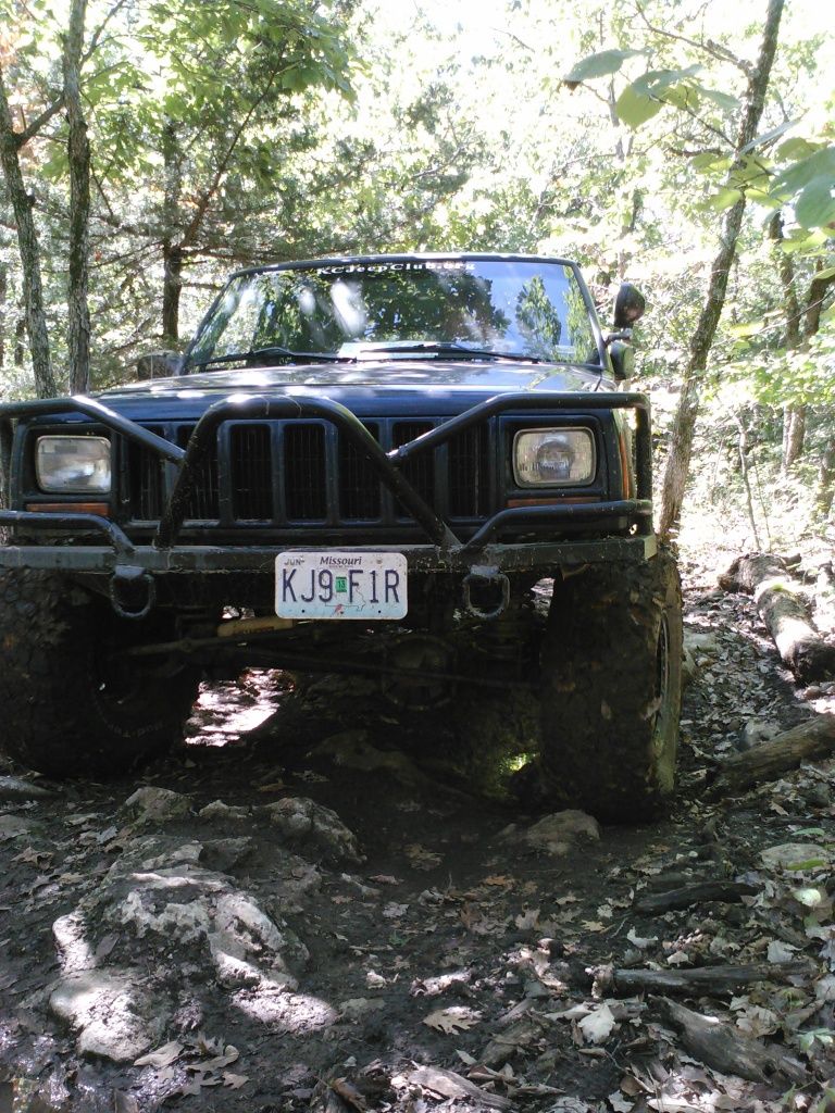

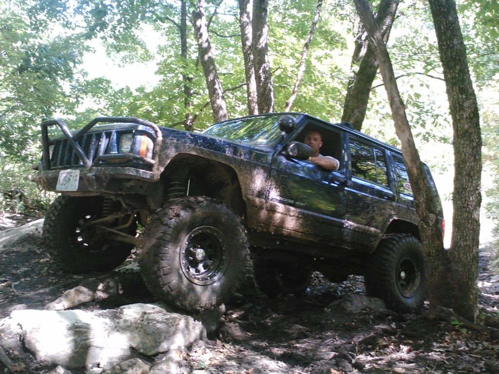

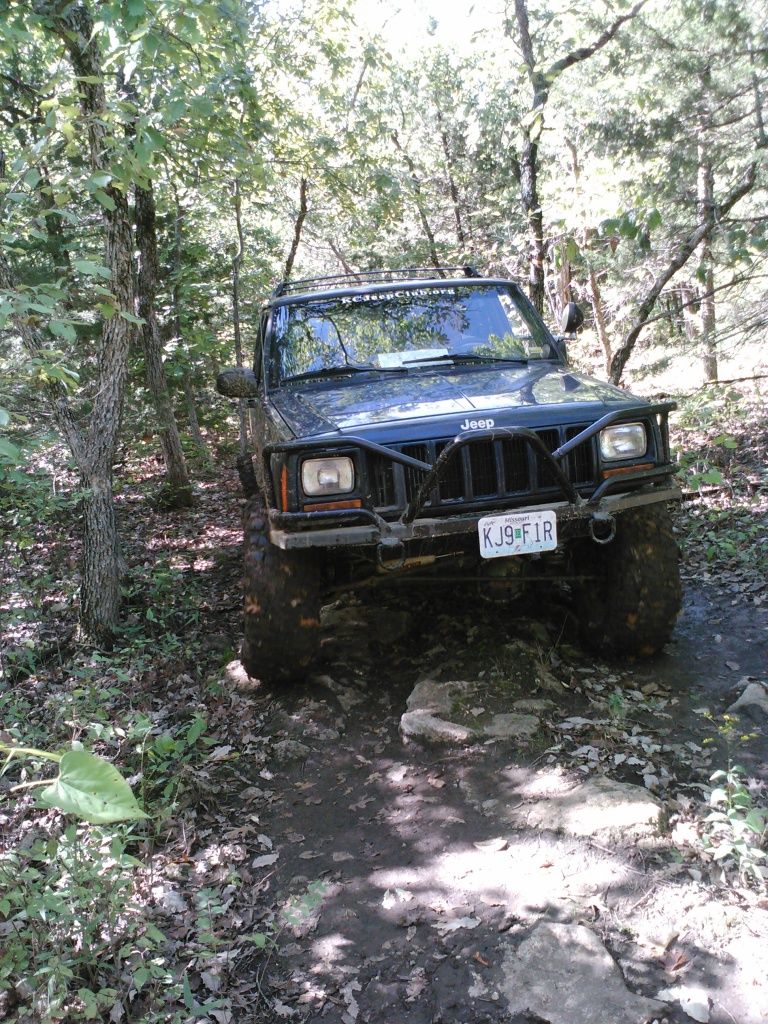

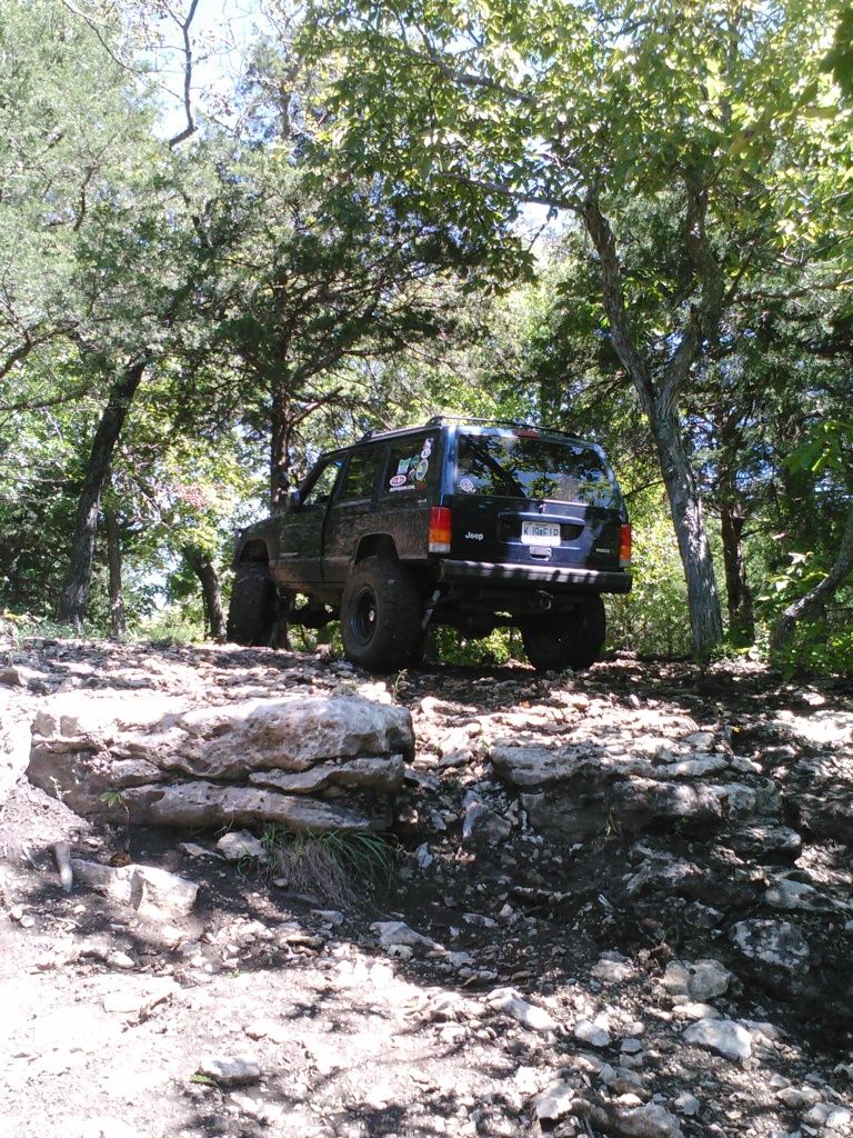

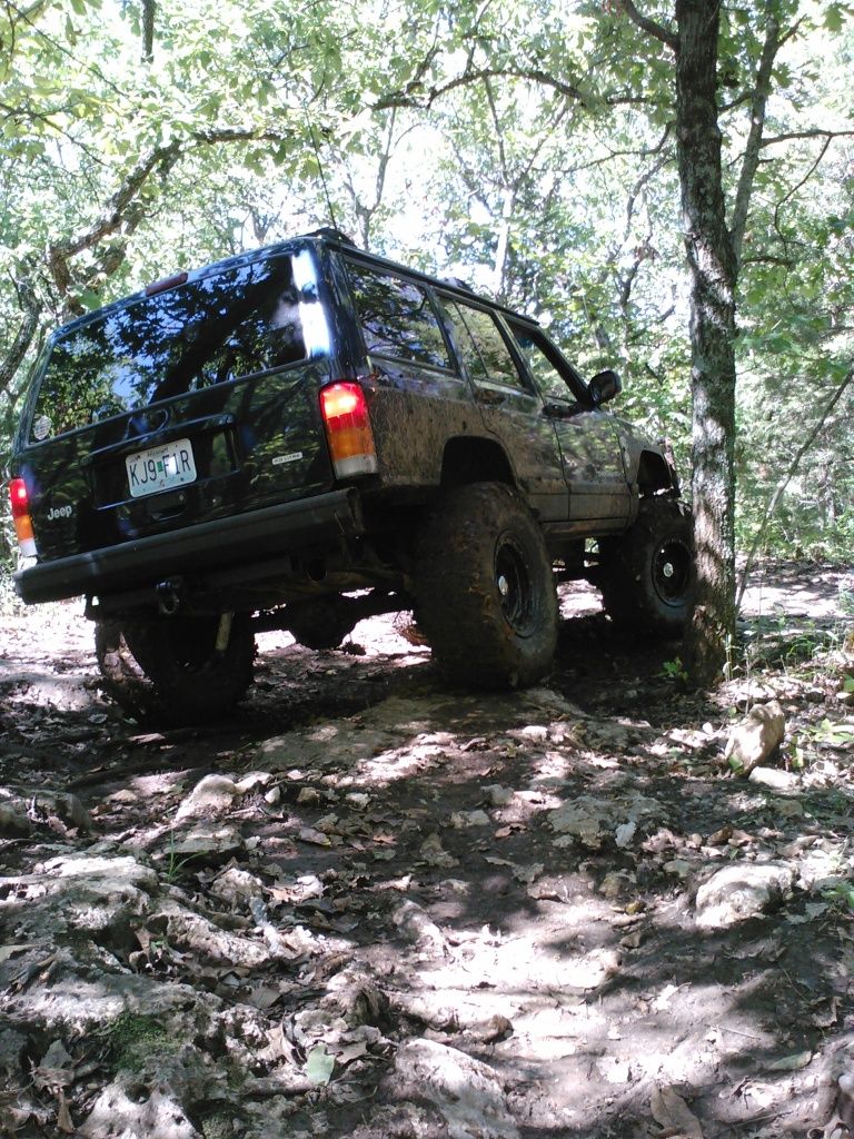

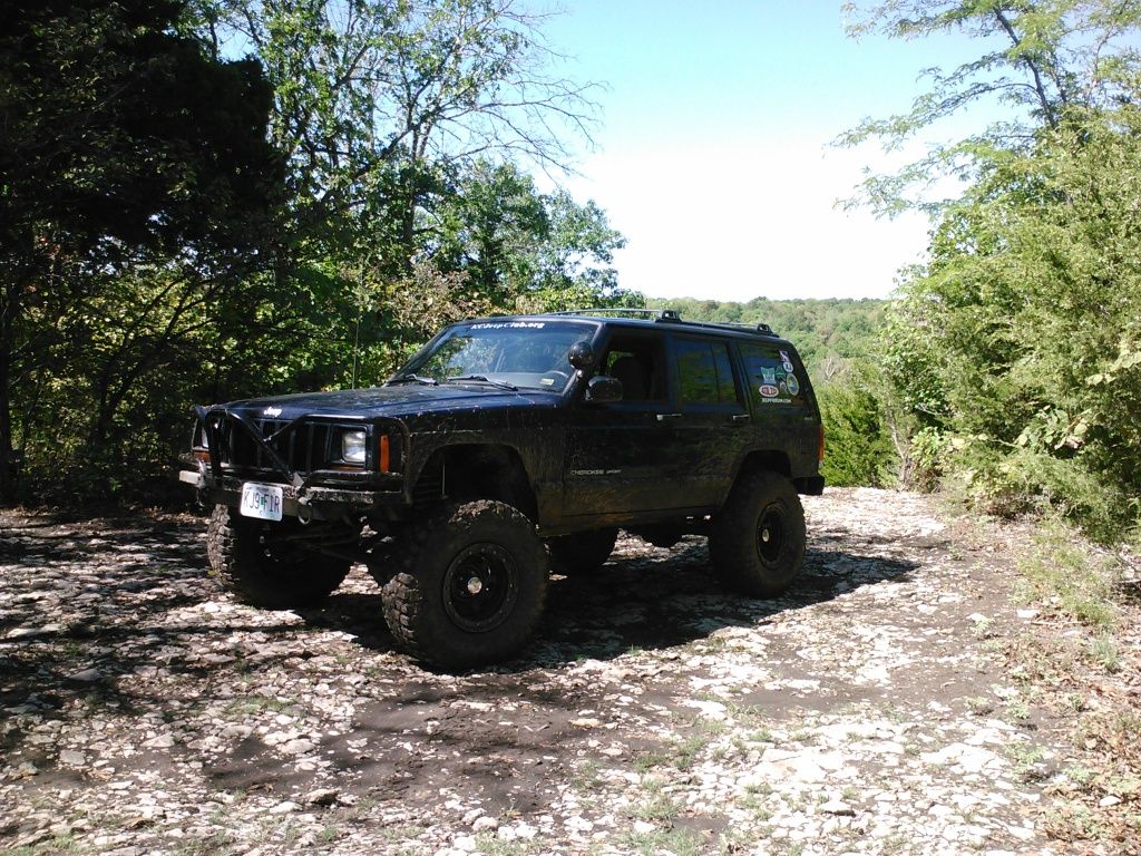

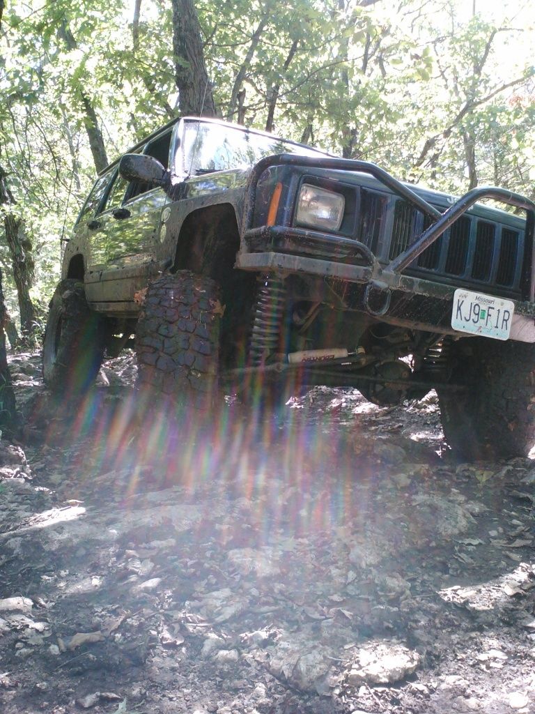

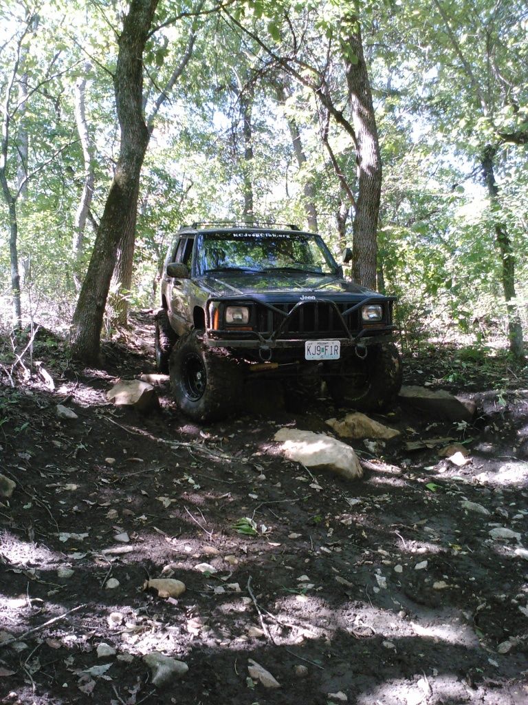

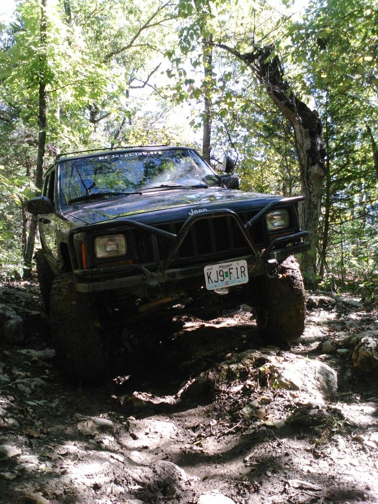

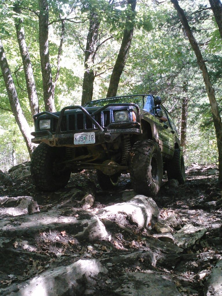

Finally got a chance to give this thing a go and, stretch it's legs, and put the locker to the test out on the trails! The WK did great pulling the XJ on the dolly - made some adjustments and moved all my gear/spares weight to the rear of the WK t ground the rear axle better. That dolly set-up has zero to negative tongue weight but I noticed with more air outta the front tires of the XJ it can cinch further forward on the dolly which also helped. Anyway, the drive was fine - averaged just under 65mph on the cruise and never swayed
KS Rocks was muddy so all the trail difficulties bumped up. The rig did great and a couple of the "blacks" we couldn't do were on climbs and the mud/rock combo didn't help - if it were dry the XJ would have been unstoppable.

Question on towing with the Dolly. I pulled the TJ with the commander on a full trailer the otehr weekend and it swayed terrible. For the trip to SMORR next week I rented a dolly in hopes it will be better. Do you have any advice on this?

Thanks Lee, and first off - I wanna thank you for the heads-up on SMORR this weekend but it just wasn't gonna workout. I'd like to try and get down there the first weekend in October.
As far as the dolly. Depending on the TJ's tire size you might have trouble finding net/basket straps big enough to fit the tires. I got lucky and found some adjustable 10K lb wheel straps at a local farm supply. If you can't find any you could probably just take ratchet straps around the circumference of the tire front to back. Regardless - I would advise backing that up with some sort of chain/axle strap/draw down buckle combo. I wish I'd taken pics of the actual XJ to dolly set-up but I didn't. Another thing I did was tie down the front bumper d-rings to the dolly and loaded the front suspension slightly to try and minimize bouncing and swaying.
I'd go ahead and air down the front tires to put on the dolly too because the less air in those the more forward on the dolly your TJ front axle will cinch. The other thing I did was put as much weight as I could over the rear axle of the WK in order to keep it "grounded." All this amounted to was throwing both rigs' spares and all recovery gear and cooler in the back of the folded down seats (it was just my brother and I so we only needed the front seats).
The reason I did this was the dolly set-up was putting either no tongue weight or slight upward/negative tongue weight on the WK - which can definately translate to swaying. Oh - and don't forget to throw a cheap set of magnetic trailer lights on the TJ.

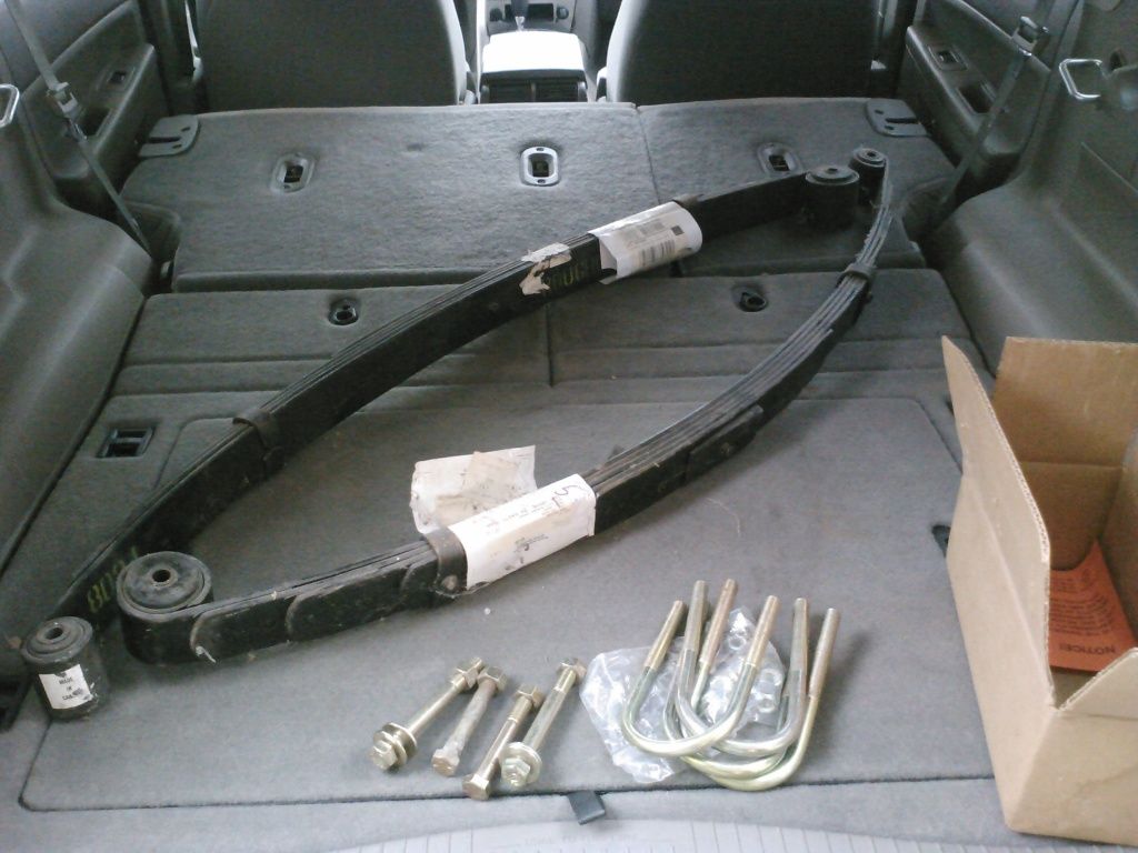

Picked up some goodies for the XJ today
Rough Country pn# 8024 full leaf packs (3-3.5" of lift depending what catalog ya look) New spring eye bolts (not sure I'll be able to use the ones for the front eye.) New u-bolts and hardware. Got 'em from a buddy that bought the springs for an XJ but never installed them. He's an old salty-dog Jeeper that used to run his own Jeep shop back in the day. He's got every tool known to man and parts galore.
Anyway, these new springs will hopefully set a nice rake to the Jeep and erase the sagging AALs. Really looking forward to this project as I've never tackled leaf springs before........

The beginning of the weekend I pulled the new springs out of the back seats of the XJ and decided to spruce them up.
They've never been installed but they've been sitting in a shop for a couple years collecting dust, a little surface rust, and spiderweb/eggs So I sanded them a bit, wiped 'em down, and shot 'em with some Rustoleum.
