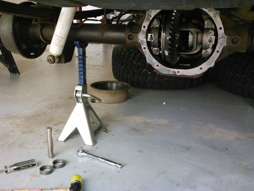

I got the Aussie installed today
Included a write-up in the tech section as well for future reference.

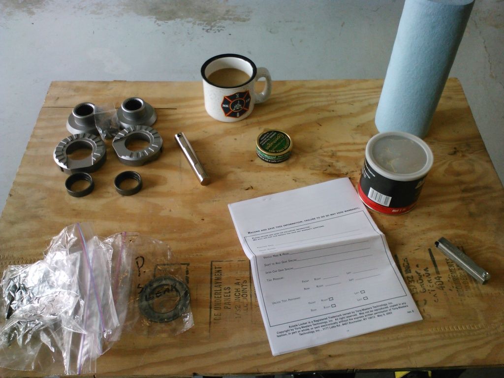

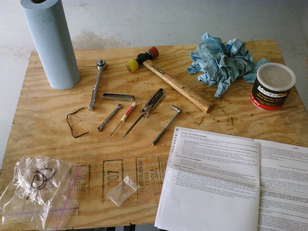

Start with all the supplies and tools:
Instruction manual

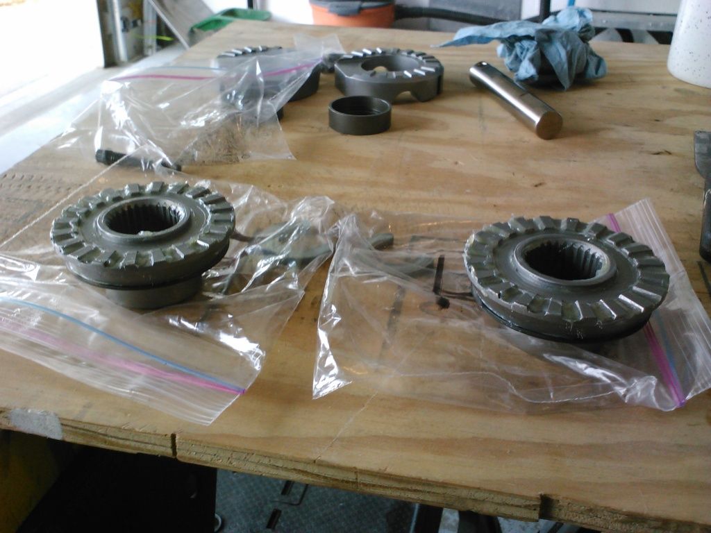

Aussie locker parts from box
Original side gear washers
Original c-clips
Carrier center pin (I picked up a new one since the original was fairly worn)
Feeler gauges
Shop towels
Coffee
Tobacco
Flat head screw drivers (small & large)
8mm open end box wrench and socket
More shop towels
Soft mallet
something to drive center pin in/out (I used a ratchet)

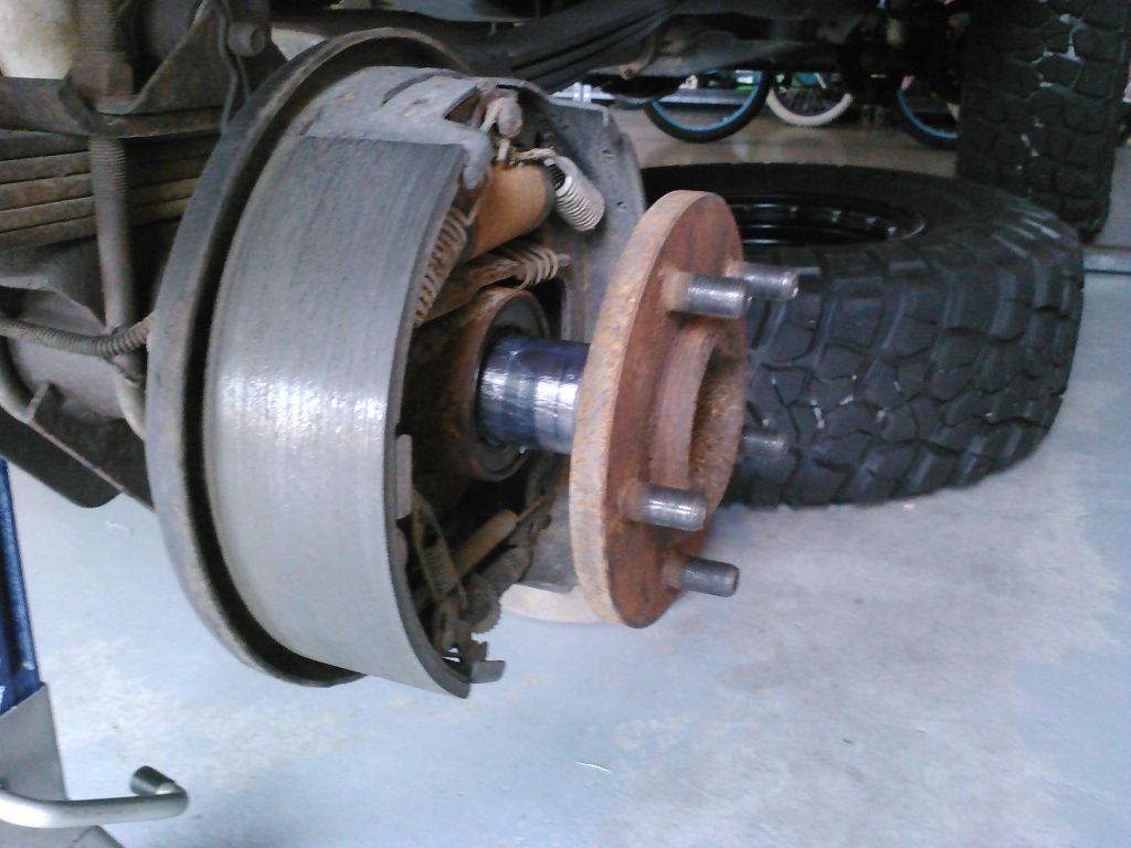

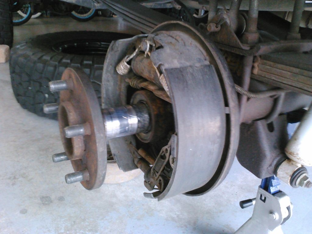

I had my axles all the way out for a bearing/seal redo so first thing I had to do was re-insert my axle shafts:
Next - grease the teeth of the axle gears and the back (or outboard side) and place the washers to the outboard side of the gears. The grease will hold the washers:
Then put the axle gears in the carrier and the spacers to the axle gears - again, grease is your friend as it acts like a glue to stick the parts together:

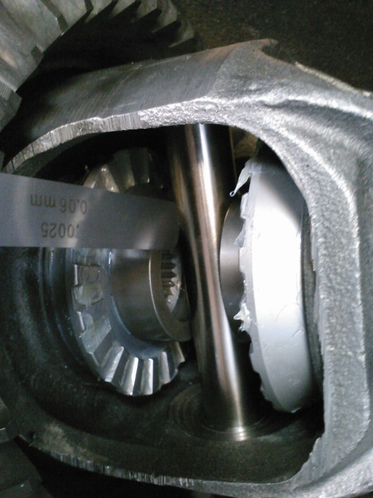

Insert the center pin and usea flathead screwdriver to push the spacers outward toward the axles. Then use feeler gauges to measure the clearance between the center pin ad the spacers:
Check the manual for the proper spacing. I realized the gauge used in this pic wasn't the right one to be checking with - so pay close attention to what the manual reads. Then - record your spacing on the back of the manual. This is critical because if a problem arises the warranty is void without proper spacing and documentation. My spacing was .008:
Once you get the spacing recorded pull the center pin back out and the spacers:

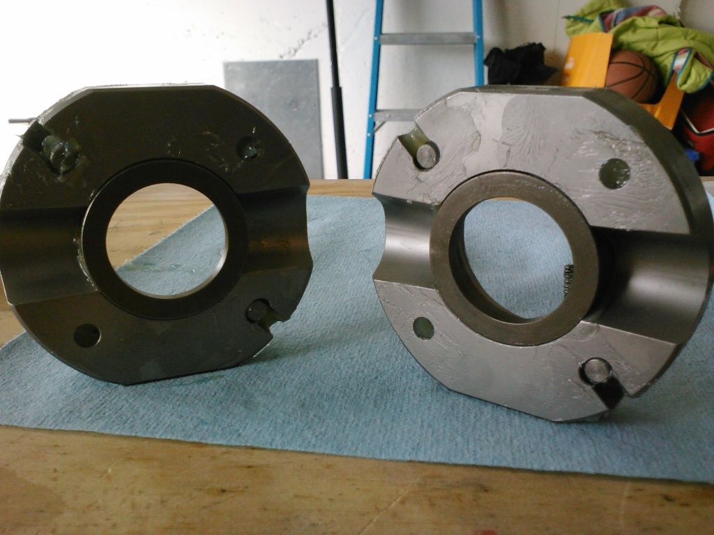

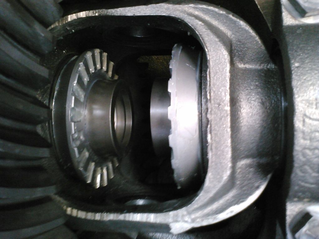

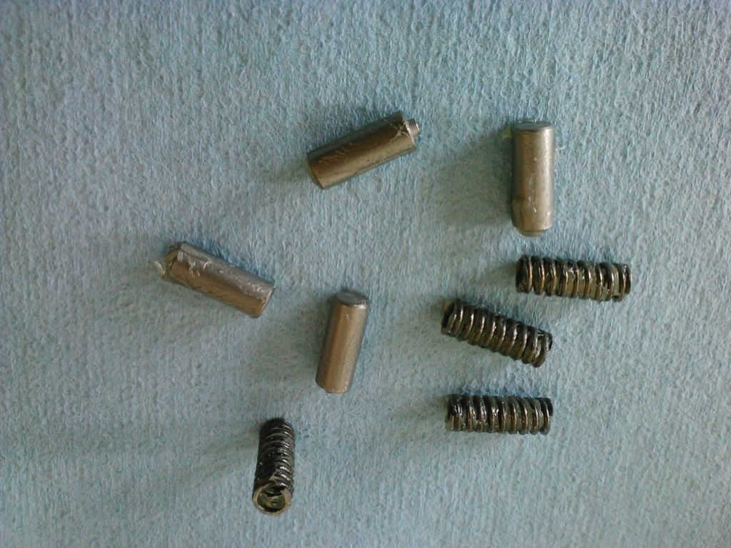

Next - grease the teeth of the cam gears, the inside diameter of the cam gears, the slots and holes for the pins and springs, the springs and pins themselves, and set the spacers in the cam gears oriented so they will "cap" over the axle ends. Also, set the pins in the slots with the "step" going into the slot first:
Next - push the driver side axle through the driver axle gear and set the c-clip:
Then press the driver cam gear against the axle gear and seat the spacer over the axle/c-clip:
Then push the passenger axle into the axle gear, set the cam gear against the driver cam gear and orient the "slot" to insert the passenger c-clip. With the c-clip in place push the passenger spacer to "cap" over the axle/c-clip. Then press the passenger cam gear against the passenger axle gear:
Orient the two cam gears so the center pin holes, and pin/spring slot/holes line up. Use a small flathead to slide the pins across the slots and into the holes. Then, set the springs in place with one end seating on the now exposed "step" and the other in the outboard side of the slots:
Once this is done measure the spacing between the two cam gears:
And again - check the manual for specs and record it. Mine was .165:

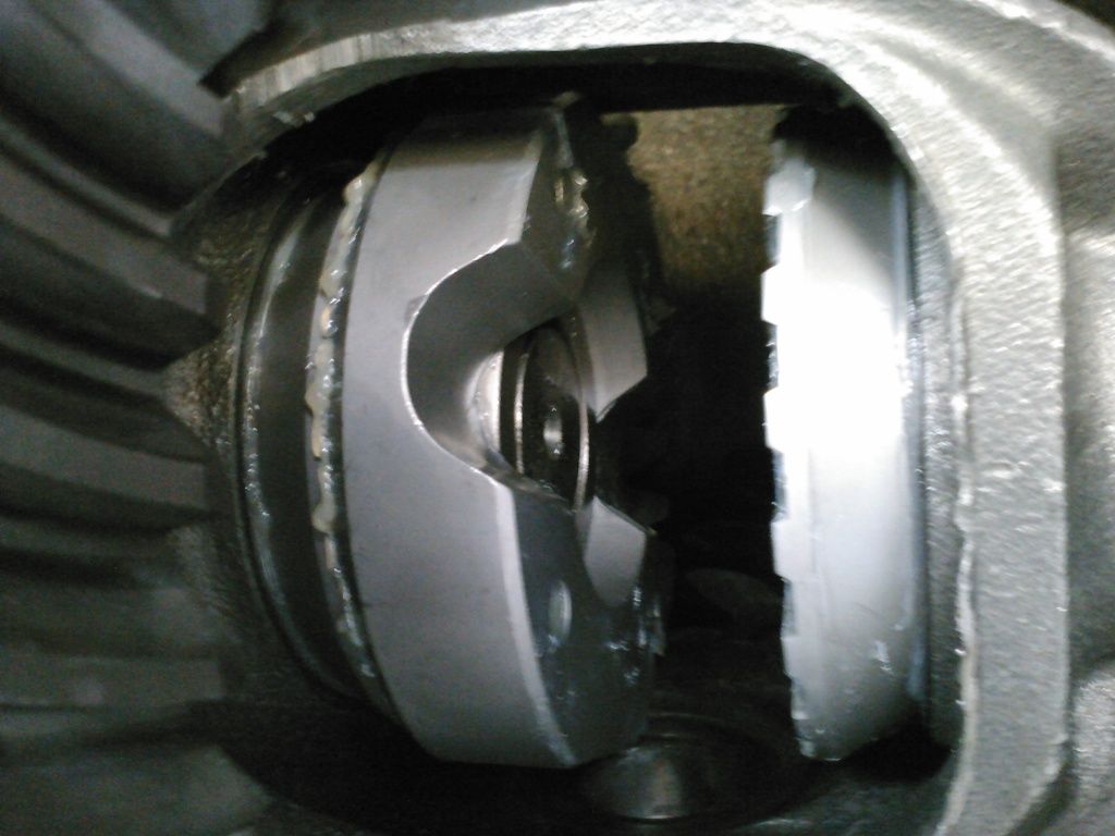

Re-insert the center pin and tighten the set bolt w/ 8mm box wrench.
It is now installed:

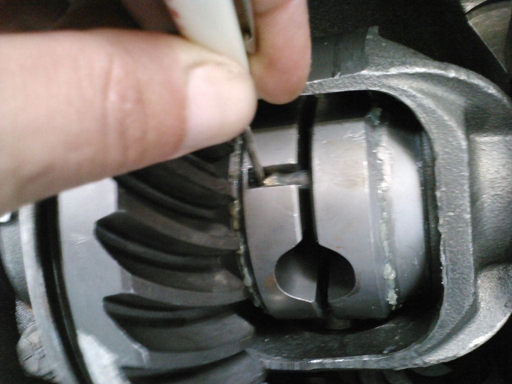

But not done. Now it's time for the "spin" test. The manual explains in detail how this is to be performed - but a trick I used to hold the one side in position was to chock the tire with the mallet while I spun the opposite tire. The cam gears should "click" and allow the tire to spin in the opposite direction of the chocked tire:
Don't forget to record this step was done:

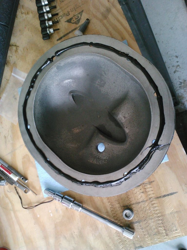

Once this is done it's time to button up the rear diff:
Once the diff cover is back on and fresh gear oil is put it the diff - take your new rear locked XJ out for a spin. It will be a clickety-clack SOB on turns but after a while you'll get used to how to drive with your new more capable XJ

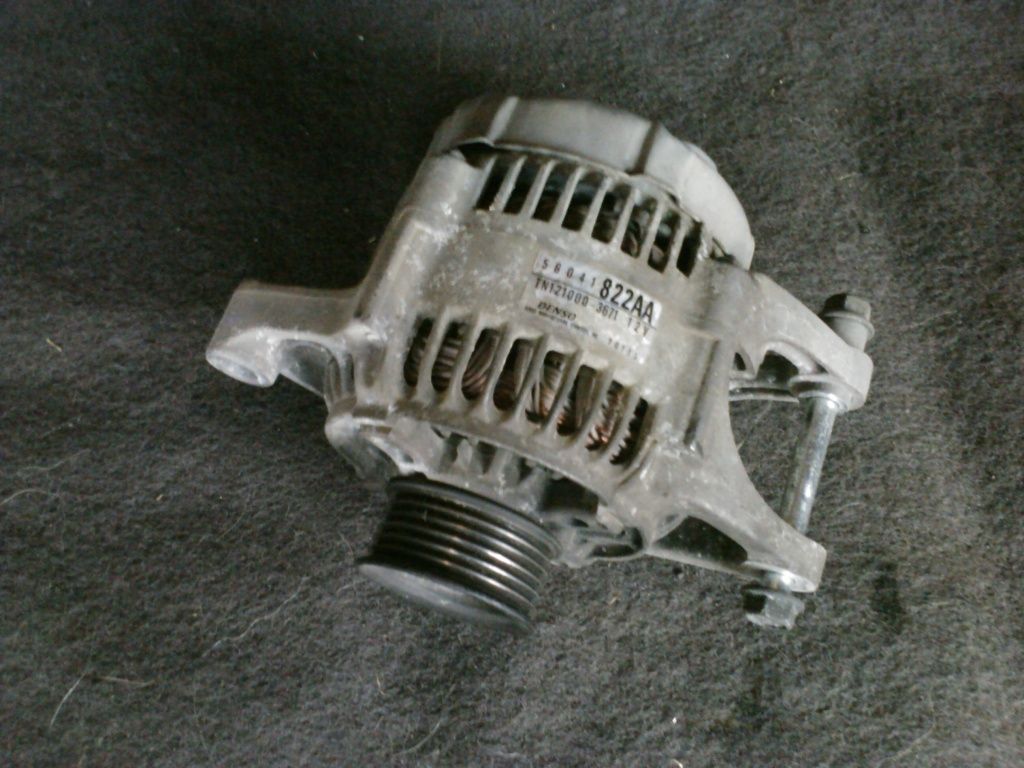

Took a quick drive in the XJ today to get an alternator. Paid $30 for it from a part-out Didn't even have to turn a wrench - seller unmounted it and handed it to me
Now I can swap that whiny one out with this and maybe look into getting the old rebuilt.

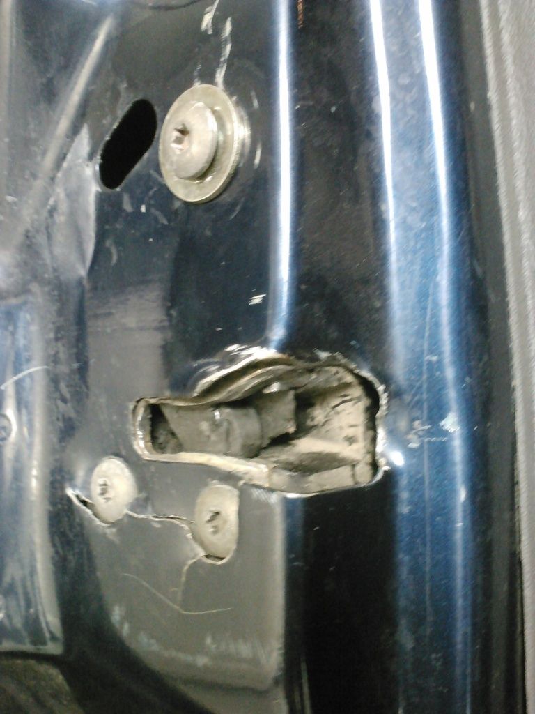

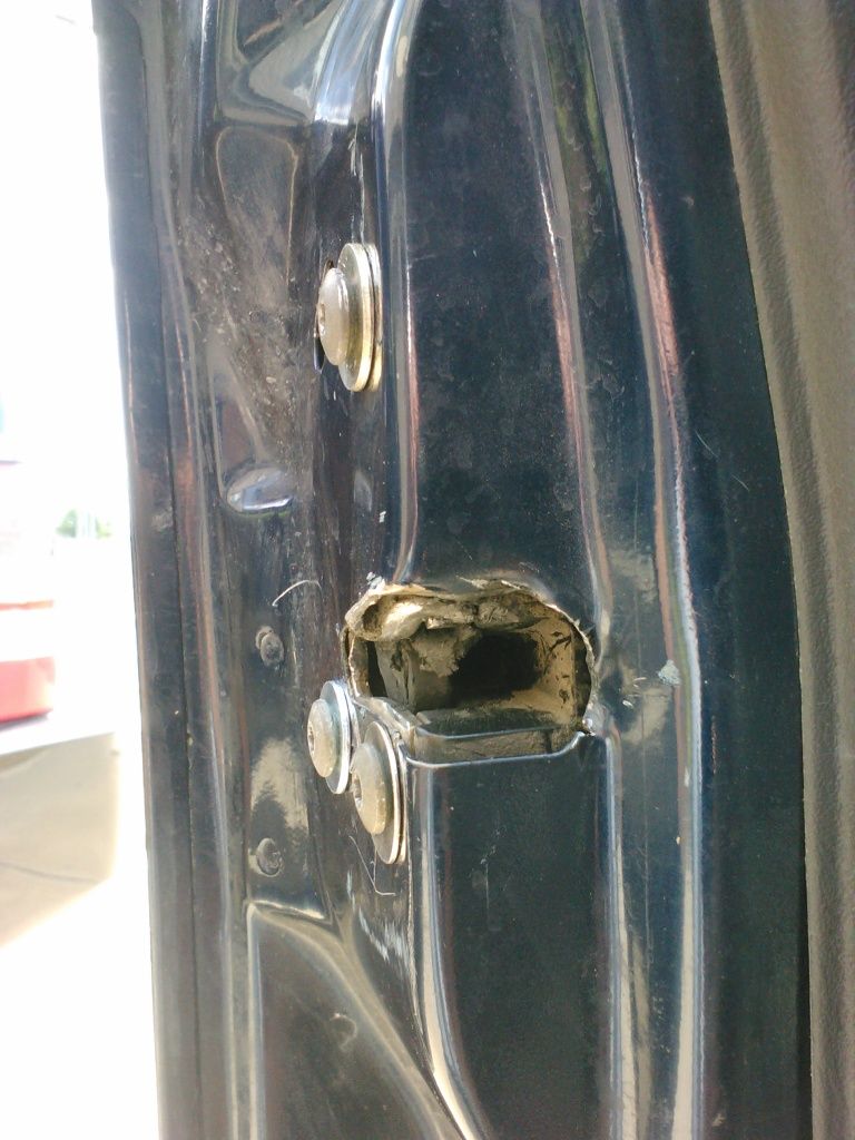

I have some play in the hinge pins of the driver door which obviously causes the door to move and misalign when it comes to closing. The other morning I got in it to drive to work since I wanted to give the WK a breather after driving out to CO last weekend. Well, I went to close the door and it just bounced open. I got to lookin and found the whole latch assembly is pretty chewed up and metal of the door that it mounts to is pretty torn up as well.
I put a washer in the upper bolt head and it cinched the assembly back down some:
I'll come up with something as I don't wanna have to swap the entire door if I don't have to. I think I'll try and get a thin piece of metal to span all the area I can, notch it for the striker opening, and hopefully it will be able to capture good door metal and spread the load more than washers. I'll keep my fingers crossed and post up whatever it is I come up with.

post #68 of 681 Old 08-18-2012, 02:58 PM
Joshharris98xj
Location: Pace
Posts: 2,178
Just did that in my buddies zj, weld around the bolts it's your best bet
Joshharris98xj is offline
I've said it before and I'll say it again - I really need to add welding to my skillset because it would be very useful for me to know.
I ended up just going the washer route for now:
Really cinched everything up - I'll just have to be more diligent lifting the door as I close it rather than just slamming it shut.
When I get more time I'll fab this piece of stainless to scab over the bulk of the bolt holes and assembly fascia and notch out the opening for the striker:

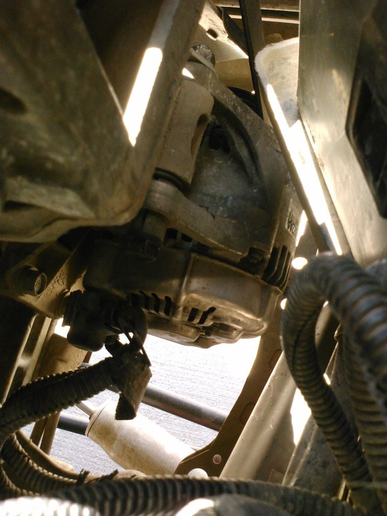

I finally got the alternators swapped out today. Look at how cracked and damaged the housing is on the old one:
And the new-to-me alternator nestled in place:
Badboy purrs like a kitten now (well with the exception of the Flowmaster exhaust). Anyway - no more whiney @$$ alternator noise from the engine compartment. Pretty sweet deal swapping it out for $30 and a quick morning's worth of wrenching. Oh.......and that old alt I took out, the pulley would barely turn so I got it outta there just in time.
