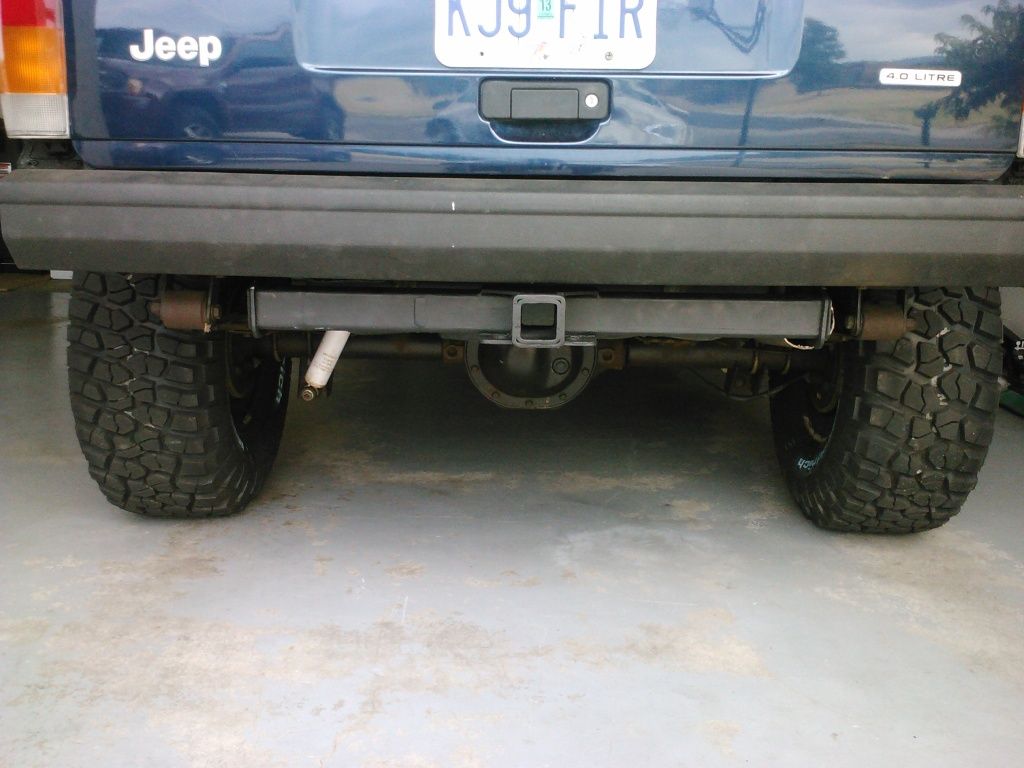

A short 10 minute drive and $30 put this in the back of the XJ:
Came out of a '00 XJ Sport. Let the window shopping/$ saving begin for an SYE kit .

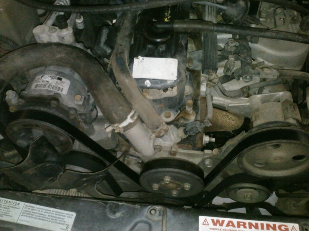

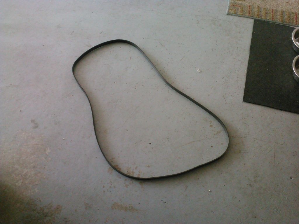

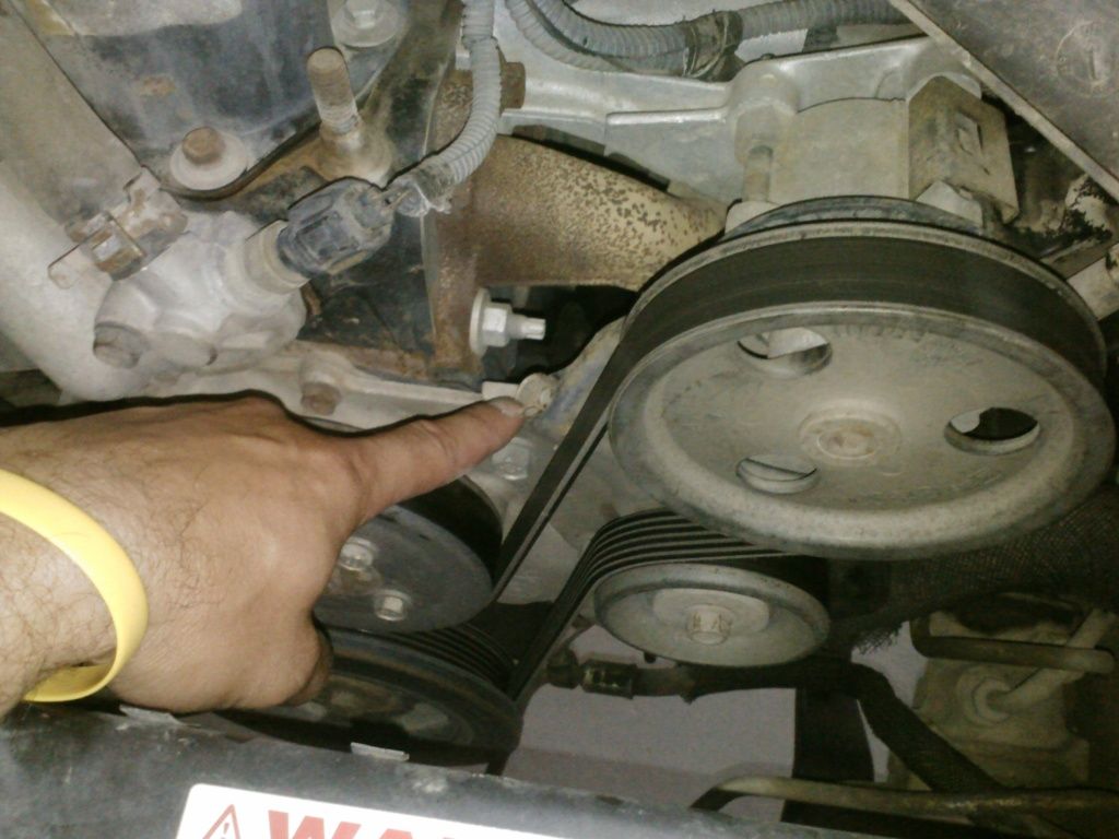

In the meatime I swapped out my serp belt. I have a whistle/whine from roundabout the alt. and had hoped a new belt would resolve it. I quick turn of the key w/ no belt rendered no noise so the sound is def. belt/pulley driven.
I disco'd the e-fan to clear the way for two 15mm bolts that loosen in order to remove the old belt:
Old belt off and put aside for spare:

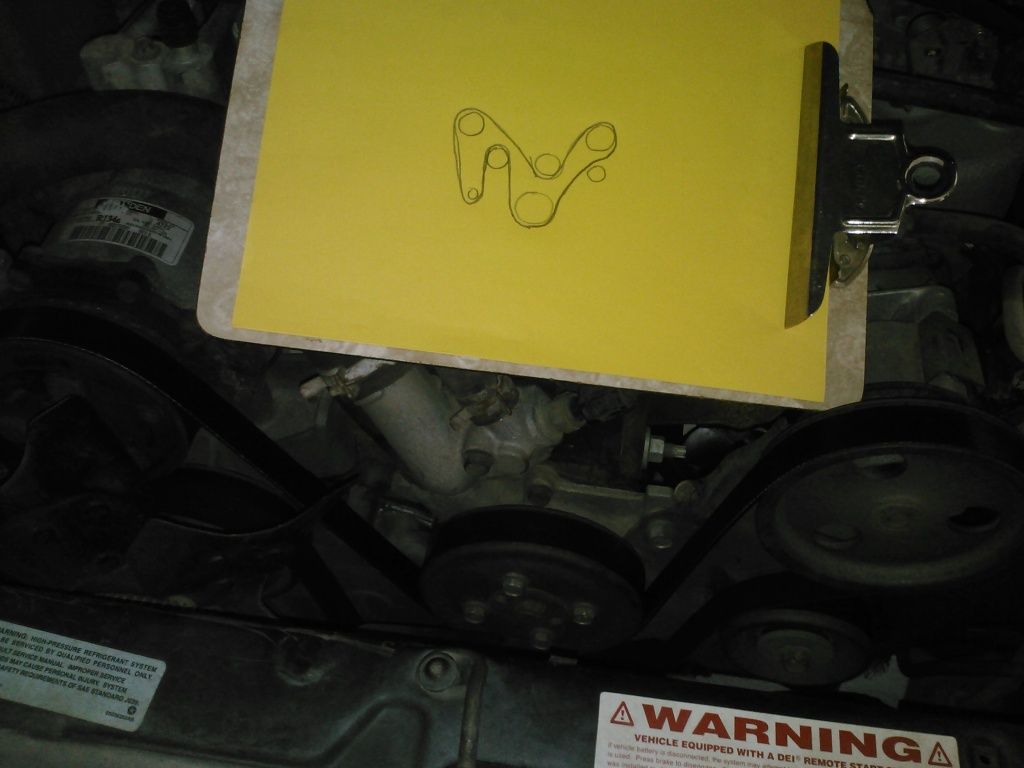

I don't have a diagram under the hood so I whipped up a reference drawing:
And wrapped the new belt on - and tightened it down:
Still have the noise but - I'll figure it out - prob the alternator bearings.

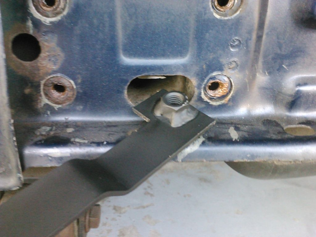

On to the next project - which proved to be a complete PITA!
Installing the hitch.
First thing I had to do was muscle wrench the old nutstrip out. Just 2 bolts on the tailpipe hanger - they did not want to come out:
But I made them - with the help of a 3' piece of square tubing as a breaker bar:
Primed and painted the nutstrips:

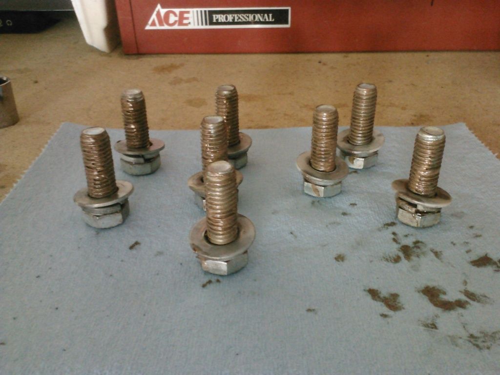

While that dried I prepped the mounting bolts w/ anti-sieze:
Then fit them in. This pic is the driver side for orientation (took me a little to figure this out):
I used my 7 year old daugher, my floor jack, a scrap piece of 2x4, and a lot of sweat and cuss words to get the hitch, nutstrips, unirail, fuel heat shield, tailpipe hanger, blah, blah, blah to line up and torque down. It sucked! Had to cut about half a foot off the exhaust tailpipe in order to fit with the hitch. But - I made it happen:
I have a Smittybilt 10K lb hitch shackle and locking hitch pin enroute from Amazon (gotta love Amazon). Should be in tomorrow via free shipping. So - rear recovery point is covered.

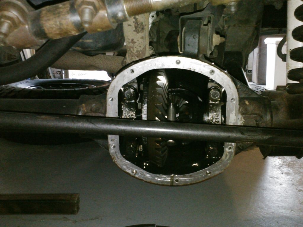

And so this morning is where things took a drastic turn.
I popped the rear diff cover to swap in fresh gear oil and give these welded spider gears a looksee. Not good.
That pic might not show it - but the welds are cracked:
Look upper-left/lower-right:
Lower-left/upper-right:
I started a thread over in the XJ tech sub-forum (along with NAXJA and my local Jeep club) did some searching on the www, and talked with a guy from one of the area 4x4 shops. Looks like I will likely start stacking the deck in the piggy bank for a true locker swap of the entire carrier. The R&P look good to go so I think I found this ticking time bomb before it went off.
Well - this build is definately in a holding pattern for now (and I haven't even wheeled it yet). I'll update when there's updating to be done. Feel free to comment, bash, admire, whatever...and until next time...................

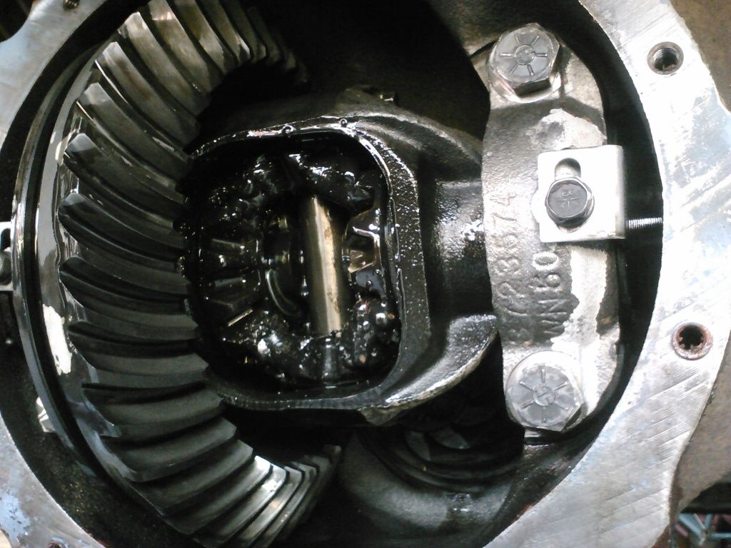

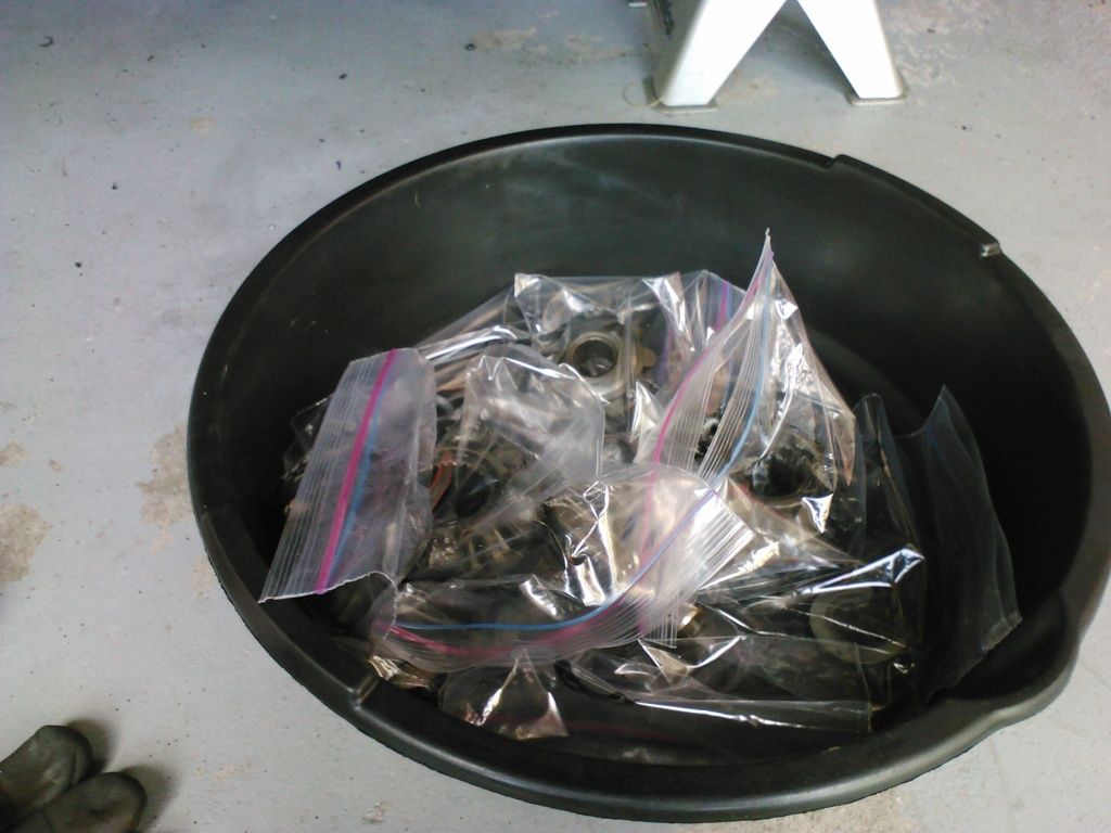

After spending some time yesterday on the world wide internets I came to the conclusion that something was worth a try:
I was able to bust up the welds enough to rotate all the internals out of the carrier
I put all the pieces in individual baggies with labels so I know where all the washers go if I need them:
So far as my research goes.......I should be able to pop a lunchbox locker into this open carrier:
Very excited about this as it changes everything I was thinking had to come next..........for the better.............

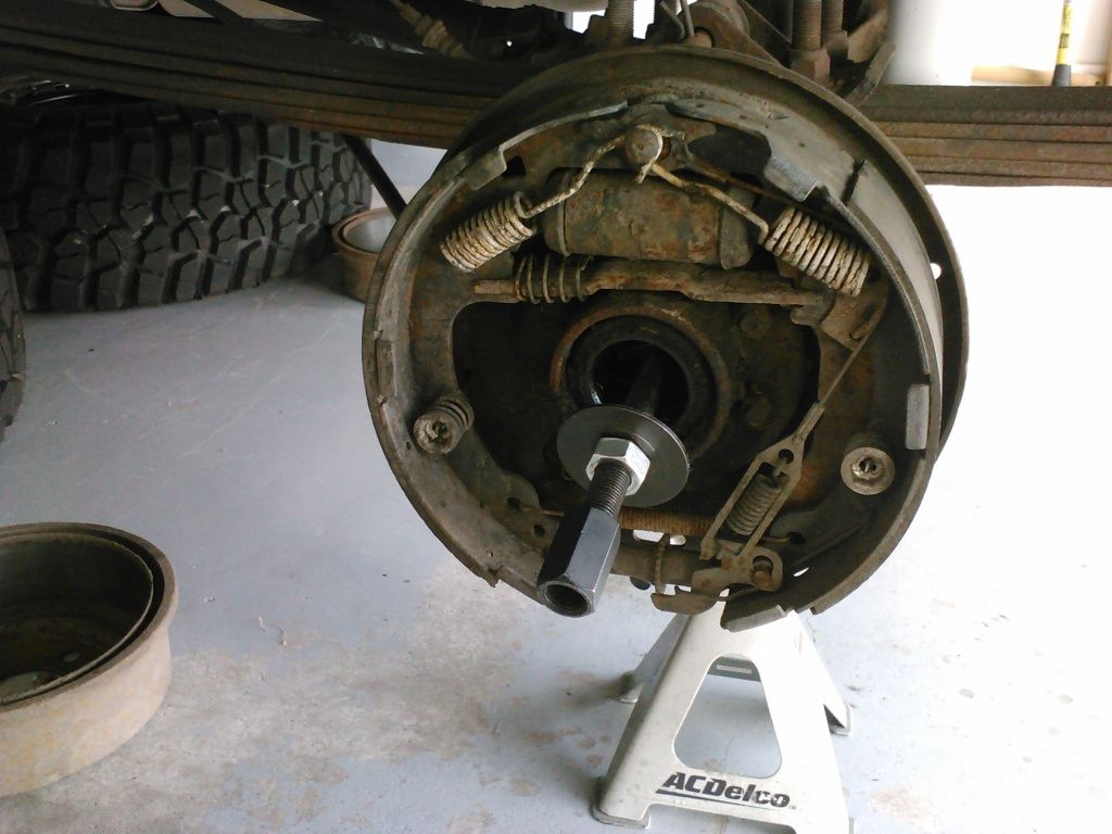

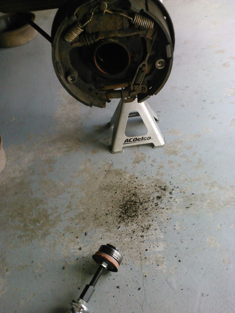

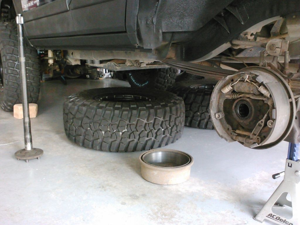

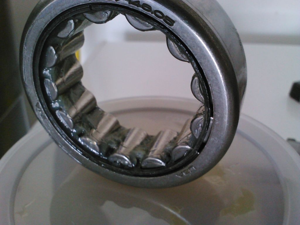

I'd given this some thought the other day and decided today I would go ahead and replace the old rear axle bearings and seals. They aren't necessarily showing signs of wear but they do have over 115K miles on them. Since the XJ is currently out of commission on jack stands with the differential torn down and axles pulled from the pumkin - I figured why not swap them now. Seems like the perfect time, since otherwise it being a c-clip axle means dropping the diff cover, draining the oil, removing crosspin, removing c-clips, pulling axle shafts ..........then having to put it all back together.
First I pulled the axles all the way out to expose the seals and access the bearings:
Then laid out my supplies and tools. A slide hammer with bearing puller attachment made this job EASY. I rented the tool from O'Reilly's and most any auto parts store has a tool rental program. The rental was by far the most expensive part but once you return it you get your credit back.
2 seals
2 bearings
Axle/bearing grease
If you're replacing the bearings and seals you don't need to pull the seals first with a ring seal pulluer/tool because they both come out together with the slide hammer attachment. Insert the bearing puller, attach the slide hammer, and have at it:
Be sure to wipe down the inside rim of the axle tube real well to clear away any debris, oil, or grease before reseating the new bearings and seals. If the inside lip of the axle tube is scratched up or marred you might consider some rtv around the sides of the seals or directly to the inside lip of the tube.
I packed the bearings with some grease so they are prelubed before I get around to refilling the diff/axle with oil:
Carefully tap the new bearings in - they will come to a "seat" so don't worry about pushing them too far into the axle tube. I used the head of a rubber mallet that fit into the tube opening and the blunt end of a punch to set against the bearing and hit those to push the bearing in place. You can use just about anything that won't damage or marr the bearing case. Getting the seal in to cap over the bearing was more of a challenge for me. I used the old seal and bearing to hit against in order to seat the seal.
And there ya have it - new bearings and seals await the reinstall of my axle shafts. This took maybe 30-40 minutes on the conservative side and cost me about 30 bucks for the bearings, seals, and grease. I might put a thin smear of rtv on the outter edge of the seal/tube interface for good measure but I'll probably wait untill all this rear axle is up and running to see if it's even needed.

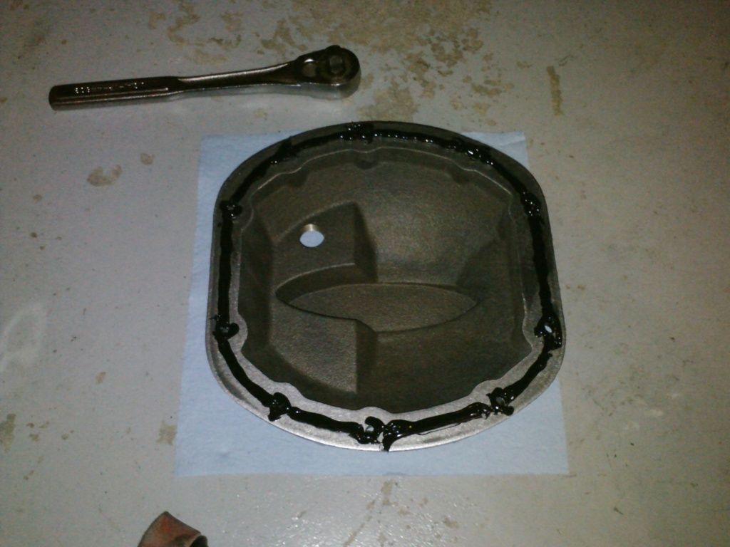

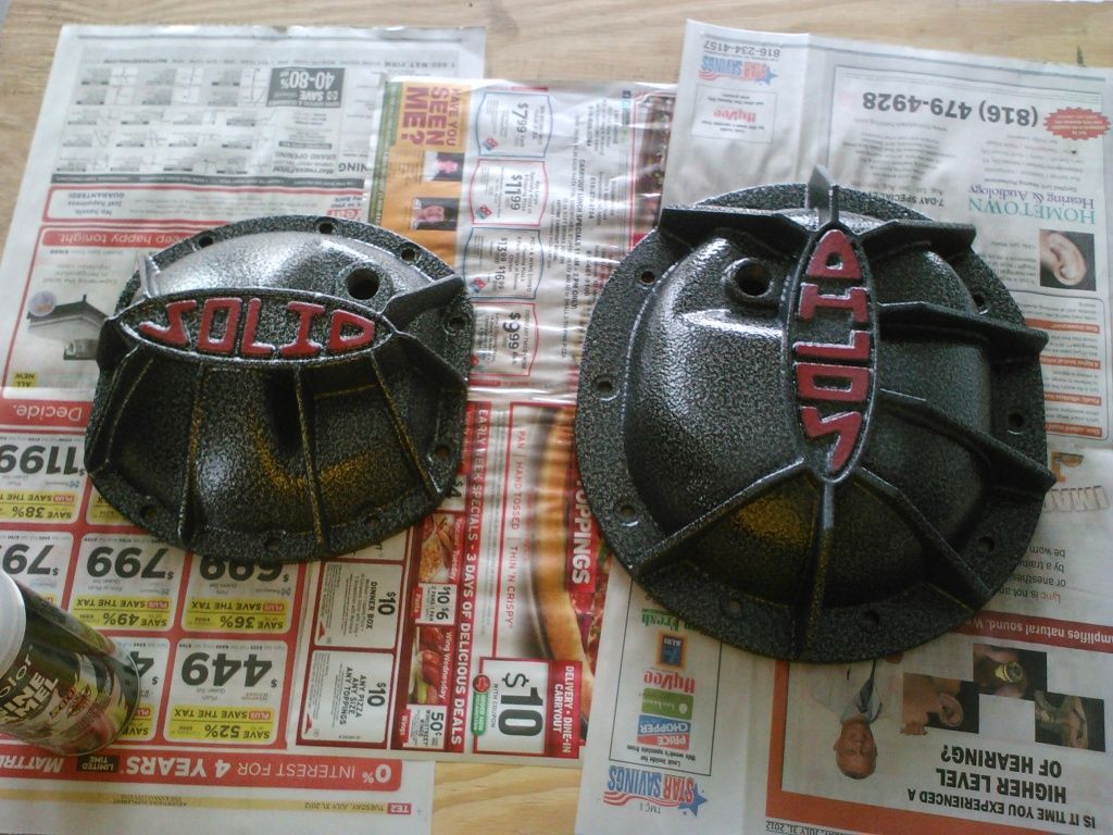

First part of the day I laid out the diff covers and added a little touch. Did this to the WK diff cover and liked it - so why not repeat. Just some Rustoleum touch-up and then a few coats of clear. I'd heard tell of premature rust on these Solid diff covers back when I did the WK so figured some added protection couldn't hurt:

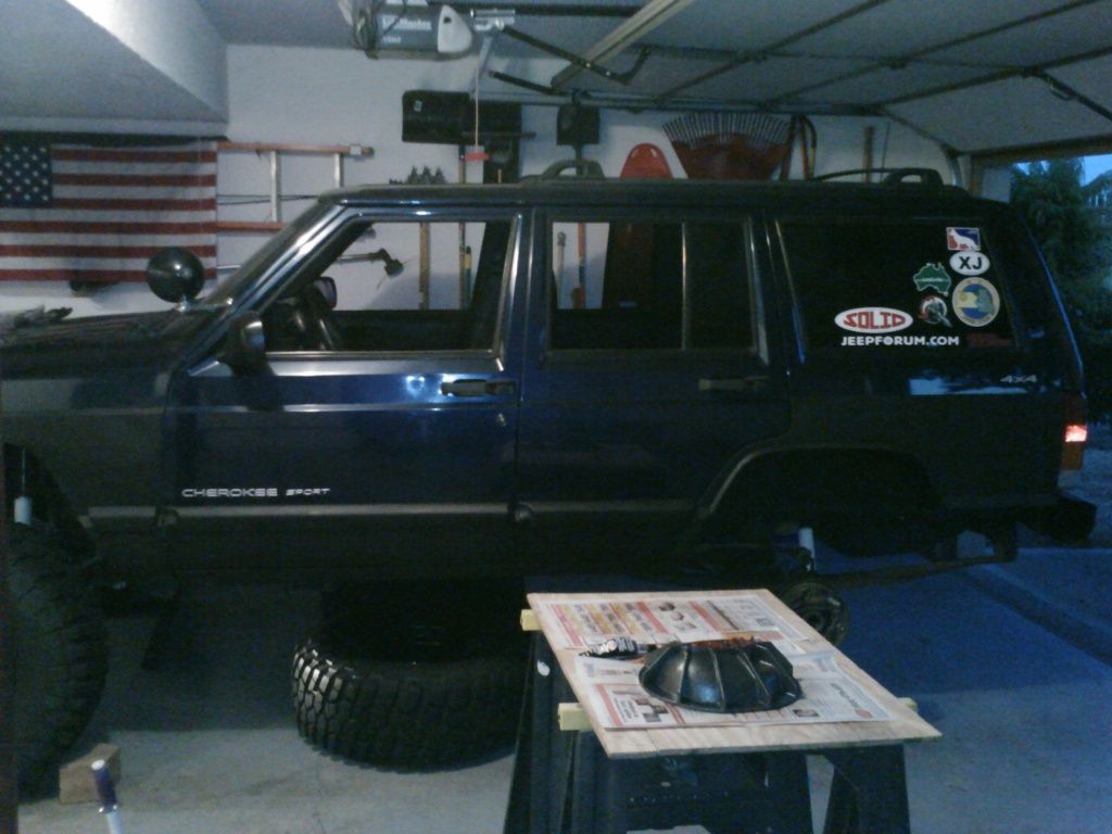

It was later towards evening when I got back to the Jeep so I popped the fronf diff cover, drained it, hit it good with brake cleaner. This gave me look at the front internals, ring, and pinion gears - everything looks good to go. I also see why a lunchbox in the D30 requires pulling the carrier - the center pin won't clear the ring gear:
Let it dry and squeezed a bead of rtv on the cover:
Let that skin over a couple minutes then lightly bolted the cover on:
Let it sit about 20 minutes while I straightened up the garage and put stuff up then came back and torqued it down in a star pattern to 30ft/lbs:
Now - anybody that knows me or my WK build knows I dig the stickers
So, while I was straightening up I added some character to the XJ:
That was good for the day. Tomorrow comes the real adventure as the plan is to install the Aussie in the rear 8.25

Did you buy it welded? I just welded the **** out of mine, but I have about 1.5 pounds of wire in mine. I wilded everywhere I could including the gears to the carrier. I don't want it going anywhere!
ibjeepin95 is offline
post #59 of 648 Old 08-02-2012, 09:55 PM Thread Starter
JeepN4KC
Keep on Jeepin on........
JeepN4KC's Avatar
Location: Blue Springs
Posts: 7,217
Yep - I don't know much about welding - but I'd say the PO, or whoever welded it, did a $h!t job. That's okay though 'cause I was able to get the cracked welded iternals out of the carrier for the Aussie
