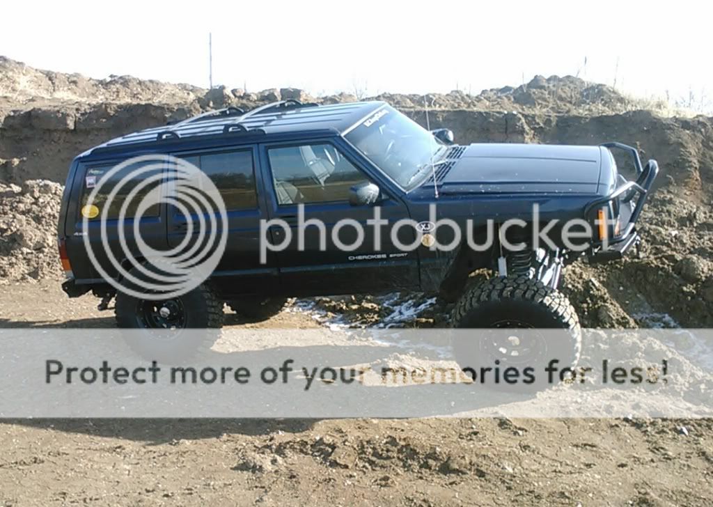

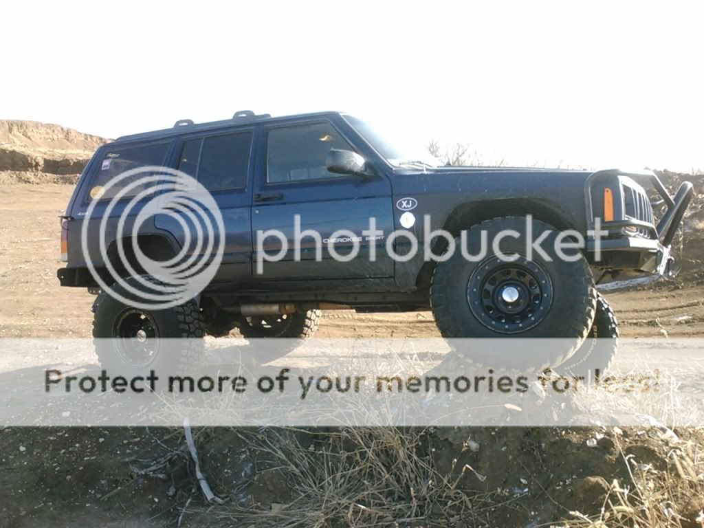

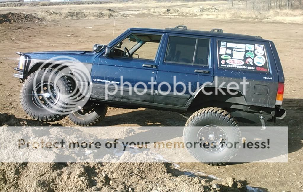

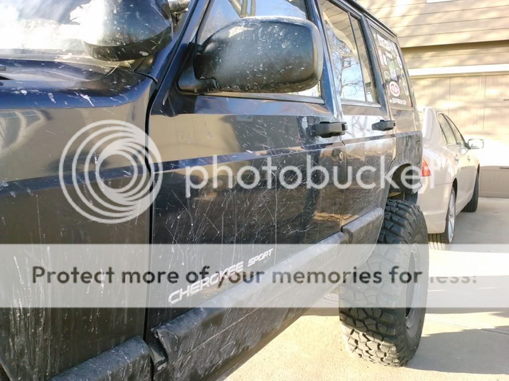

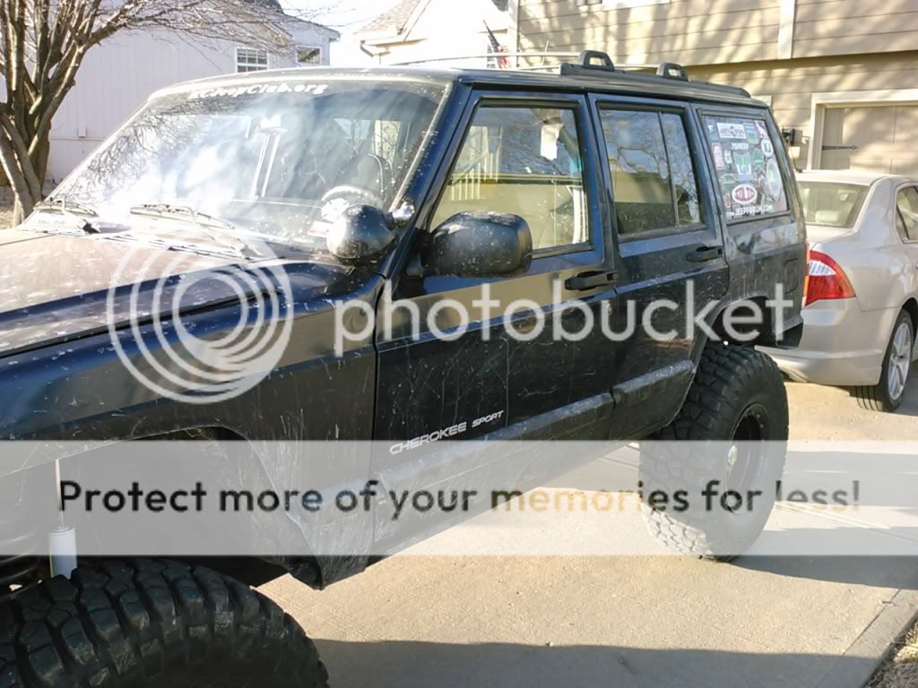

Temps have been well above freezing last few days and so the last winter storm we got was melting and generally making a mess. The XJ has been sitting clean in the garage since getting the relos and seats installed. Today everything is back to frozen, weather wise, so I took the blue Jeep out for a quick flex and some poser pics.
Quite pleased with the travel in the rear suspension - I didn't even get it in full flex/droop but the down travel is definitely there with ease. I see longer shocks and brake lines in the future............

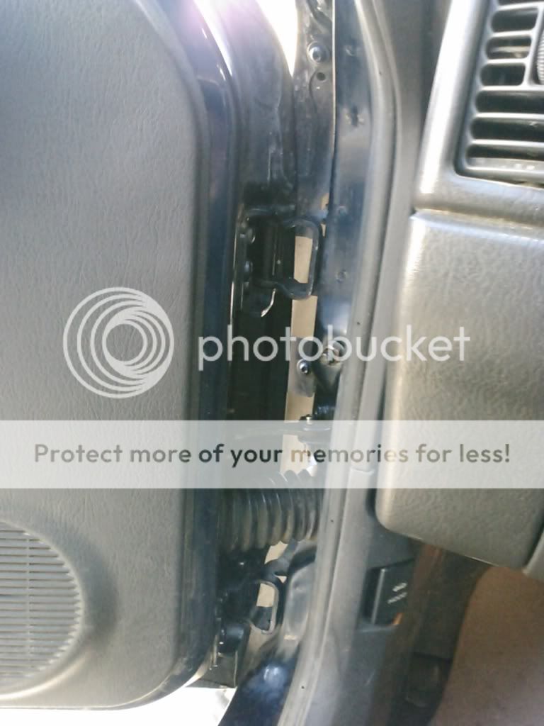

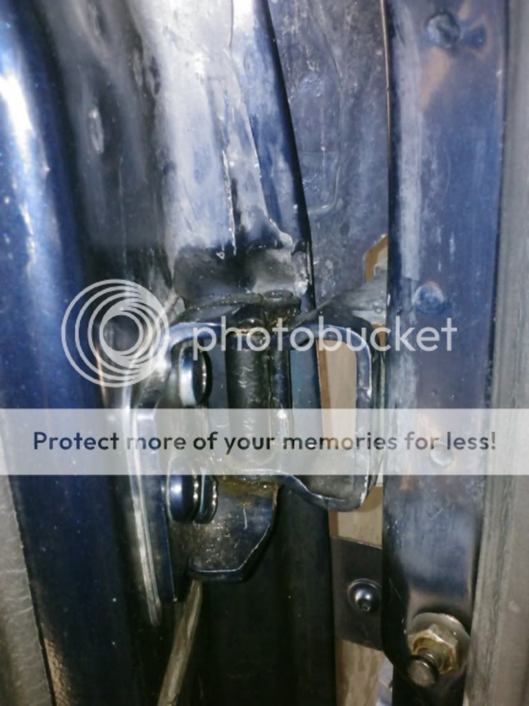

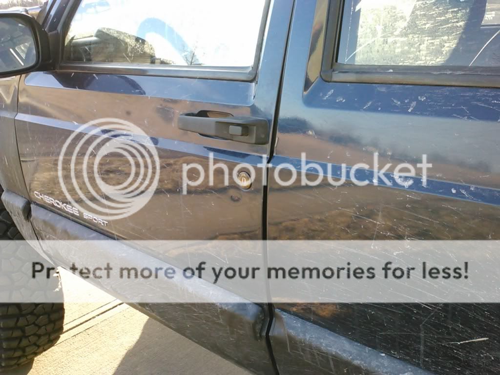

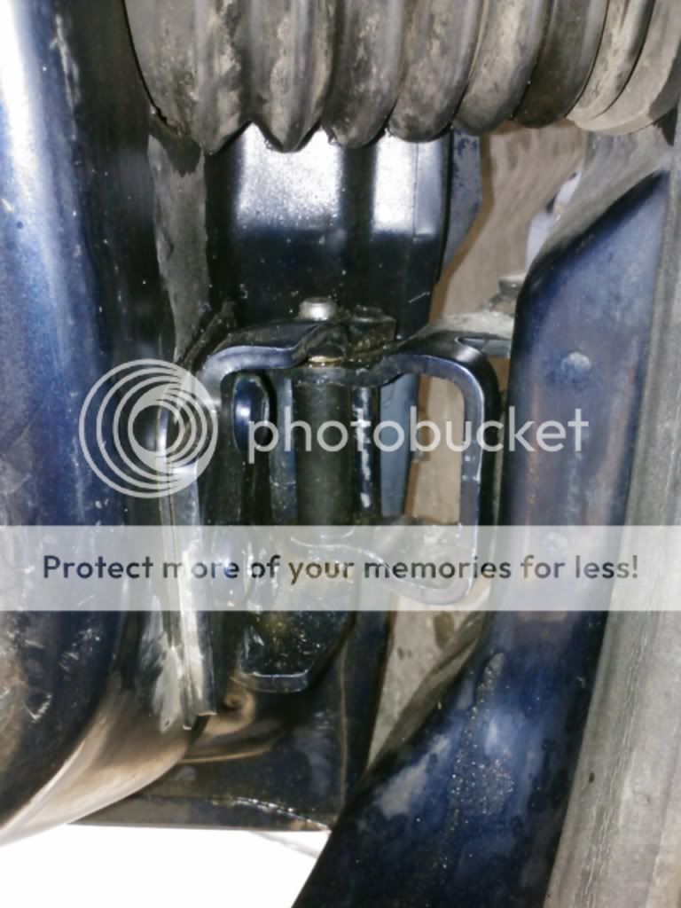

Finally took the time to work on my sagging driver's door. I picked up a couple sets of Dorman #38439 hinge pin and bushings and swapped them in. The old bushings were completely disintegrated - all of them.
This little project proved to be a PITA for what it is - I'd recommend a second set of hands for this. Dremel with little cut-off wheel works just fine to cut the pins then a big flathead and a hammer to wedge into the cut and the old pins pop out pretty easy. Getting everything back together is the fun part if doing this solo. The replacement pins have to have the serration ground off at the heads and in the end the reassembles hinges don't fit as tight as I'd hoped. May have gotten wallered out some over time after time of opening and closing with shot bushings. But it is what it is and at least I have new pins with fresh bushings and everything lubed with bearing grease.
I realize I passed on an opportunity to set this door up to go doorless, especially considering it is essentially the same steps involved. However, I'm not sure I'm sold on that modification as my tires sling some stuff when I wheel it and the doors make a good barrier between the outside of the Jeep and the inside of the Jeep. Maybe if I had flares but I probably never will...........
Besides, the new pins have snap rings that make it easy enough to remove the new pins and I could always come back to the doorless idea.
I also adjusted the striker at the b-post so the door now opens and closes smoothly w/o the need to pull up on it.
I'm not happy with the alignment but whatta ya gonna do?
Good from afar:
....but far from good:

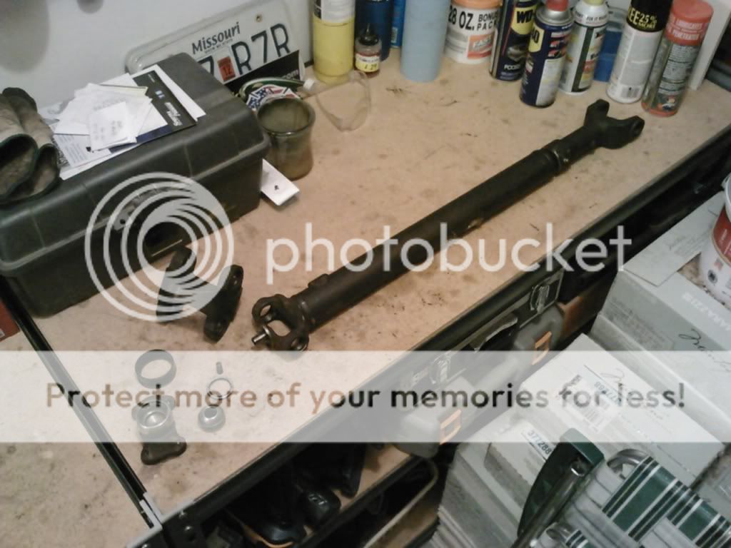

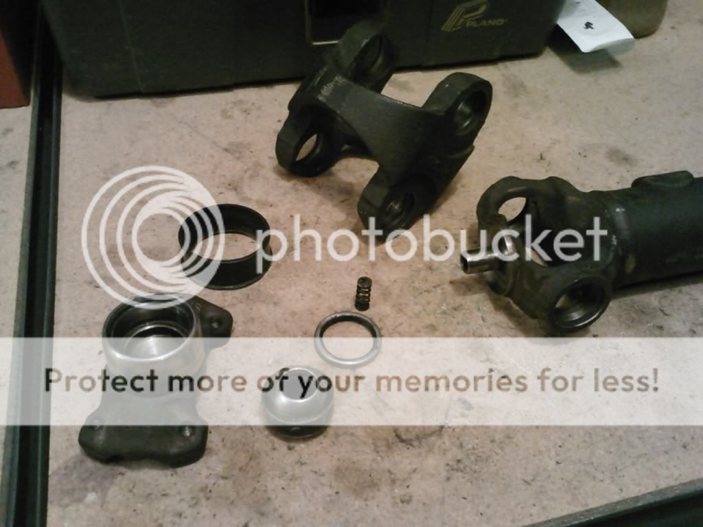

Haven't done anything to or wheeled the XJ in quite a while. Everytime I plan on something for the past couple months the weather decides to ruin it.
I did take the spare front shaft I had in the garage and broke it all down - ujoints, centering socket, ball, spring, yoke etc.
I was planning to rebuild it but I'm running into some confusion as to the parts list. Specifically the centering yoke, socket, ball, spring (double cardan parts).
Any body have some solid part numbers for the double cardan rebuild on an '01 front shaft? I'm looking at Spicer 211544X but just that yoke is like 50 bucks. I also can't get a solid line on the rubber boot/dust cover.
Ideas anyone?

Well this is what I have:
I might have to look up the MOOG part. Getting the race outta the socket wasn't bad - snapped a tip of a screwdriver but I got it out with little to no damage to the parts. Only reason I even bothered was because I dropped the yoke and 3 of the needle bearings fell into the hole between the back of the ball and the yoke. I thought of just regreasing it reusing it but I still would prefer new stuff.
Thanks for the info!
