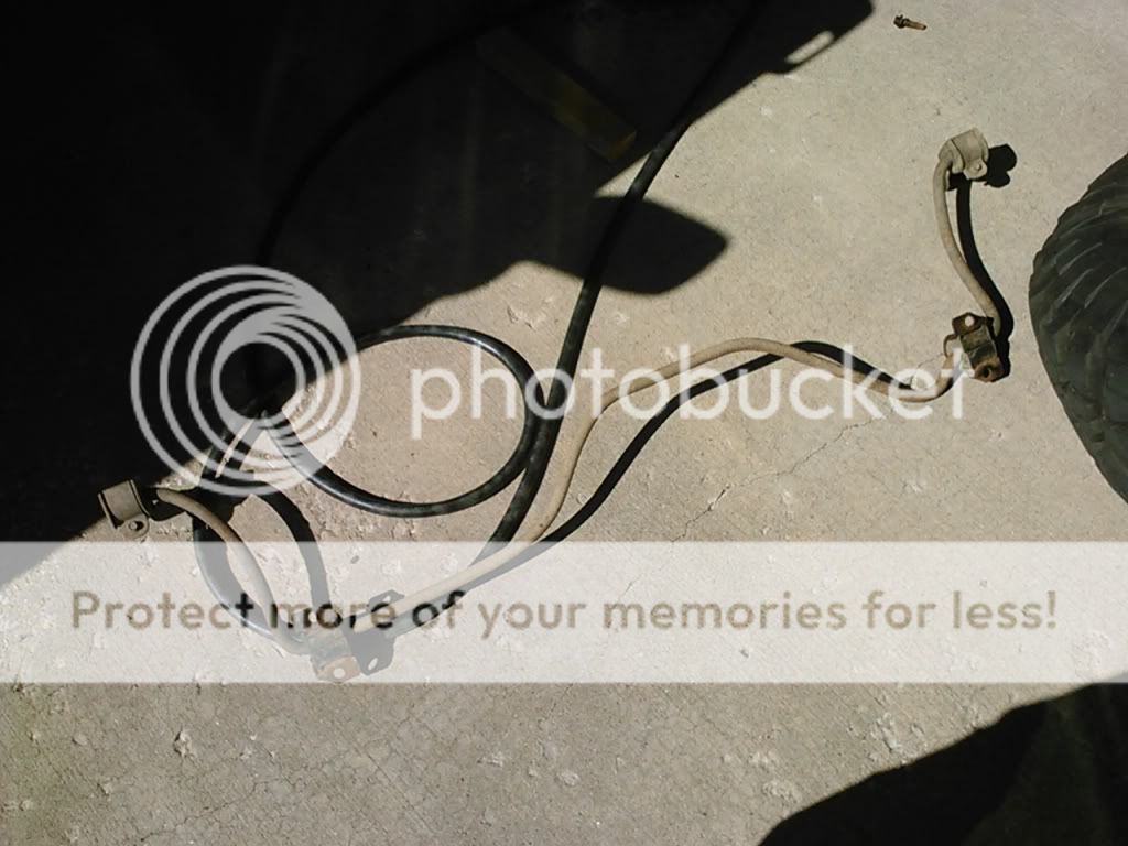

Got some general maintenance done yesterday/today and while rotating the tires I finally got around to pulling the rear sway bar:
Didn't feel like finding a place to flex it but I'm sure it'll make at least a little difference in the rear flex.
This thing is swayless now............. Oh my GOD!!.........
