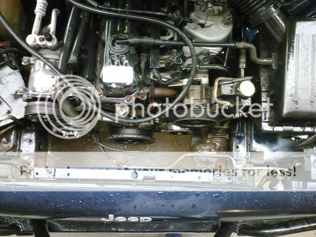

Today I got a jump start on revamping the cooling system by getting all the old stuff outta the way:
Not too bad. Worst part IMO was scraping all the old gasket material off the t-stat housing and the spots on the block where that and the water pump goes. Snapped a couple bolts on the driver side of the top mounting "bracket" for the radiator. Figure I'll use a couple self tappers in lieu of them.

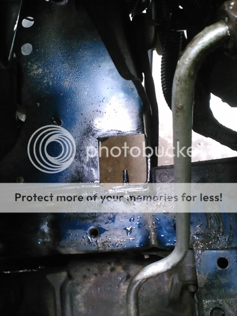

I also notched out some metal to give more clearance for the elbow on the tranny cooler line that comes out the bottom driver side of the radiator:

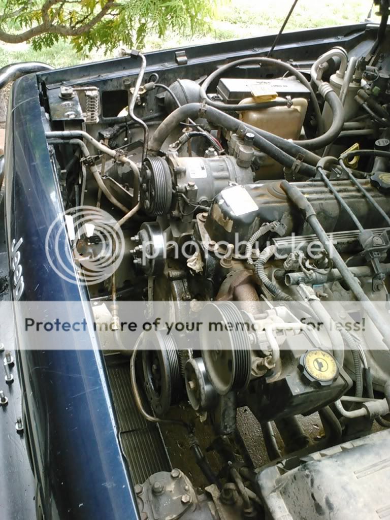

I cleaned up everything that came out that is going back in, picked up a new 195* oe t-stat and gasket, new upper/lower rad hoses. Waiting on the new oe radiator, fan clutch, and water pump (went with a Bosch oe pump). I'm sure there are some other things I'll have to snag that I've forgotten about.

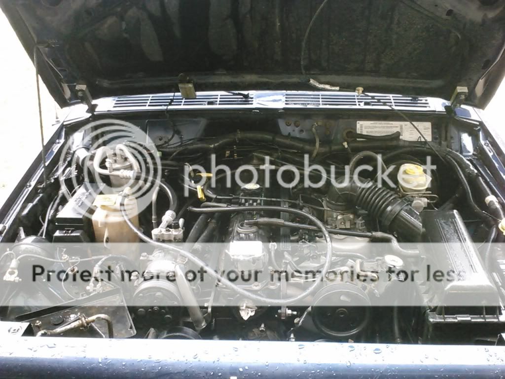

I also shot the engine bay with Simple Green and hosed it out while I was under the hood:

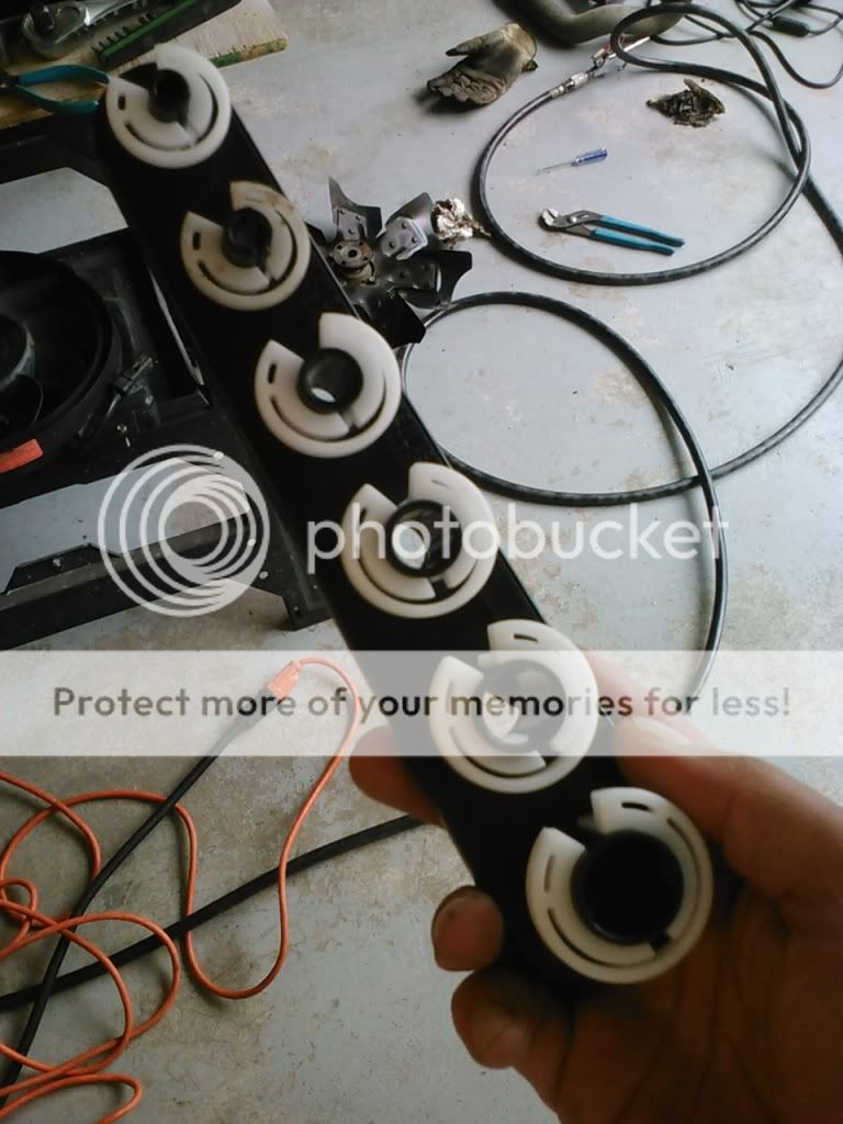

I decided to modify the Haynes oe fan clutch and cut the fins off. I just didn't like the way it looked like it was gonna work like a hole saw on my new radiator:
