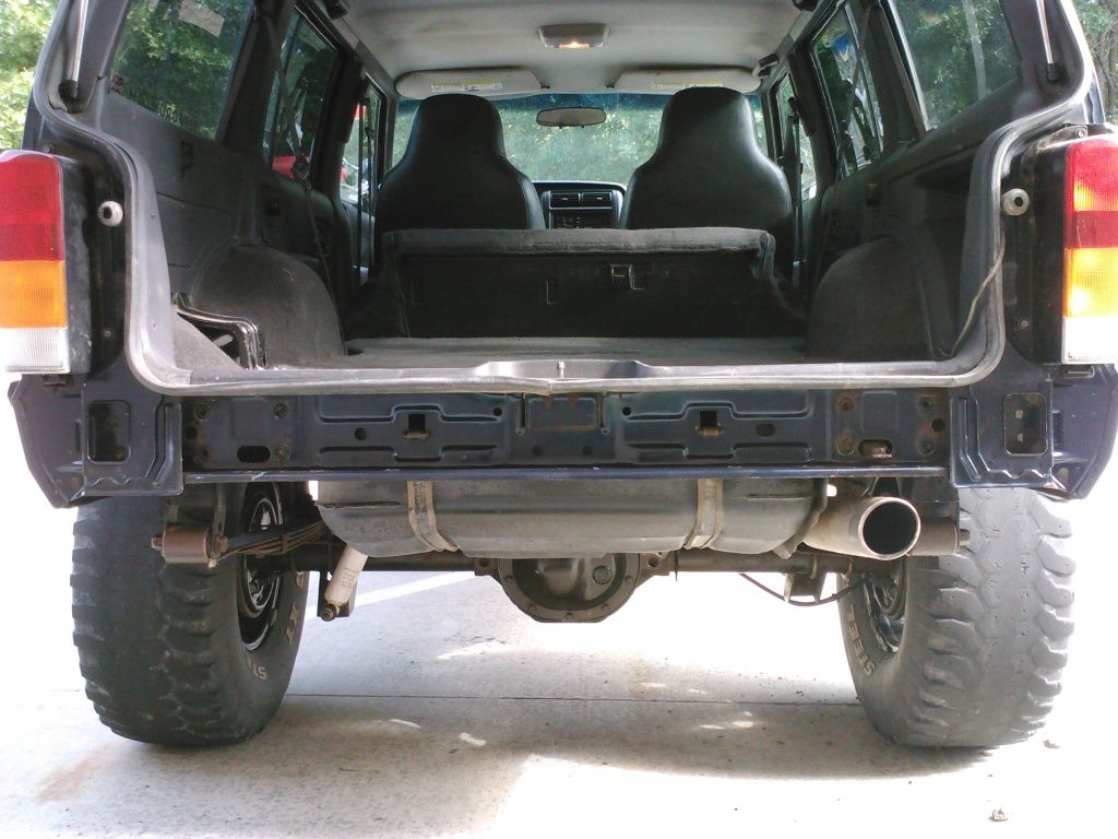

Finally got it licensed yesterday. I made mention in another thread that this rig will see limited pavement driving. It was bought primarily to be a trail rig toy but I wanted to have plates on it so it could serve as a spare daily driver if the need arose. I haven't dropped the rear diff to get a look at what's going on in the pumpkin as far as lockers - but I have it on good authority that the rear was welded, which I kinda figured after driving it a little more. No ratcheting just the chirping of the rear tires during turns - another reason not to drive it around the streets too much. Not sure what I'll do about the rear diff - leave it welded or tear it out and put a Detroit and regear at the same time. Time and money, baby!
I got the tail lights swapped the other day and wrenched the old mangled bumper off:
You can see the rear tires are bald as hell - still workin on new or new-to-me tires. I also got started hitting the bumper I picked up with a good sanding with the angle grinder. I wanted to knock off the surface rust and scuff the rest of it up real well before priming it and putting bedliner on it.

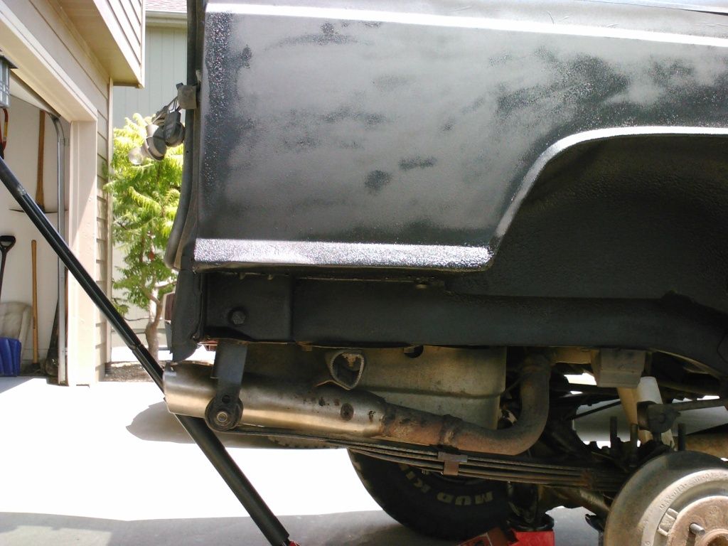

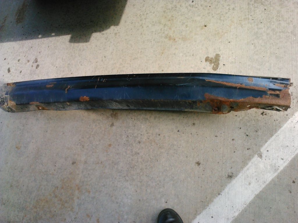

I spent some time finishing the rear bumper today. Didn't get it bolted on yet - I wanna give it a day to completely dry. Prepped pretty well with the grinder and my mouse sander:
Then I put some primer/sealer to it - I took this pic after running out of a can and had to pick up some more:
While that dried I took some pic whore shots:
Then I put several coats of spray-on bed liner. Dupli-Color Bed Armor - awesome stuff, used it on the WK for a couple different projects:
In between coats of that stuff I thought - why not do some trimmin?
I only did the driver rear fender cut/fold - I'll get to the passenger rear another day and clean up the fronts too.
Took the tire off to get it outta the way:
Made my cuts:
Folded them over, hit it with the smoothing grinder and then scotchbrite. Put the tire back on and called it a day:

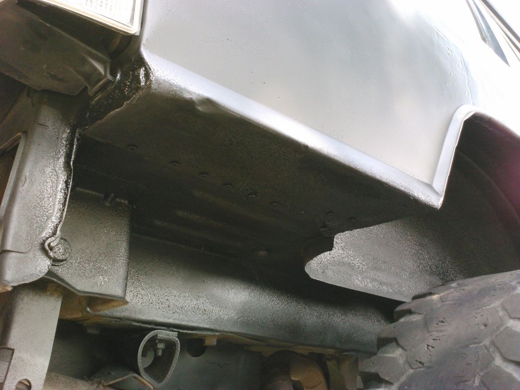

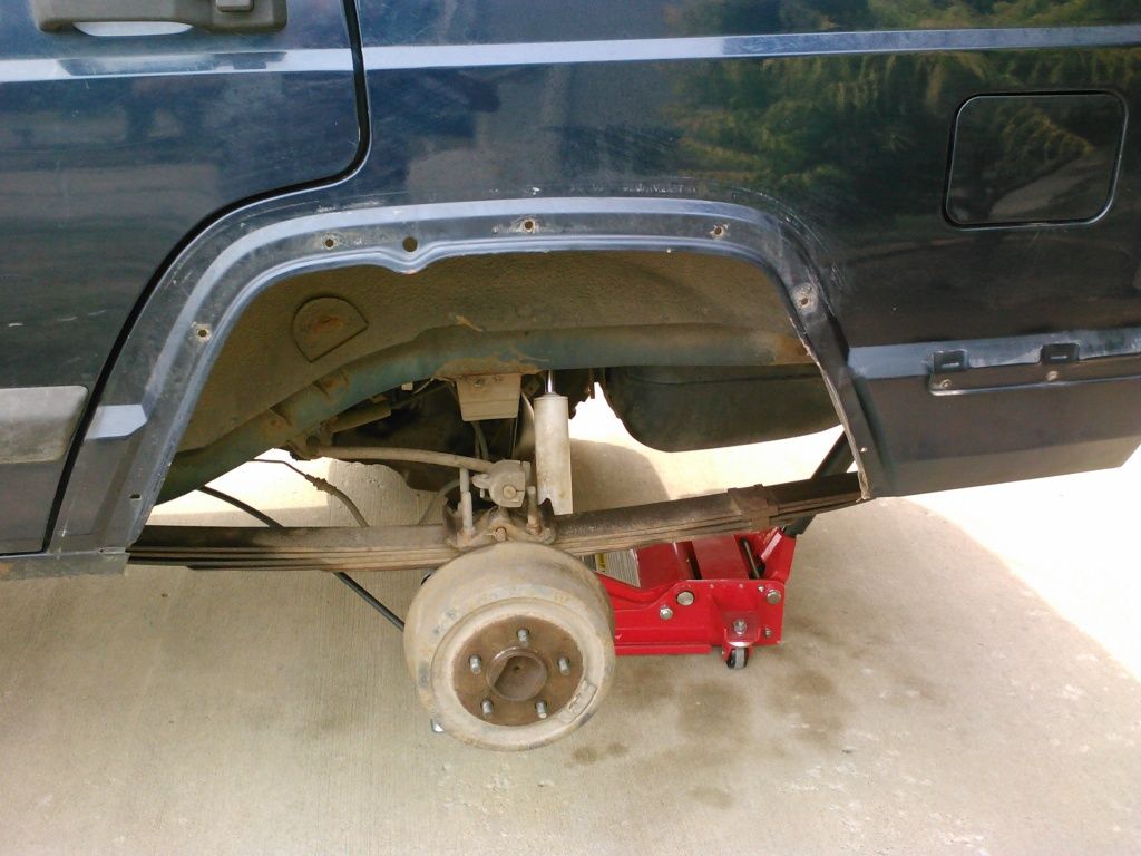

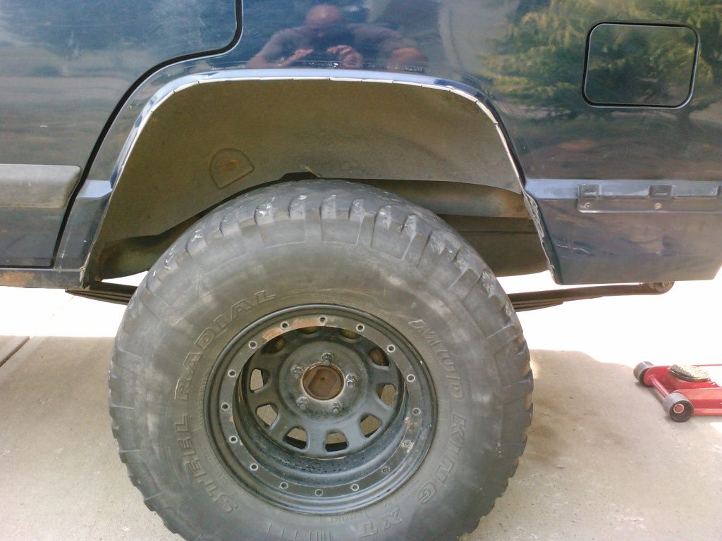

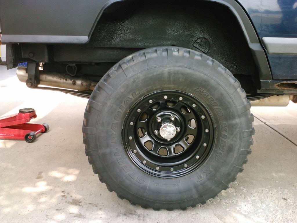

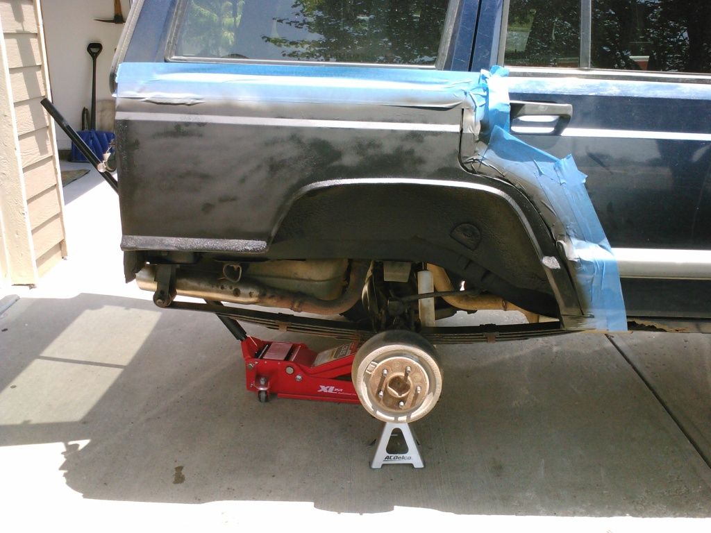

Got some work done today. The rear passenger quarter and fenders got trimmed, cut, boxed, and readied for the KM2's.
Boxed, trimed, prepped, primed and some undercoating:
Primed the body and fender cuts, then did Rustoleum under coating on all of it, and finished with flat black enamel on the quater panel. A couple coats into it:
Almost done - while I was at it I pulled the rear drum and hit it and the brake assembly with brake cleaner:
I also got the rear passenger wheel sanded, primed and finished while it was off:
The finished passenger rear:
