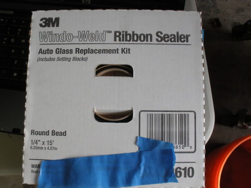

Originally Posted by Project1 View Post
man the window is great... did you go with mar 10?
mar 10? Don't know what that is. I used this:
and this:
When cutting the polycarbonate I used a jigsaw and laminate (20 tpi) blade. It is nearly a must to have a large enough flat work space to put the sheet on and clamp the edges - otherwise the plastic will bounce and crack. Also - have a spray bottle with water on hand and spray the blade/plastic interface as you cut. Otherwise the polycarbonate will melt/fuse back together at the trail edge of the blade as you go. It is not a fast process cutting this stuff.
