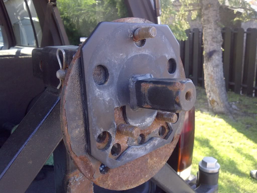

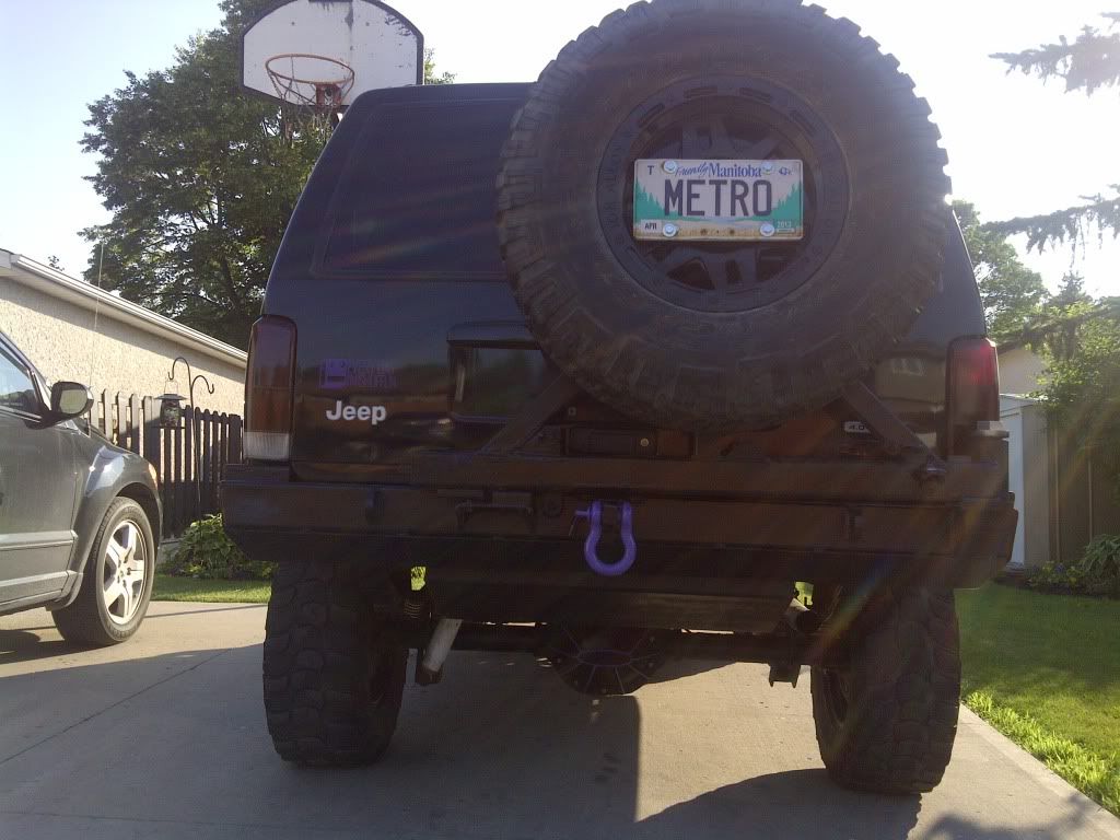

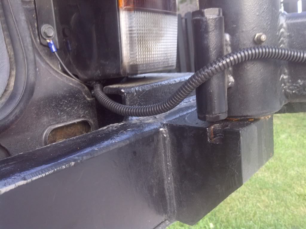

Well I finally figured it was time to relocate my license plate since my spare/carrier were completely blocking it.
Had a spacer with a with a piece of stock welded to it, and a tapped end.
Spare mounted, I then drilled through an old plate I had in the middle, and mounted it with a bolt to the tapped stock, then used the old plate to mount my actual plate with the existing plate holes.
I then had to figure out a way to wire up a light, so I spliced into the stock plate light and ran wiring behind the interior panels, out the tail light gromet, then drilled a small hole in the bottom of the tail light housing, (RTV used to reseal it), then ran it up the cross beam on the tire carrier to the rear of the spare. Just waiting on some LED bolt lights now
I'll be using these, I ordered them $15 to my door off ebay

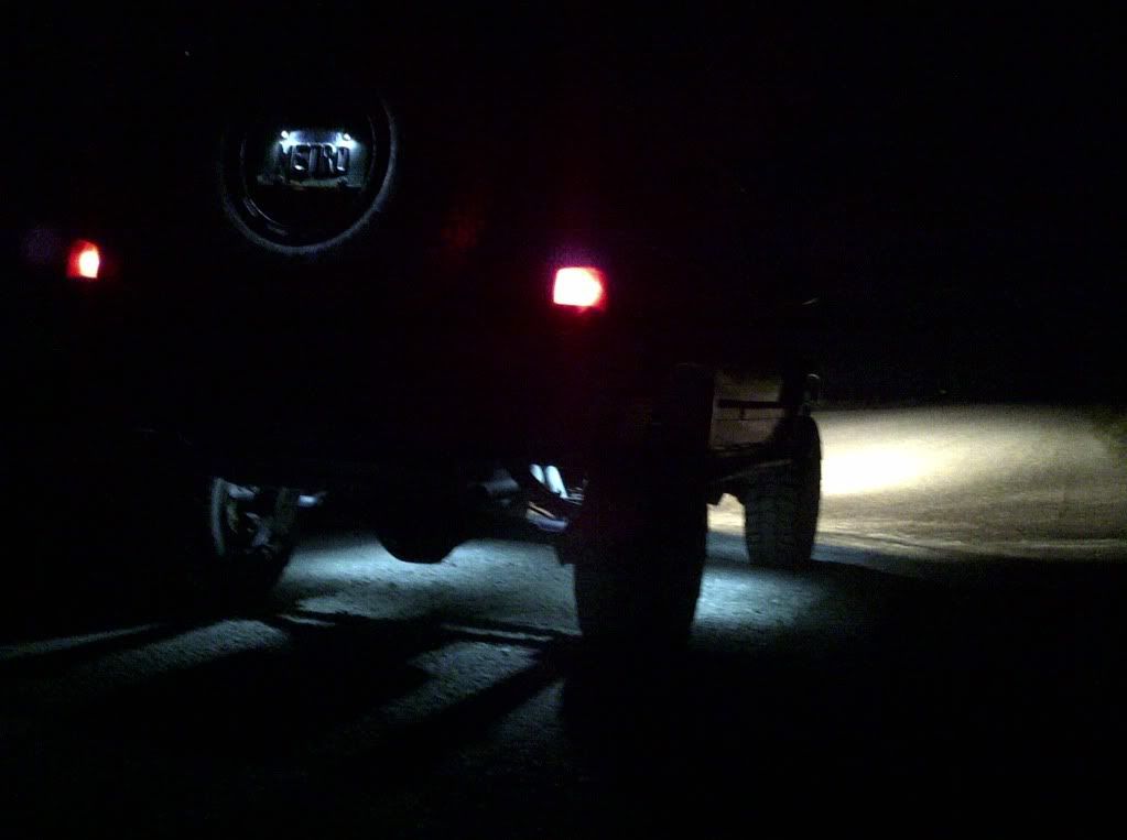

Well my LED bolt lights finally came in so finished wiring them up. The work great! I made quick disco's in the wiring so that I can easily remove the plate/lights when I need my spare.
Came out nice and clean. Just how I envisioned it

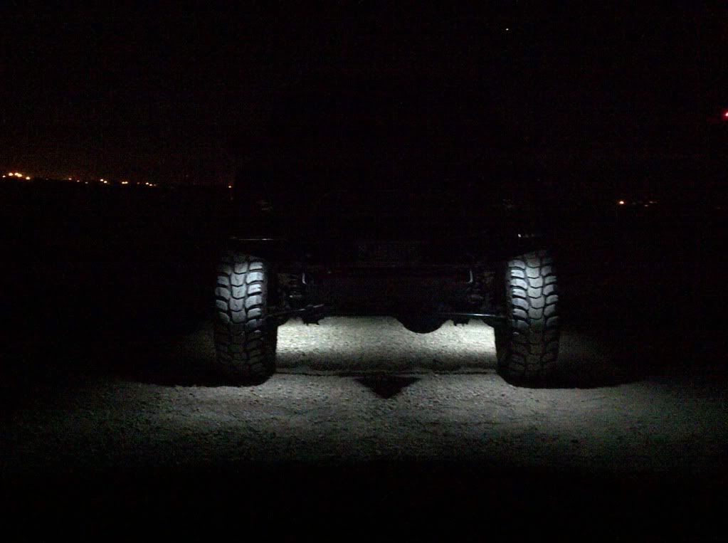

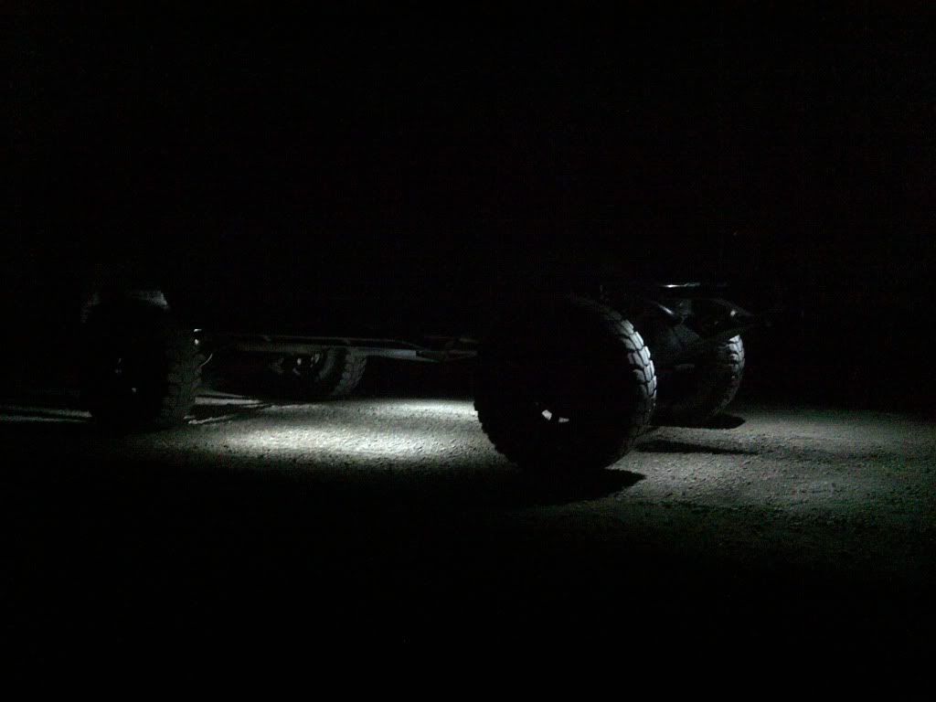

So tonight I extended the harnesses for the rock lights so that I could reach front to back on the Jeep.. It got too dark outside to actually mount and wire it all up but I think it is going to come out good, just by testing one side
Extended harness Vs. stock

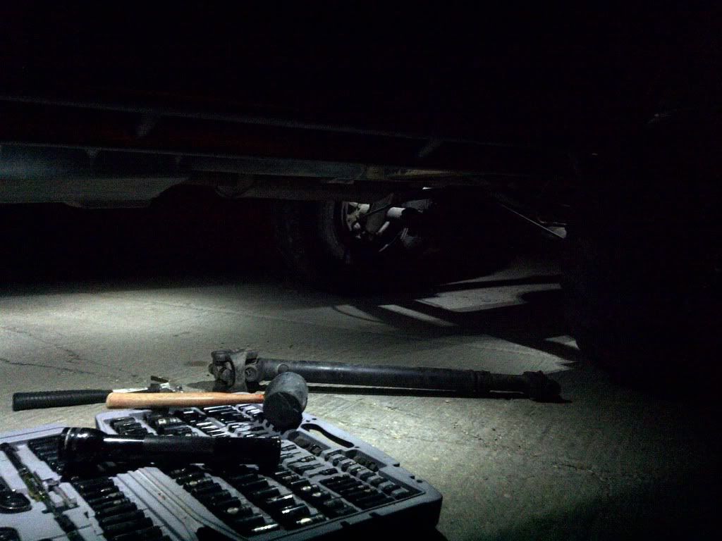

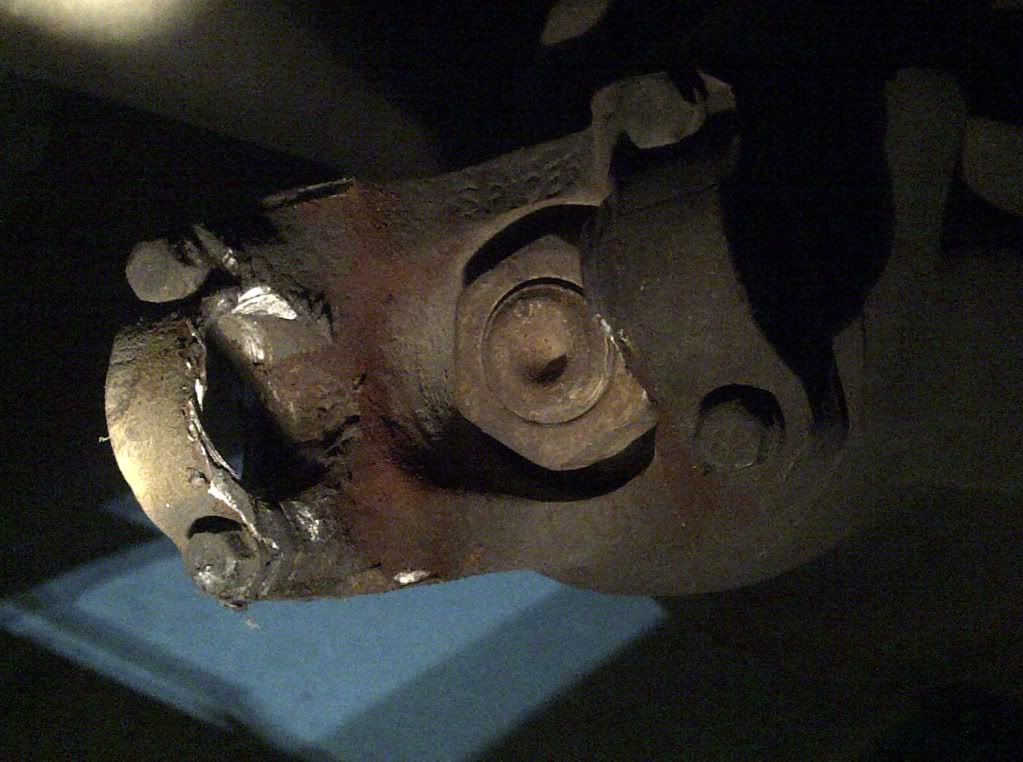

Wel last night I wired up my LED Rock Lights, and just in time, because while I was on the highway at around midnight, my U-joint on my rear driveshaft blew a cap and blew up. The rock lights sure helped with taking off the shaft in the middle of the night Looks like I may need a new rear yoke, as well as U-joint. I pulled the rear shaft and then limped home in 2wd (Fwd)
