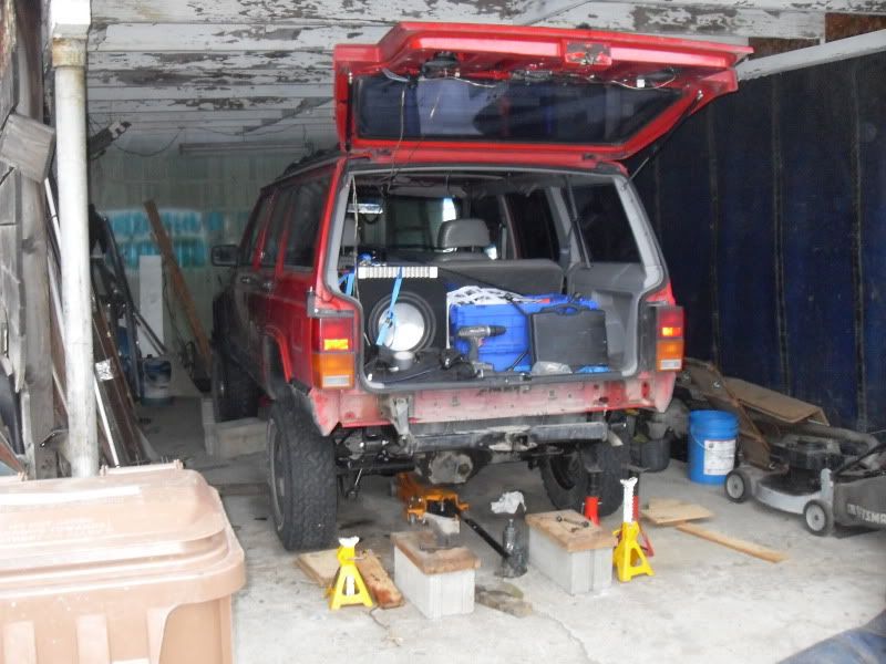

Don't torque leaf spring and shackle bolts until the weight of the Jeep is on the wheels - and don't reef on 'em once they are in. Also, you're a lot better off to rotate your cinder blocks 90* so that the openings face up. They will crumble pretty easily the way you have them but if you turn them on their side, they are structurally sound. Otherwise, HF sells some great 6 ton units for around $40 that go up high enough for my Jeep.
hmm didnt notice the blocks, dad did that not me lol

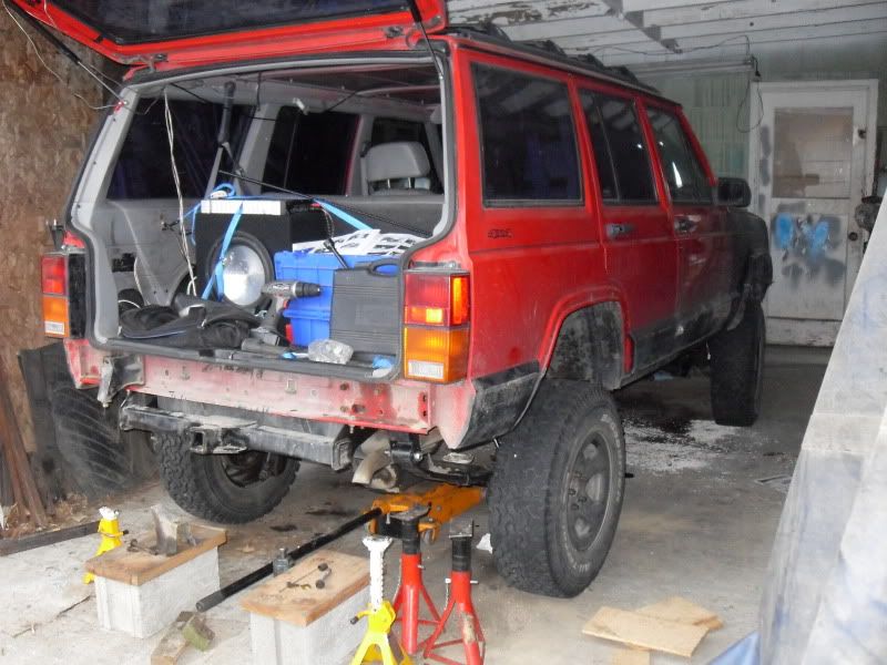

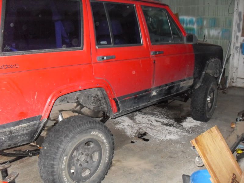

THE LIFT IS FINISHED!~= (>^_^)> KIRBY OF RANDOMNESS!
so the old shaft bound up when we finished the lift.
tomorrow we start the sye kit, my dad was like wtf is sye?!?1
going to wait till the sye and everything els is done b4 i put the transfer skid on

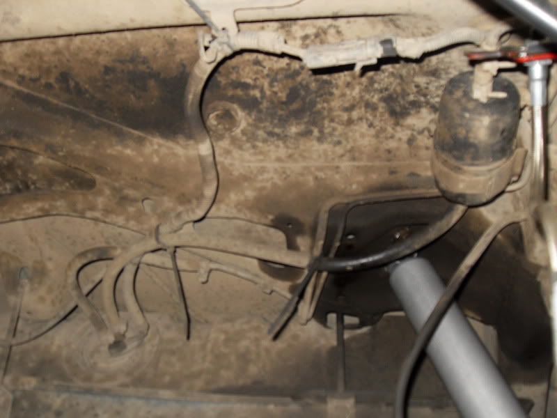

nasty under here

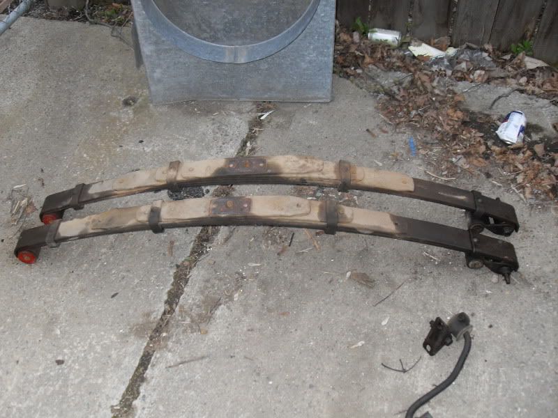

oh and here's haleys leafs....are you going to add a leaf to make a bastard pack?

Dude, I dunno.....im assuming those leafs are 3" leafs...how much do they sag? I'd probably just throw them on for now until I get some adjustable RC lift shackles. But the jeep looks great Kris! Have fun with that sye! But hurry up so you can drive the dang thing!

idk seemed like they only sagged a little bit i never really noticed it.

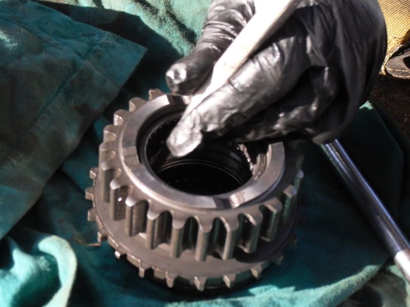

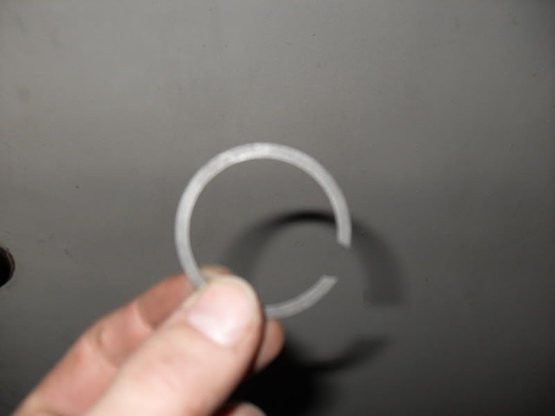

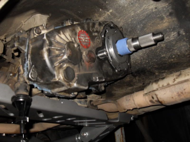

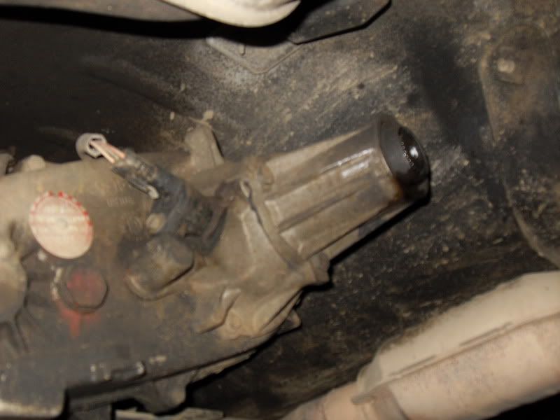

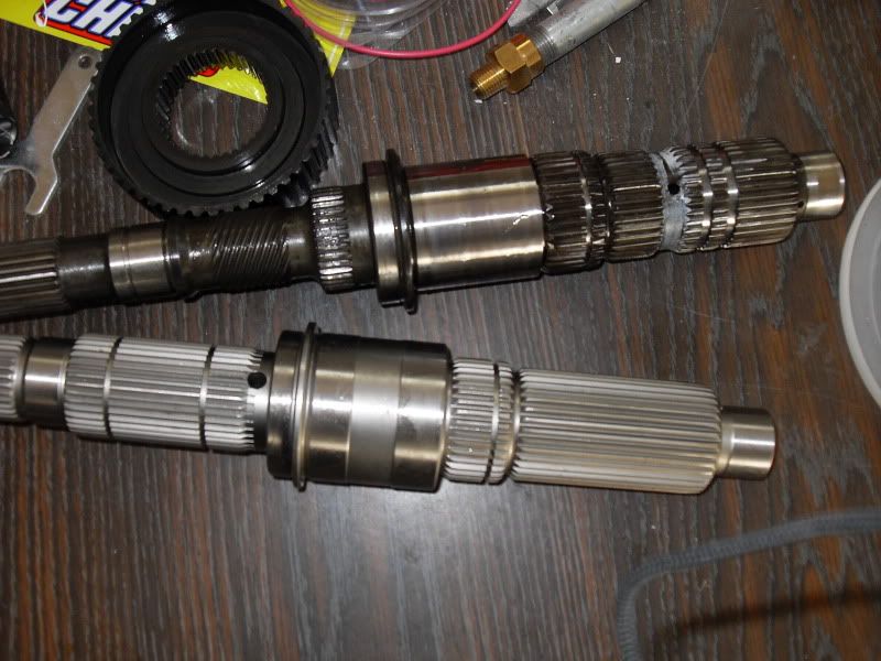

ok so when i went to work today my dad stopped by and took the front shaft off somehow. good... we dont have to mess with the crossmember... so to start advanced adapters forgot to give me 2...2!!!! speedo snap rings.
i need to go around to find a second one now on sat & look for drive shaft at spauldings. im told from my friend that did his sye that he used a 2000+ grand cherokee front shaft.
anyways heres the 1 snap ring i have
old and new shaft
taking out the needle bearings
now shaft is in but waiting on me to get ring
