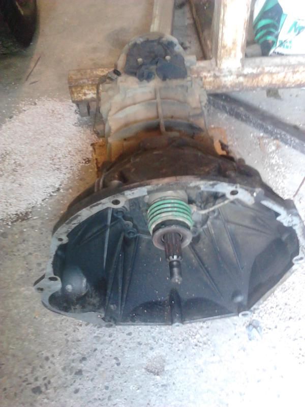

Is that an internal slave? Hope you are changing it if so! Otherwise looks good!
what do you mean changing it? wahts the pro and cons of doing that. dad help me remove it all and it was hell :P
Change as in install a new one. If it dies you gotta drop the trans to fix it. I think the ax15 external though. Did you change the throwout bearing?

Looks like it is an internal slave:
https://www.napaonline.com/Catalog/C...+50038+2038004
It takes about 5 minutes to change with the transmission out. I did a clutch in my old YJ and didn't put a new slave in (only had 100,000 miles on it) and had to drop the transmission again 3 days later to put a new slave in it. For $130 it's well worth it. You can probably order it from RockAuto significantly cheaper.
If you look closely the body behind the bearing and spring is plastic. The body cracks and the brake fluid leaks out, leaving you unable to clutch.
I'm in the valley almost every day around 3pm to pick up my son. If you want, I can swing by and show you how this works and why you should install a new.
Edit: The throw out bearing and slave are a single unit in these transmissions.

Well the shop rebuilt it with out asking me ..oh well came to 677.00. I just got a new clutch slave and flywheel from my work. Wish I had the money to do the external slave swap but I'm about broke and need to pay off my credit lol just want this jeep running again soon.

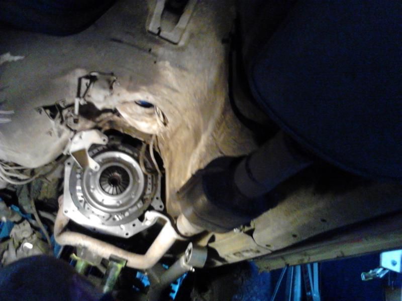

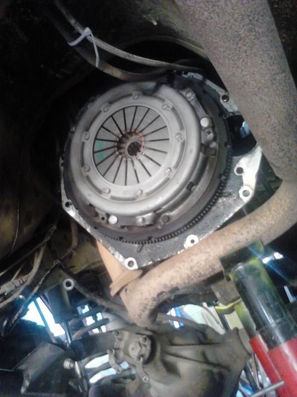

just put in new flywheel,clutch kit but thats it for today :P
