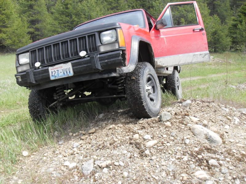

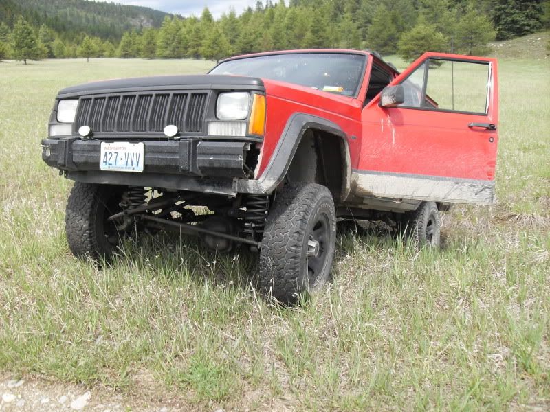

Pick up a new tie rod end and adjusting sleeve for the v8 tie rod and installed it today, now i dont have as much play in my steering as i did before but still need to do an alignment
Put in all new steering. But noticed drop pitman arm is wearing out and with the new stiff tre's and stuff I now have a popping sound, also still have a little slack in the steering wheel
I like it but almost seems like in to high geared for a manual, yea my pitman is wearing and popping oh well for now. If something happens ill be doing the Durango Box upgrade and new Extended arm. I bought a new speedo gear but havent put it in yet. One thibg iv noticed is I dont see how anyone with ny lift kit can Fit 35s without lots of trimming xuz my 33s rub
