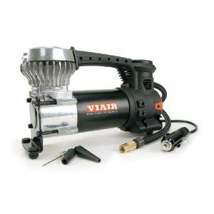

Just ordered a couple offroad goodies. The 12v compressor I have worked great on my Corolla tires but left a little to be desired on my XJ's 235s. I've shopped around some and just ordered a Viair 85p which will handle up to 31s. I also bought a 12v plug that clamps straight to the battery terminals so I don't have to worry about fuses when running the compressor. I can see a variety of other uses for it as well.
