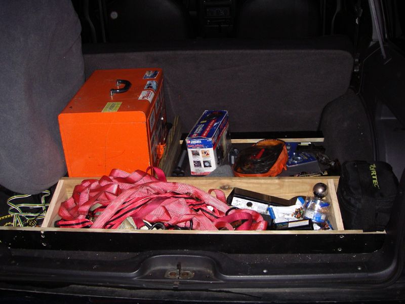

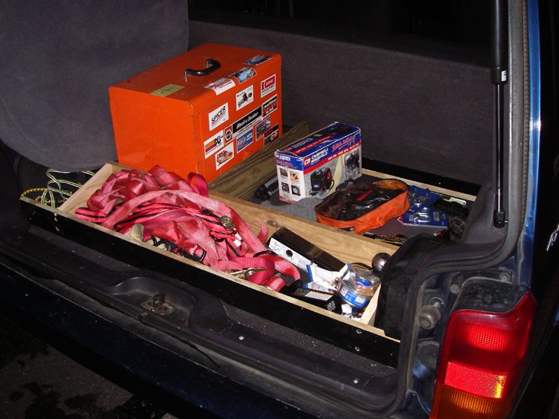

Today after work I rebuilt the rear divider I'd made a while back to keep everything from sliding around. I've also got 4 D-rings I want to add to the floor to be able to really secure everything. The divider won't be fastened down like some of the other storage solutions you've seen but it will be incorporated inside the tie-down configuration with the installation of the new D-rings.
The layout of everything is so a cooler fits between the tool box and the wheel well like before but I added a couple other pieces so nothing slides even when the cooler is out. It's also much lower than the original version to facilitate easier removal of the toolbox and the cooler. Everything except the soft-sided lunch box, the bottle jack and the 12v air compressor fit into the toolbox but I didn't fool with cleaning things up yet.
Now just to prime and paint!
*edit* - I went to mix up my primer and apparently it froze and cracked the plastic bucket. Plus the battery for my drill to mix it with is still dead from my last junkyard run. Guess I'll have a beer and wait on it to charge.
