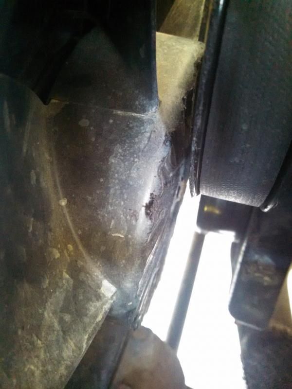

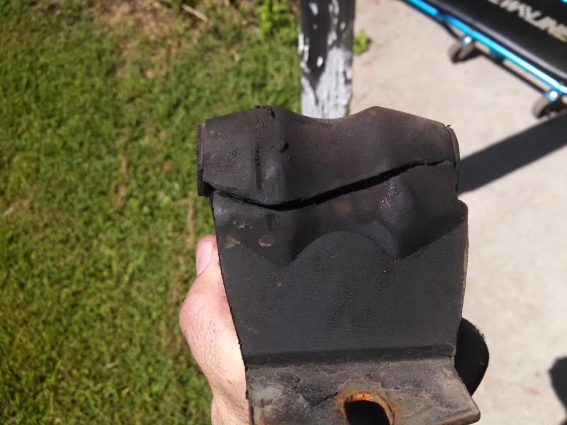

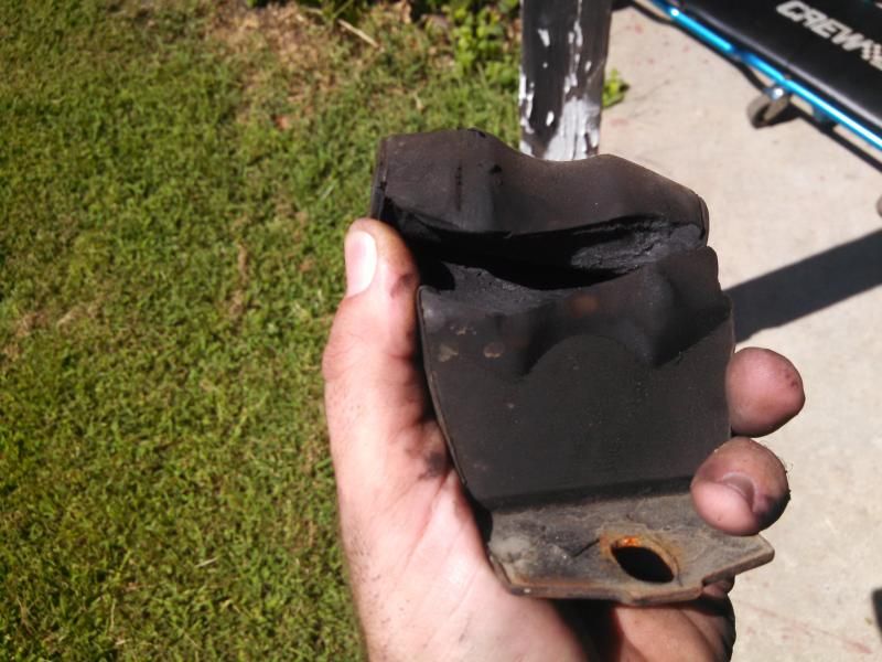

I'm having an issue again with the engine moving forward under load and letting the PS pulley rub the electric fan. Never had the issue when I had the t-case drop because everything was tilted away but once I removed the drop and installed the SYE, stuff was getting a little too close. Back then it was the mechanical fan clutch rubbing the radiator.
I just ordered some Brown Dog poly mounts. I think I paid like $15 for the last set from Rock Auto so I'm thinking these should take care of it. The discount code CF2011 is still good for 10% off.

They came today but I didn't get a chance to install them. I did however glance under the hood and see how badly my e-fan is getting chewed up. 😕

Stopped for a beer and to wash my hands. I'm still tightening everything back up, but here's the driver side mount where my rubbing was going on
"You understand that the nerves were completely severed?"
Gouges into the fan.
Spatter from the PS pulley.
My build thread has pics again. http://www.jeepforum.com/forum/f177/kevin108s-2000-xj-build-867428/
