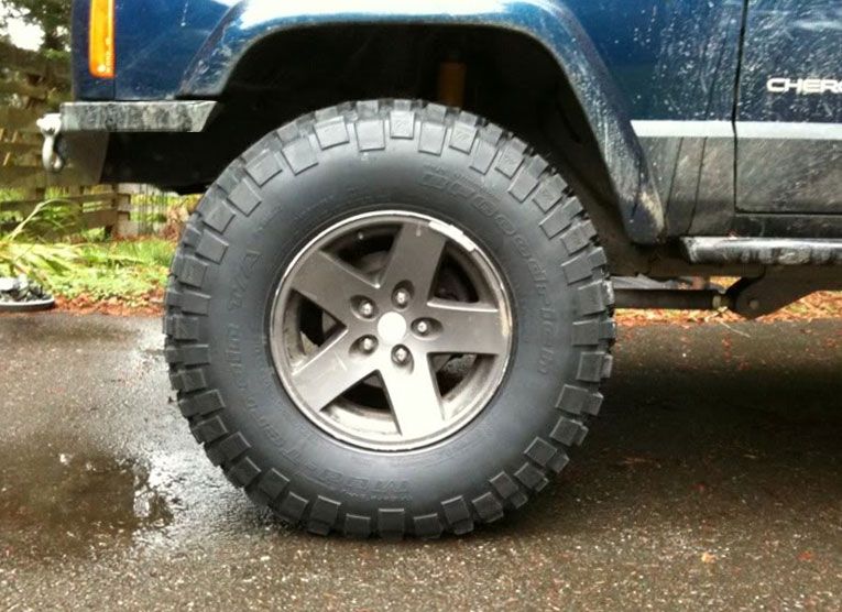

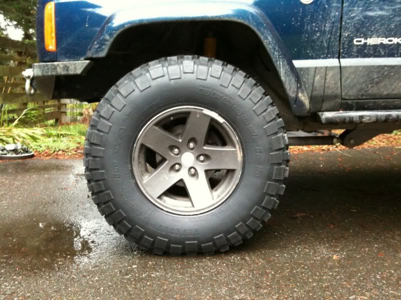

If I could find a used one, I'd go for a Detours Tailbone. New, I'll never have one. As cool as it is, it's just not a $300 part to me when whole bumpers can be had in a similar price range.
Here's a shot of srmitchell's Rigidco front bumper. The profile is great, just the sides are wrong.
To satisfy me, an aftermarket bumper needs to extend to the inside of the stock flare then match the angle through the bumper. Super simple, but I've never seen a bumper built like that.

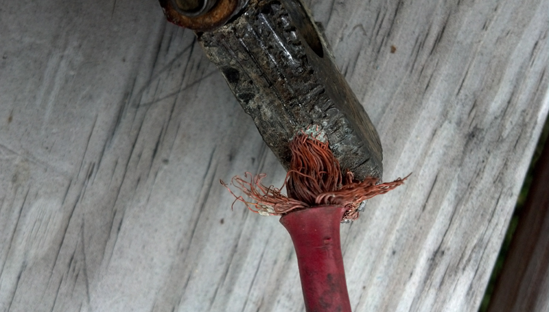

I was having some engine starting issues where it was turning over with great effort and very slowly. I started with what was definitely an issue: the corroded positive cable. Multiple strands were split away and you can see the corrosion going inside the lug as well.
I bought a new 38" cable for the starter. I added a longer 5/16" bolt for the terminal. I cut off the 18" wire for the PDC and added a lug so I could tie it back in with a second nut on the longer bolt.
I then had the battery load tested and it was determined to be bad. It's only 2 years old so I'll go tomorrow and see what level of replacement it qualifies for. I also aimed my headlights again for the new header panel. Once this nonsense is out of the way, maybe I'll be able to get into fixing the blend door. Maybe some day I'll get to the bottom of my no_bus issue as well. I'm going to keep my eye out for another computer just to try. The one I have now is making the ScanGauge do strange things.

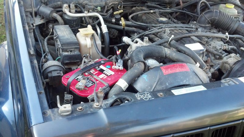

My slow start issue I've been fighting is from a bad cell in a Duralast battery. It's only putting out a little less than half of the cold cranking amps. It had a 2 year warranty and it's not even two months past that. A direct replacement is now $100. This was a $60 battery just two years ago! The 5-year replacement is $120.
As I was looking at prices, it then occurred to me that it's foolish to buy the same crappy battery again. Interstate batteries came to mind as something I've heard recommended so I looked up prices on those. $120 on the low end, up to $280.
Then I looked up Optima prices on Amazon. They used to be expensive, remember? $144 for a red top with free shipping. Done!
