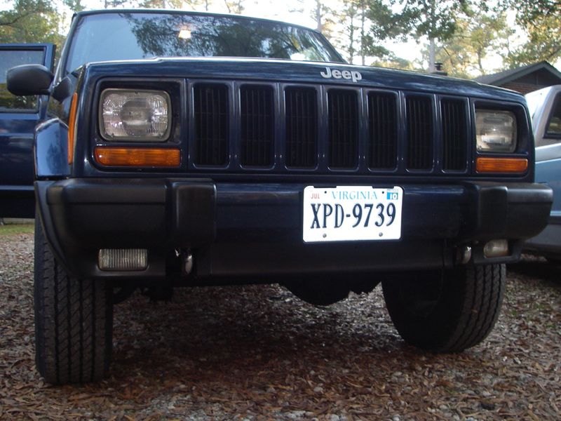

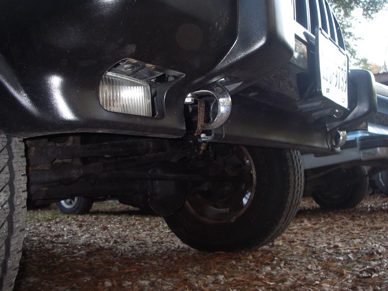

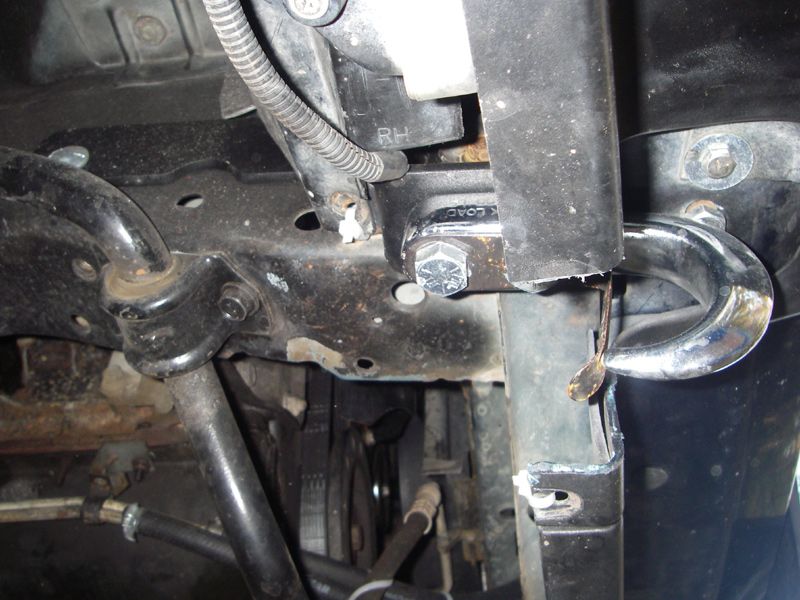

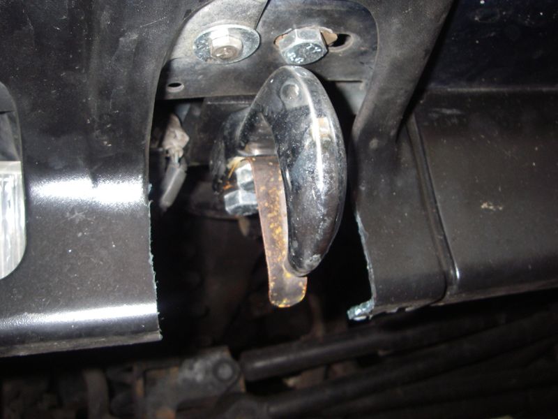

Here's my post-install pics of my C4x4 hooks. They were supposed to be black but I'll just address that when I sandblast my other rims.
I did have to trim my air dam. Others have just trimmed the opening a little lower but I went ahead and cleared it out all together. I used a speed square to draw a straight line on the back of the parts and cut them out with a small pneumatic saw. I used a Dremel with a grinding wheel to dress the cuts as the saw I used melts through plastic more than it does actually cut it.
The keepers have some type of sub par black oxide coating and they rusted immediately. If you're going to use them, you should paint them before you install the kit.
One thing I did differently than most people is that in my hooks, there are only the bolt heads. The threads are up in the "frame". I had to slightly notch the factory bumper mounts to clear the front bolt in this fashion but I think the clear, smooth hook space is worth the additional effort. I also had to slightly square off the washers on the front bolts to fit inside the brackets.
All in all it's a nice kit but it's really taking me some getting used to on how to work on these things. These hooks will be trail tested this weekend.

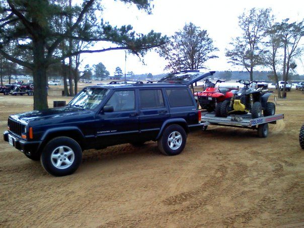

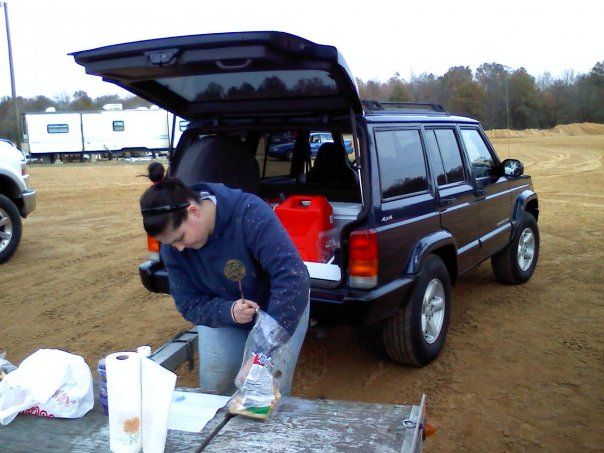

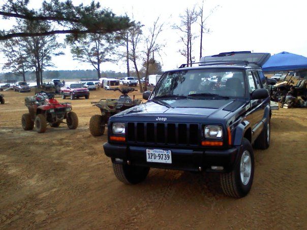

No real build info, just some pics. One of the primary reasons for me ending up with an XJ and equipping it as I have was to haul our ATVs from Virginia Beach to Busco Beach in Goldsboro, NC. This was the maiden voyage and we have returned successfully...and exhausted. I got 12 mpg on the way down and almost 11 mpg on the way back.
My build thread has pics again. http://www.jeepforum.com/forum/f177/kevin108s-2000-xj-build-867428/

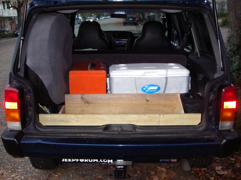

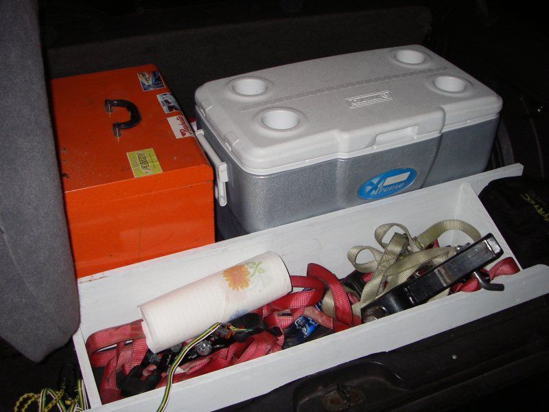

This is a small rack I made to keep the toolbox and cooler from sliding around while keeping a storage section. In the photos above you can see a 5 gallon CARB can fits well in it too.
I'm going to notch it out in front of the cooler so it's easier to remove but the orange tool box is on top of another flat toolbox and most of that height is needed to keep it in place. I also need to set it up so the cooler doesn't have to stay in to keep the toolbox in place. I hardly ever need the cooler but I often need the additional cargo space.
The day I built it
Primed (going to paint it black) and in use

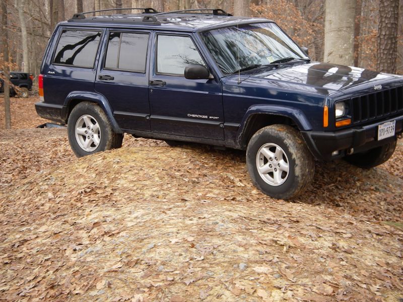

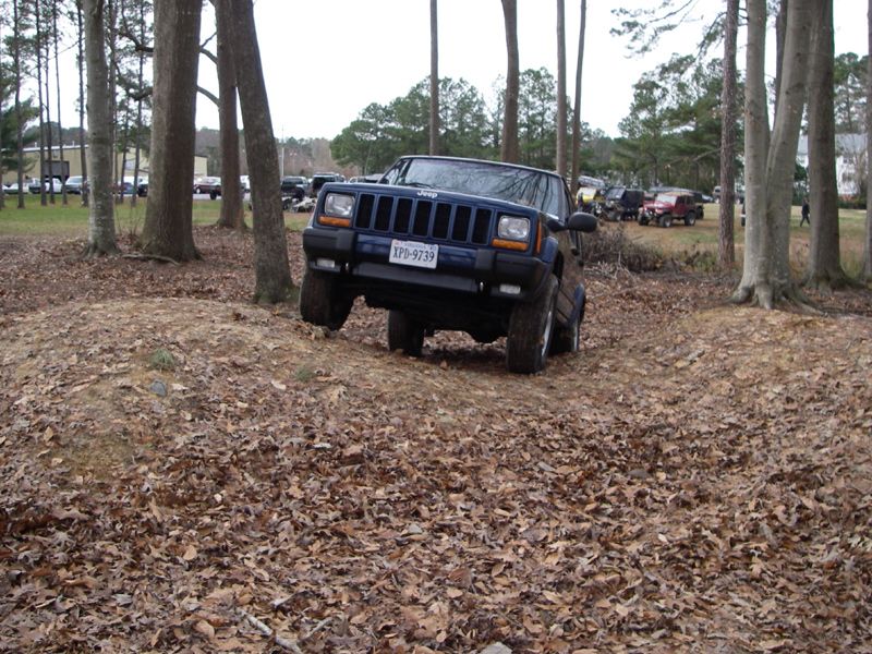

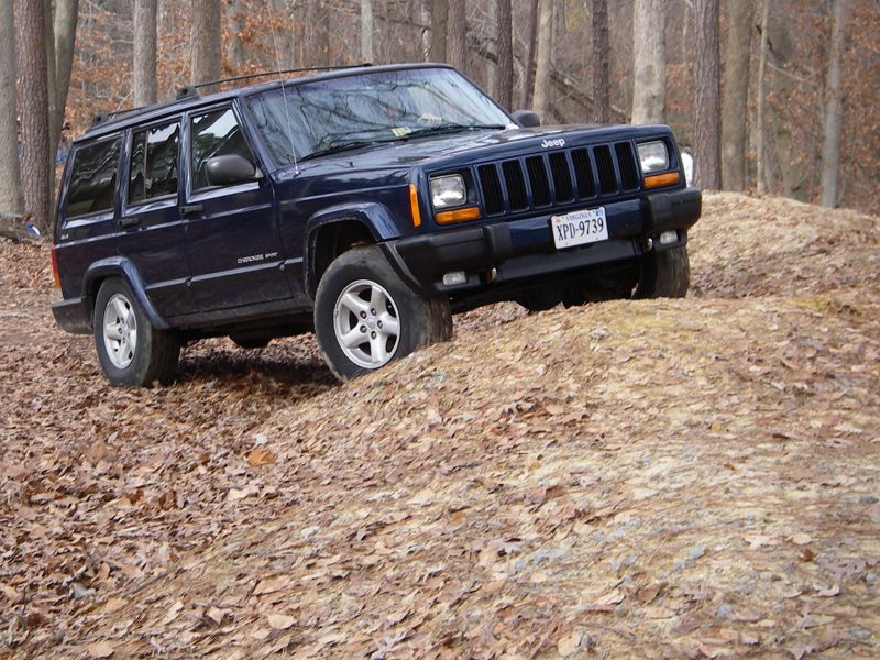

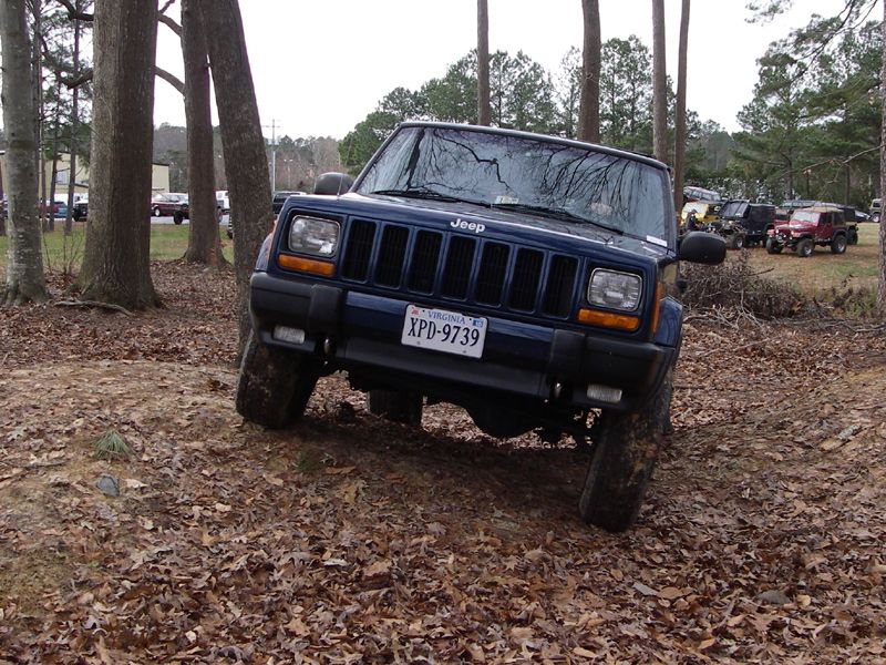

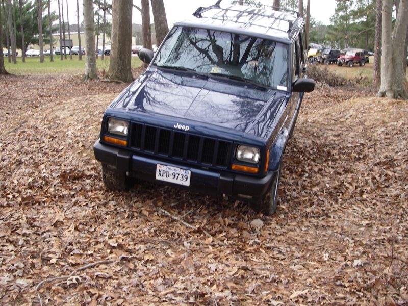

I finally got to wheel some! A local Jeep dealership has a small offroad playground out back. I didn't push my luck on anything, just played on some hills and watched the rest of the guys get crazy. It was fun!
