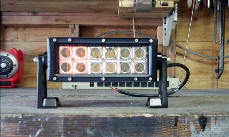

I scored a couple 6" Hanma LEDs for helping my buddy Jay along with a group buy he was doing. There's still a few extra. If anyone's interested, shoot me a PM.
I did some debating on my mounting options yesterday. At first I was thinking of mounting them inside the front bumper but that would have them set too far back unless I made a custom bracket to mount them far enough forward and I'd have to come up with a way to finish the edges of the hole on the uneven surface of the bumper face. I still like the idea though.
The other thing I came up with was mounting them on top of the bumper and notching the grille for the back of the housing.

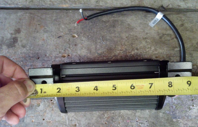

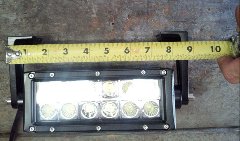

I finally got around to installing my Hanma LEDs today. I had debated several options. The feet could have been installed on the upper bevel on the front bumper. It also would have been simple to have added a plate to the top of the bumper to have made the lights fit. Instead, I decided to notch the grille out for the rear of the housings. This worked out perfectly and I love how the lights fit and look!
I pulled it in this morning without any solid plans. I thought I might get the bumper loose or at least get the old lights off. A few beers later, it was fan on, Jeep in, tools out, citronella burning, beer fridge properly stocked and beginning the installation.
As I'd done before on the other lights, I cut the factory fog light connectors loose and prepared them to be spliced in to power the new lights.
In the process of putting everything together, I found that the color scheme changed on the fog light side of the connector. Incandescents don't care but LEDs require proper polarity to work. I had to re-solder everything because of this stupid quirk.

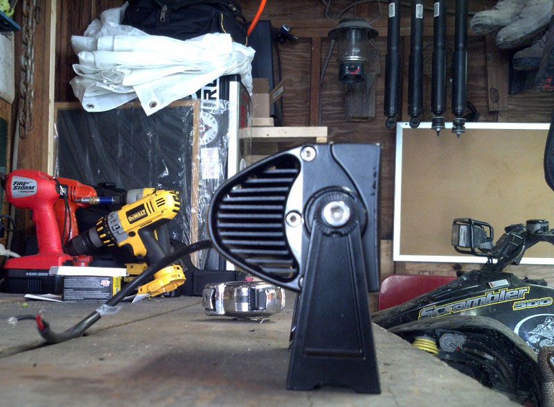

When laying out the lights on the bumper, I used my typical level of excessive precision. With the mounting feet turned inboard, the holes for the screws were 7" apart. I measured 1-1/16" off the license place frame and 7/8" forward from the back of the bumper.
I drilled and tapped holes in the bumper to mount the lights and proceeded to wire the OEM plugs into the new lights wrong. I love to ask my wife automotive questions I know she doesn't know the answer to. Before drilling the holes, I went inside and asked, "If I'm tapping to 1/4-28, what size hole do I drill?" She said, "1/4-27?" lmao I love that girl! I ended up tapping to 1/4-20 and grabbing some non-metric stainless fasteners from my local Lowe's.
Bench testing everything before installation.

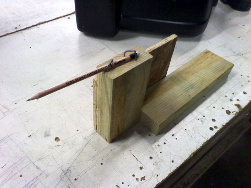

I didn't have anyone to help me line things up so I made myself an extra set of hands.

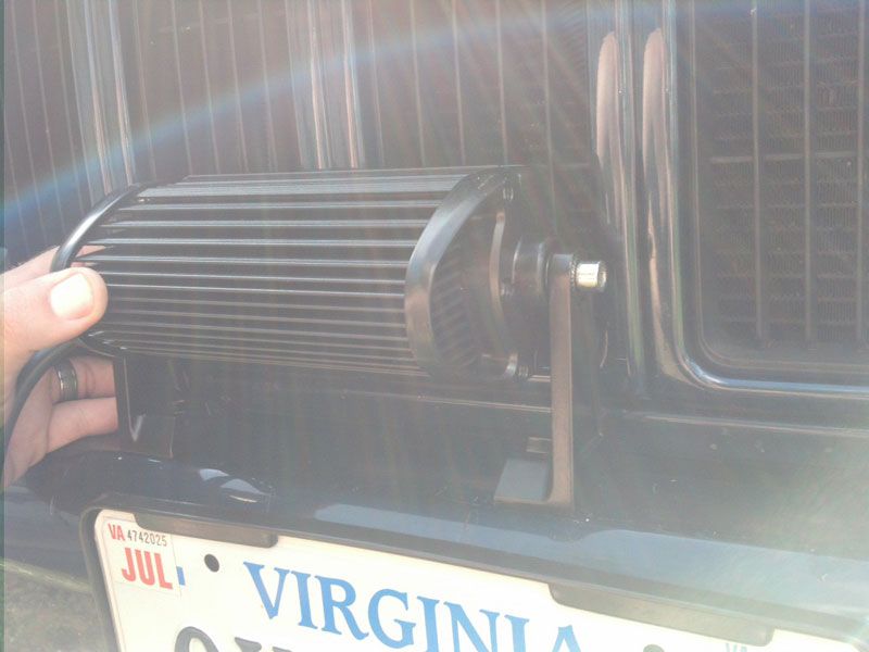

I marked the pieces to be removed with a silver paint marker.

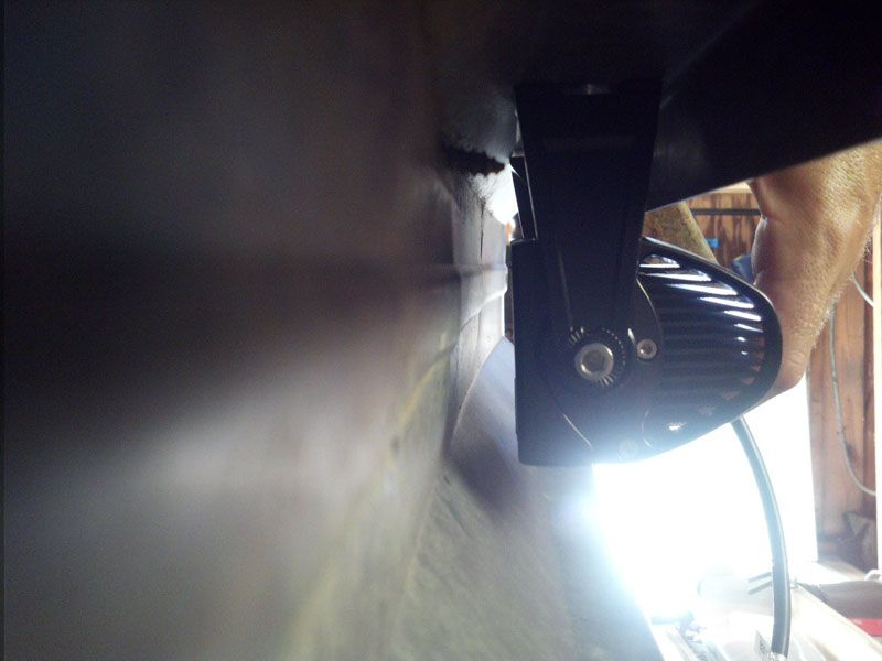

I notched out both the grille and the fiberglass supports to make room for the rear of the housings.
There were certainly easier ways to make these lights fit but I love how they've turned out.
The extra hole from the old lights will get plugged.
The grille just barely flexed enough to let the OEM fog connectors slide through.
This shows just how tightly the lights are tucked in.
Lows, highs, LEDs, LEDs with owes, LEDs with highs
Who needs headlights?

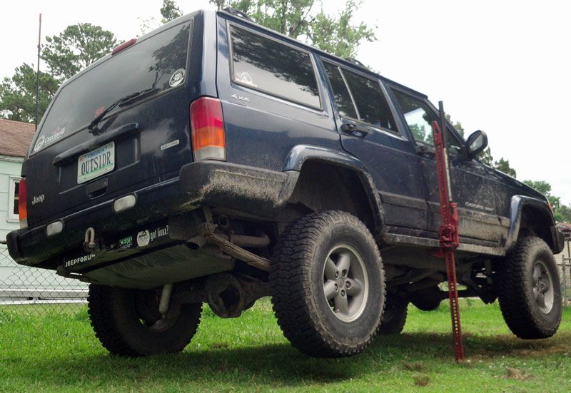

I'm going to order a rebuilt kit for it later but for the time being I decided to just clean the rust off of the pins in my Hi-Lift. Soaked them in some CLR and PBR overnight then hit them with a wire wheel and a fresh coat of white lithium grease.
Works great in conjunction with the rock rails.
