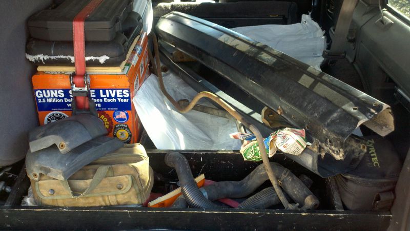

I brought all my spare parts home to clean up Dad's garage some and so I can start prepping the replacement rear bumper.

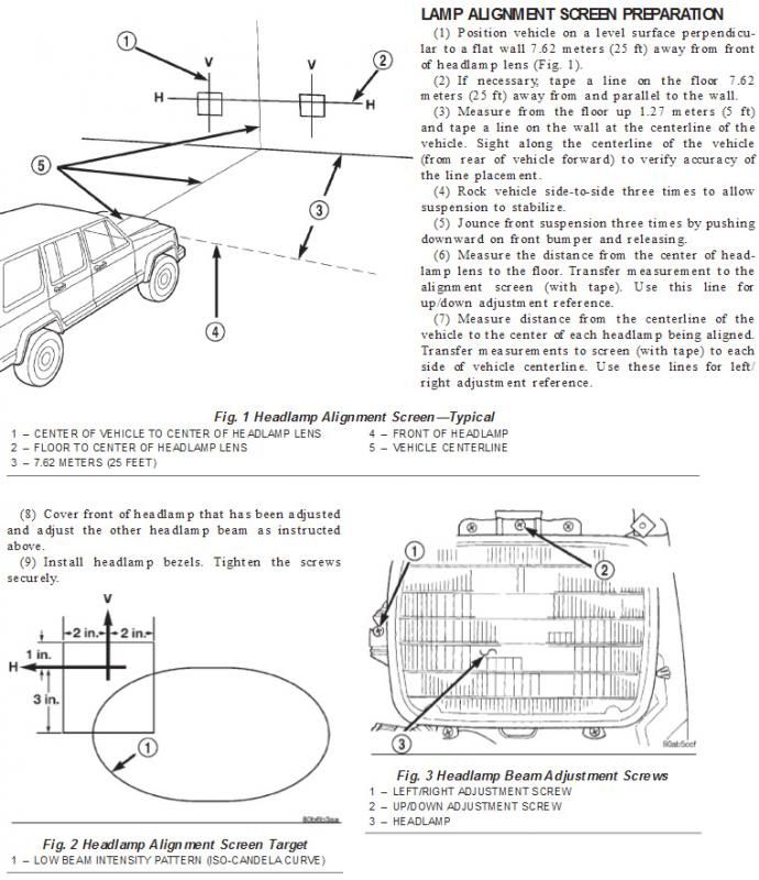

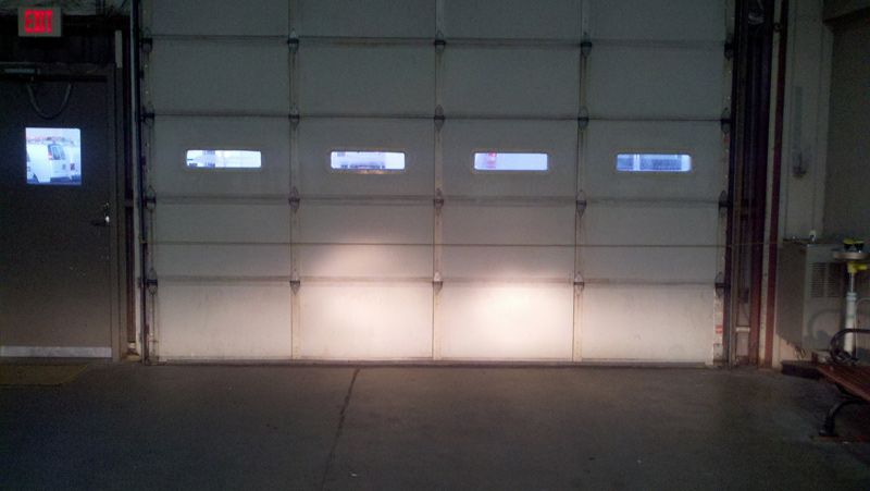

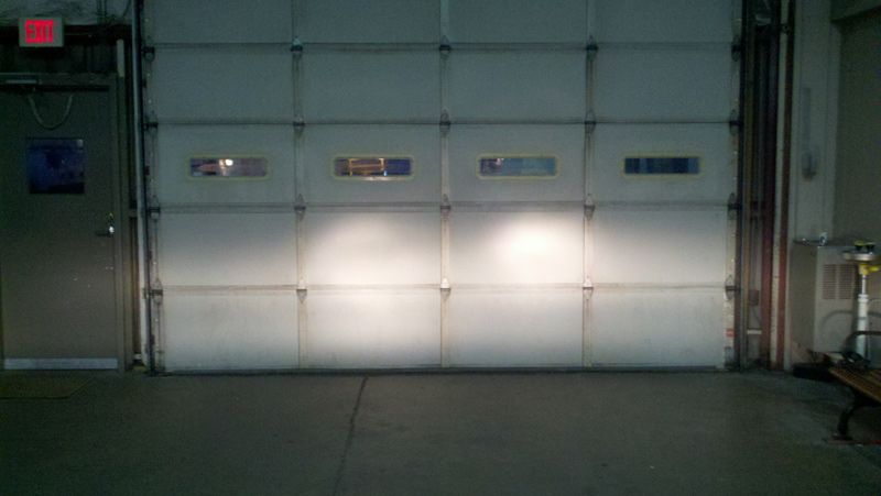

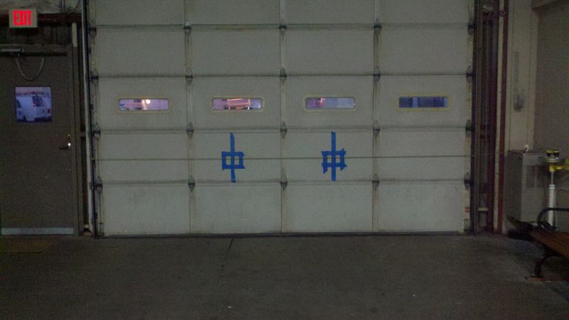

I borrowed the shop at work to aim my headlights. I followed the process from the FSM. What a different it makes!

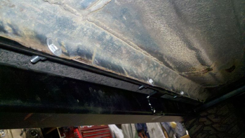

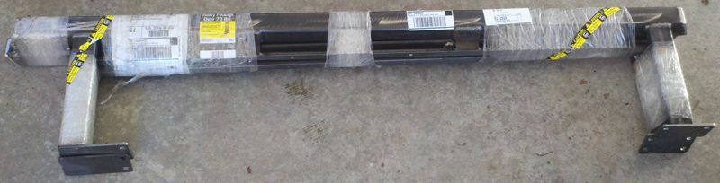

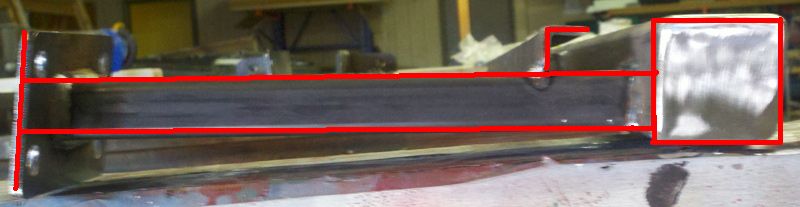

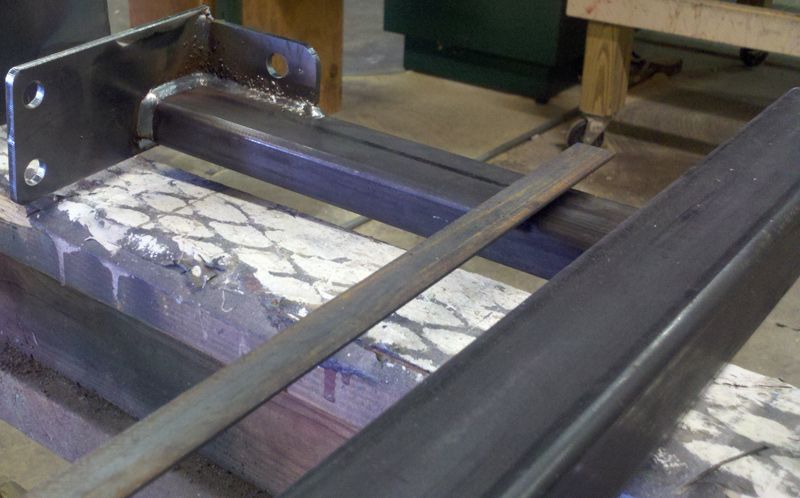

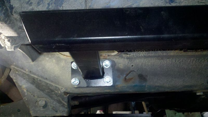

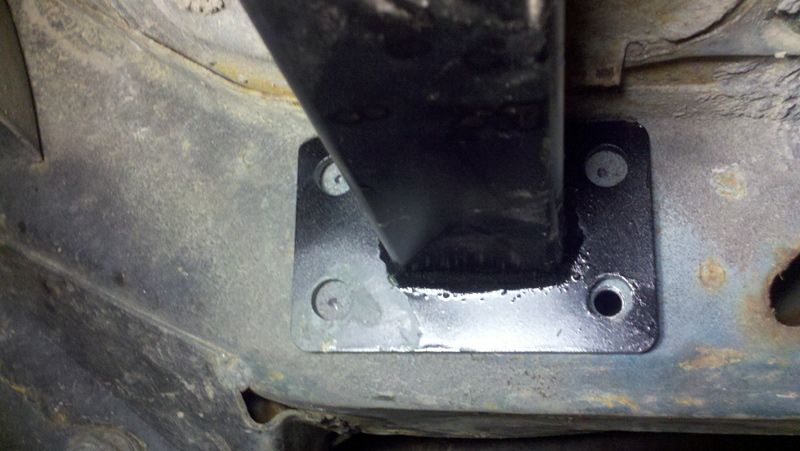

This is my install of my rock rails from AJ's Offroad Armor. $275 shipped plus a can of self-etching primer, two cans of Rustoleum satin black and a quart of acetone. I've been ready to get these since 2010 but other, more-pressing things came up, like my engine swap, wedding and honeymoon. So these got delayed a bit. Well, the time finally came and I was still able to get them in the same price range with the same customizations. From the fabricator, the ends caps of the outer rails have a diamond plate pattern. I wanted them smooth. They hooked me up, no charge. Customer service has been great as well. I anticipated building rails myself but all said and done, I think it only cost me about $50 more to get them to do it for me. YMMV.
Anyway, they shipped all plastic-wrapped together.
You can see where they dressed the corners and smoothed the end caps for me.
No pictures I've seen really illustrated the components and shapes involved here, so I did this for reference.
News team and sawhorses assembled, it's time to clean, prime and paint.
A little scale and surface rust but it all cleaned up easily.
Primed like 1-3-5.
Satin black was the perfect choice. The finish looks factory and by using a rattle can, touch-up after trail damage is easy.

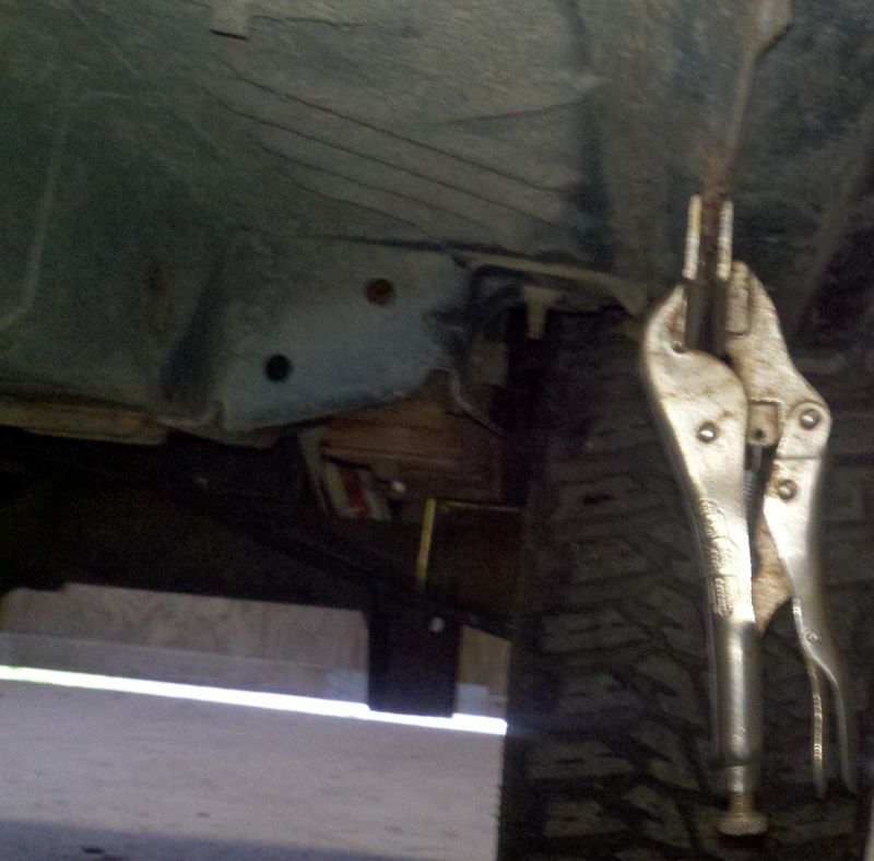

Time to gather your helpers for the install.
If you're like me, your pinch seems have already been trail-modified.
Dad had these. Don't know what they're really for but they worked great as hand seamers for straightening things out.
Clamped in place, ready to start the install.

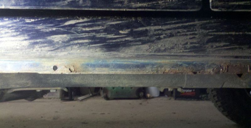

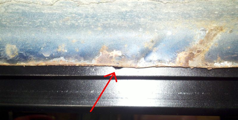

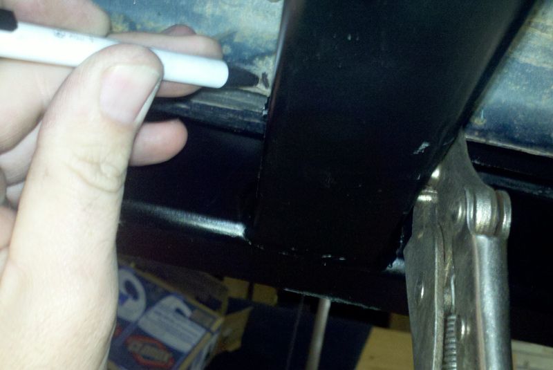

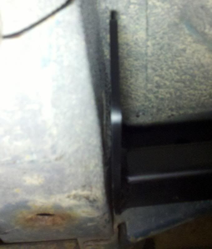

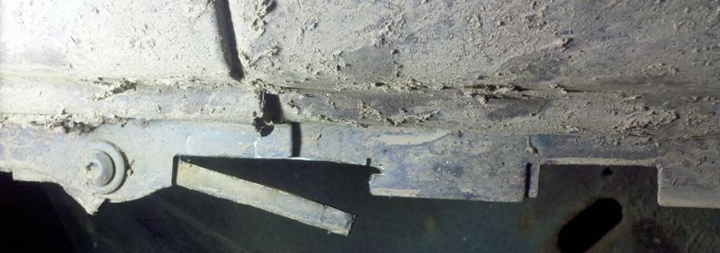

The test-fit showed that the rails weren't sitting high enough up.
That means some notching of the pinch seam over the mounting legs is in order. Mark 'em out.
Marks made, time for some sparks made.
Doesn't take much. I went about halfway through the pinch seam.
My build thread has pics again. http://www.jeepforum.com/forum/f177/kevin108s-2000-xj-build-867428/
Kevin108 is offline
post #384 of 640 Old 03-03-2013, 04:25 PM Thread Starter
Kevin108
Location: Portsmouth
Posts: 3,951

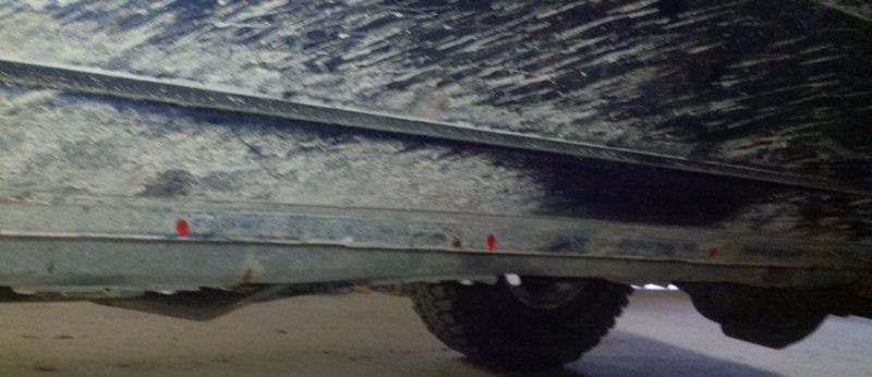

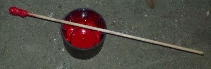

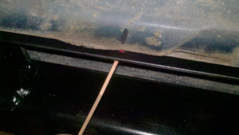

Next up, marking for the pinch seam bolts.
I used a cap from starting fluid and filled it with some red spray paint.
I then used some weird, long Q-tip I found in Dad's garage to apply the paint through the bolt holes onto the pinch seam.
There's no way to drill these out with the rails in place.
They turn out pretty well centered in the pinch seam, thanks to the earlier notching.
Bolted up. I ran the bolts this way to protect the threads.

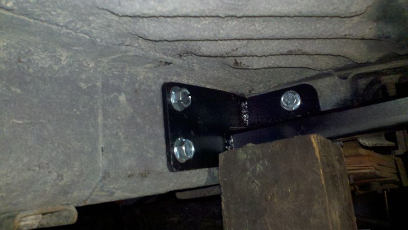

Overall the fit was good but on the drivers side rear foot wasn't quite where I needed it.
I used the factory XJ jack to spread it closer to the frame rail. Worked well.
Because of the bent pinch seam, I couldn't seat it as high as I needed.
I took a floor jack with a chunk of 4x4 and raised it into place.
Center punch and drill your frame holes with the rails in place.
Bolted.
Biggity bam.
Done and daylight.
