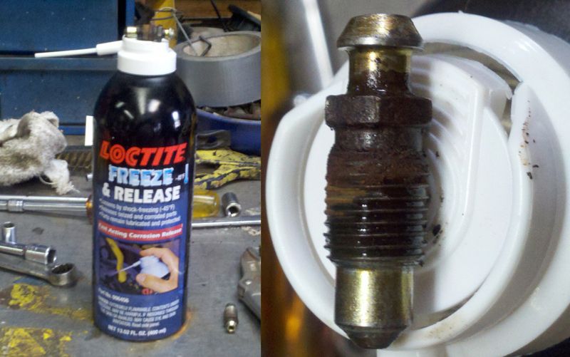

She swallowed a spider to catch the fly...
The right rear wheel cylinder was leaking. It saturated the shoes on that wheel. Replaced wheel cylinders, shoes and springs on both sides but needed to bleed the fronts as well to trip the proportioning valve. The front bleed screws were seized. PB Blaster didn't touch them. I thought about just replacing the calipers but that seemed like a lot of trouble for something so simple. In the middle of that, I lost a week to going out of town for a wedding and having to work some crazy hours. Got back to it today. I've been wanting to try this stuff for a while. I'm sold!
I wired off the rust, applied anti-seize and reinstalled them. We then bled all 4 corners with no issues and the brakes on my XJ have never been better. I'd love to do a rear disc swap but I went what I thought was going to be the quick and easy route this time. Fail!
