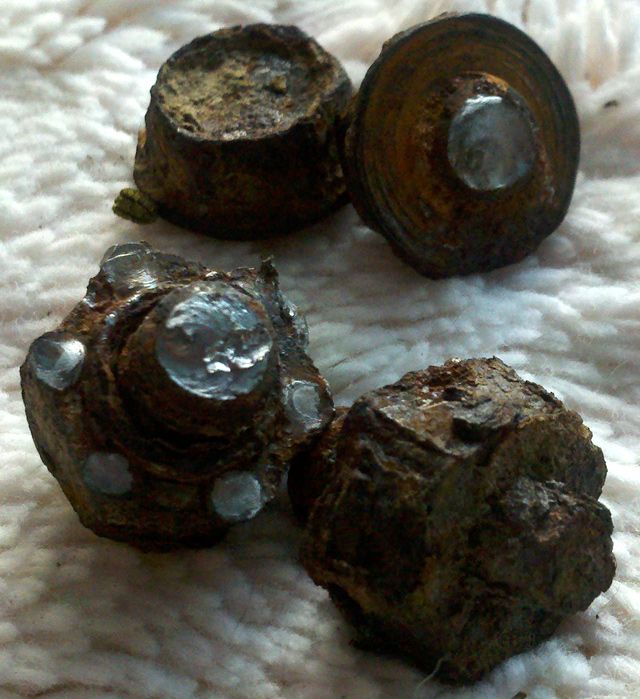

Sweating and swearing but when I'm done, every u-joint will be new. The two on the front axle were in awful shape. No needle bearings left in any of the caps, worsening vibes, etc. so it was mandatory to address them. The rest are a mixture of what I pulled out of the junkyard and new greasable Spicers, depending on which driveshaft you look at.

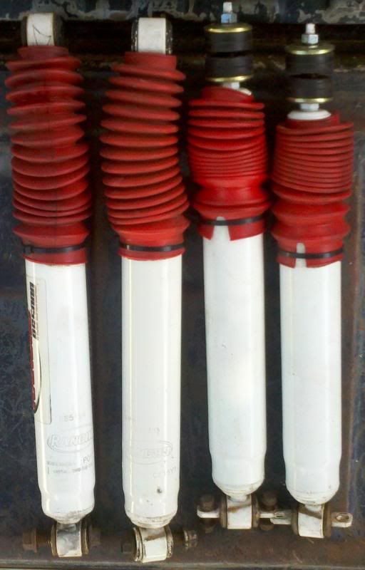

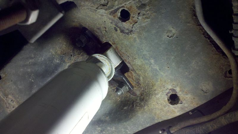

I have a buddy in the "I buy junk cars" business and he hooked me up. Had a ZJ with a 3" Rusty's kit on it that had brand new Rancho RS5000s on it. I was just going to resell them but after looking at the part numbers, the rears were the same and the fronts came in around 1" longer than ideal, so they should work too. If not, I have a couple other sets of shocks sitting in the garage.
The fronts were simple. Back when I added the 3/4" spacer to the front, I'd already broken and replaced the lower bolts and the upper nuts came off pretty easily.
I also lowered the front brake line about 1". I put the lip of the mount in the threaded factory hole and popped a self-tapper through the original bolt hole. The process could be repeated again if need be to bring them even lower.
For the rear shocks, I followed the write up at http://www.jeepforum.com/forum/f11/s...-heavy-323809/ and there was nothing to it. Took a couple hours to pop the bolts, pull the old shocks, clean and swap some components to my "new" shocks and clean up the tools.
All 4 bolts popped right off with a 1' ratchet and 1/2" socket.

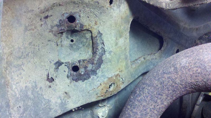

The factory nutserts drove out easily with an air chisel.
On the Ranchos, I had to drive out sleeves in the lower bushings and drive in the dog bones on the uppers. Silicon spray lubricant is your friend for that work!

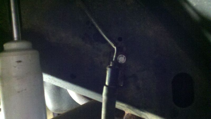

I used mechanical fingers to maneuver the bolts with washers to the holes. They dropped in easily. It took a little finagling to get nuts started without pushing them back in the hole but it wasn't a bad job at all.

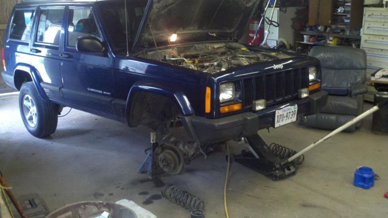

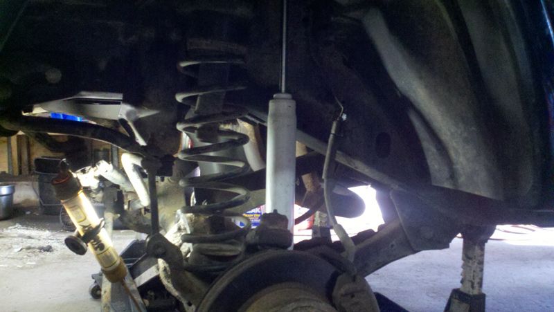

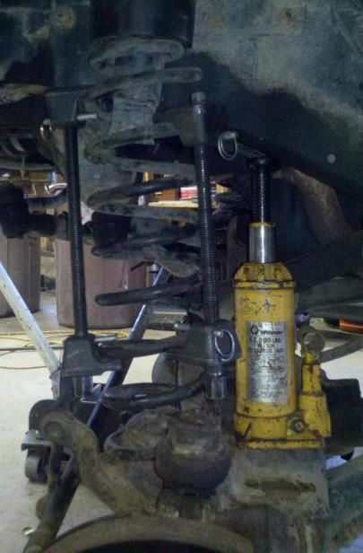

I finally installed my V8 ZJ front coils today for an extra inch. The ride feels unchanged and, although most people probably wouldn't notice it, it did have a slight rake without the additional lift. Now it's where it should be and I'm closing in on completing this stage of my build!
Most people suggest removing the shocks and track bar for full axle droop. After fighting to get the track bar aligned properly previously, I knew I had no interest in taking it loose again.
With that in mind, I began to experiment and found that this method requires little to no compression for stock length springs and most likely even beyond that. I removed both shocks to give me more room to work. After that, I jacked up the passenger side and worked the bottle jack in between the "frame rail" and upper control arm/axle area. Between the floor jack and bottle jack, you're able to freeze the axle at its maximum point of downward travel, minimizing the amount of spring compression needed for removal and installation. Exact placement will vary by jack model but I will definitely keep this trick in mind for any future work on coil-sprung vehicles.
The sun was setting, so the photo is dark but here it sits at a very comfortable height for the new 31s in the near future. Surprisingly though, even the 235s don't look too small at this height to me.
