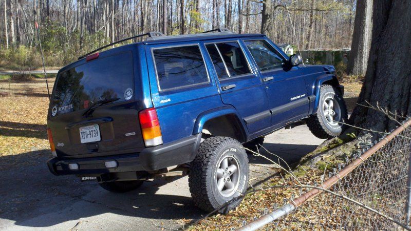

I've successfully test-fit a friend's 31s. Like most rigs my height, fender clearance was fine; just some rubbing on the lower control arm at full lock.
My build thread has pics again. http://www.jeepforum.com/forum/f177/kevin108s-2000-xj-build-867428/

They look good!!!

Thanks! I agree. I've never liked the BFG tread but almost everybody that has them is nuts about them so maybe I'm just wrong. If I can buy this set for a reasonable price to run for a while, I will. Otherwise, I'll probably order the TreadWright knock-offs. As much as I would love to go to the MT/R clones, I spend too much time on pavement to justify the additional cost and faster treadwear of the MTs. That idea is driven home even harder by the fact that I don't need an aggressive tread for what I'm willing to play in. I've never had issues wheeling where I have with just Michelin street tires.

31" tires look good on your xj man. and just wanted to say i appreciate the write up on the sye and driveshaft i am going to need a sye. going with iro sye soon. made up my mind on a sye after wheeling yesterday had very bad viberation coming from the driveshaft.

Thanks man! Yeah, I've been back and forth about getting to the point where they fit. I don't really have a use for them but it's where I've wanted to be anyway. Building the bastard pack and finding the existing lift put me past not wanting to lift. Good luck with your SYE install!
