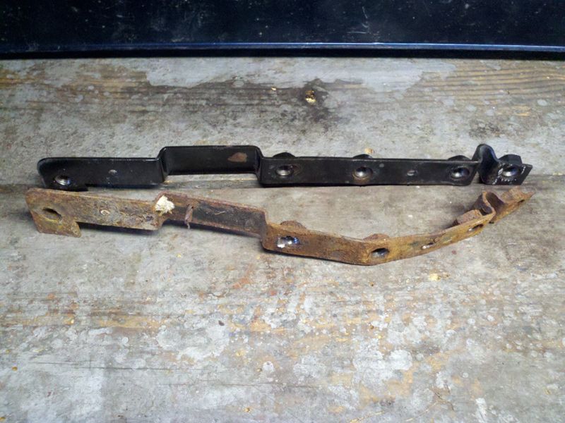

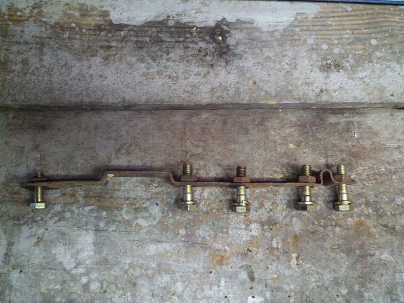

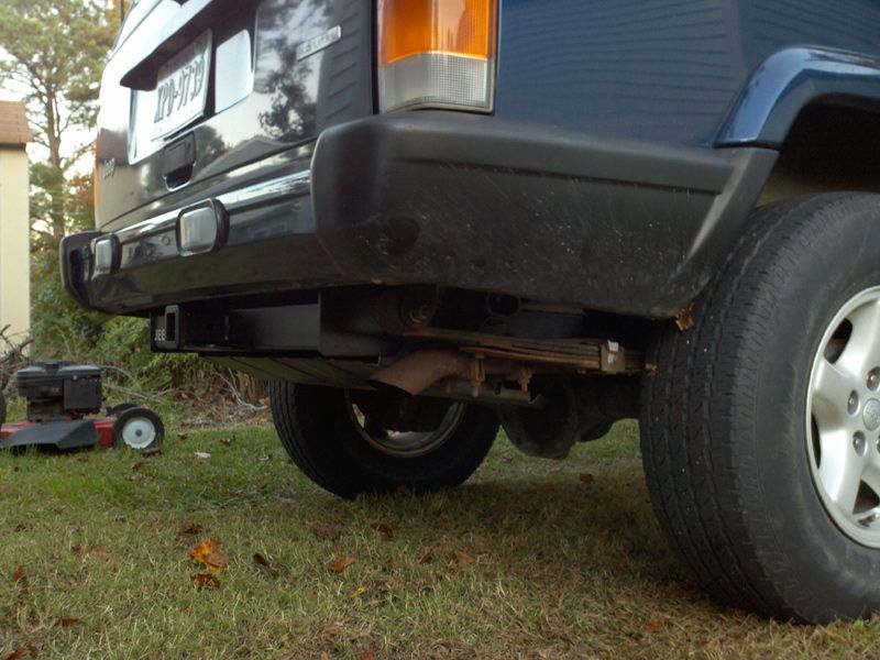

I pulled the rear bumper off last night to replace the nut strip and decided my high-clearance hitch will be fine. I also wound up re-using my original nut strip after some work.
It came out like this. (Yes, that's a broken drill bit stuck in it.)
To repair the stripped-out nuts, I tapped them out to ½" and bought some new grade 8 hardware.
It tucks up so much better!

Posts: 122
Pretty nice dude! Love those back-up lights tucked into the bumper like that. Leafs look like they're straighting out a bit though - that due to all the extra weight with your armor, or are you thinking about replacing them?
"If it rips out of the engine and starts preying on small mammals then its the 0331 head."
PAXJ98 is offline
post #235 of 640 Old 11-03-2011, 02:14 PM Thread Starter
Kevin108
Location: Portsmouth
Posts: 3,951
Thanks man! I love those lights. They help a ton and super cheap and extremely durable. The leaves are part of a bastard pack. I have a combination of 6 factory leaves - one full pack plus a main with the eyes cut off and a secondary. They look flat because the factory springs didn't have a lot of arch to begin with. The combination I'm running is giving me 2" of lift and an awesome ride. It's more lift than that but I have 4 tool boxes plus a loaded cooler back there. Since that's my normal cargo, I'm working off the lower measurements.
