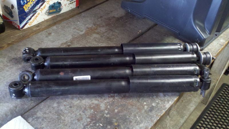

I put the word out with my local club and got the hook up of all hook ups: 4 like-new JK shocks for free!

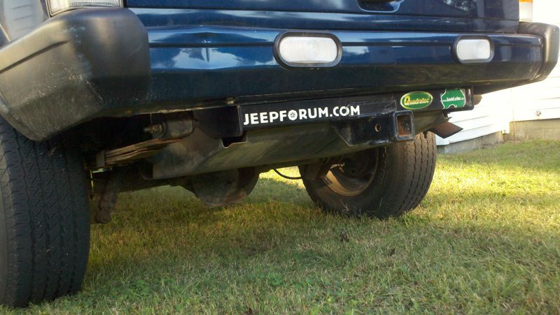

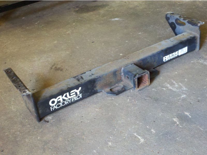

Scored a couple good items at the junkyard yesterday. Whatever I don't use, I'll sell. The first thing I grabbed was a Reese trailer hitch. I already have a Kurt, but the design of it has it hanging down pretty low and I always managed to plow a row with it when offroad. The Reese hitch will give me 2" more ground clearance and it's rated for 1,000 lb more than the Kurt hitch - not that I would ever two 6,000 lbs with a 3,000 lb XJ, but whatever.
The existing hitch
The new hitch

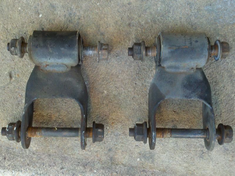

I also grabbed a set of MJ shackles. I may use them over the Rough Country shackles when finishing up my lift. I'll see what kind of height I end up needing in the end.
