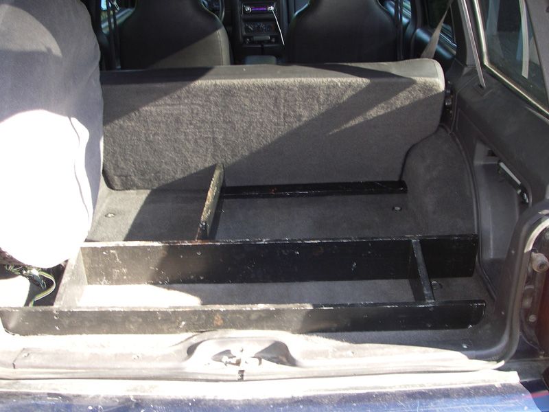

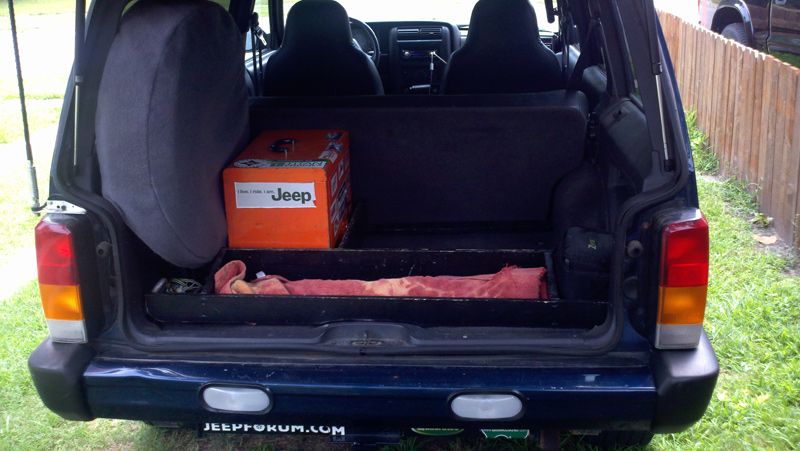

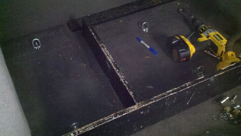

The divider that keeps everything from sliding around.

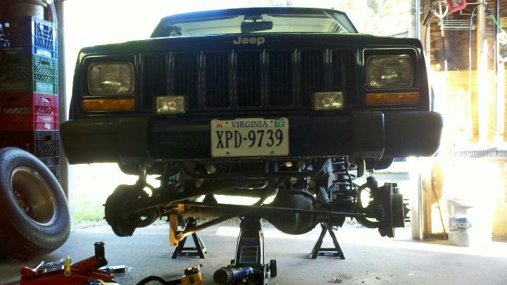

As it sits right now, with my front driveshaft in the towel.

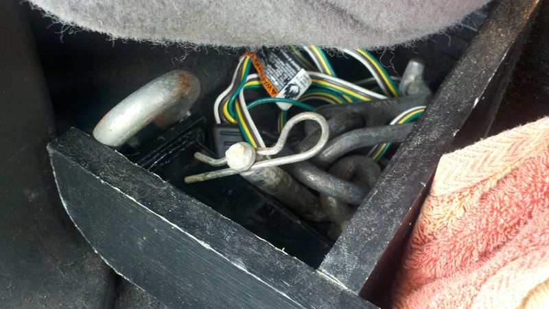

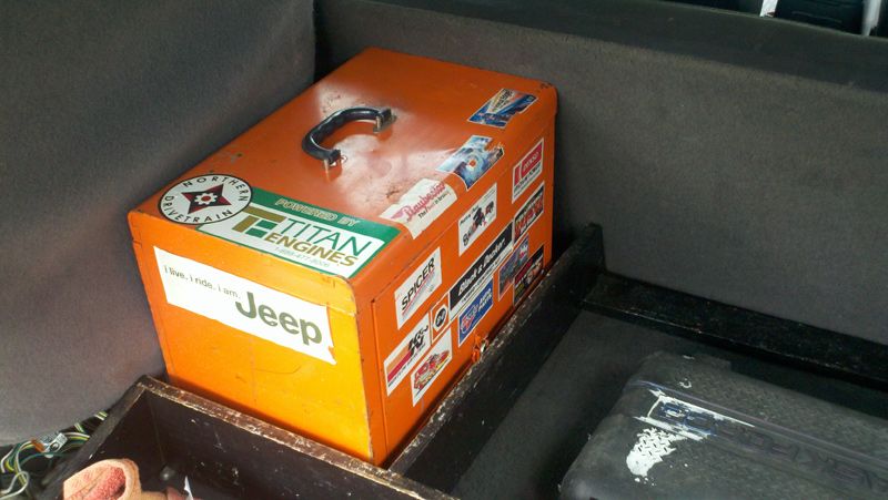

My bag of tricks with everything from jumper cables and spare sensors to extra food and clothes.
Some recovery goodies.

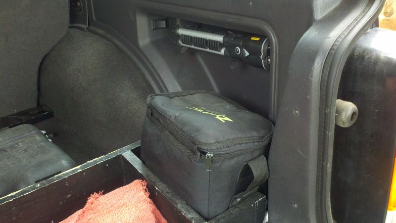

Toiletries and first aid, tripod flashlight, and a switch to turn the interior lights off and on.

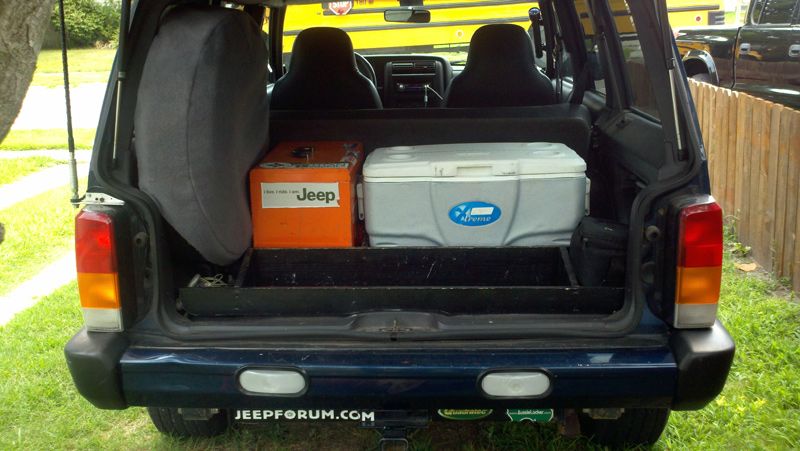

The typical arrangement.

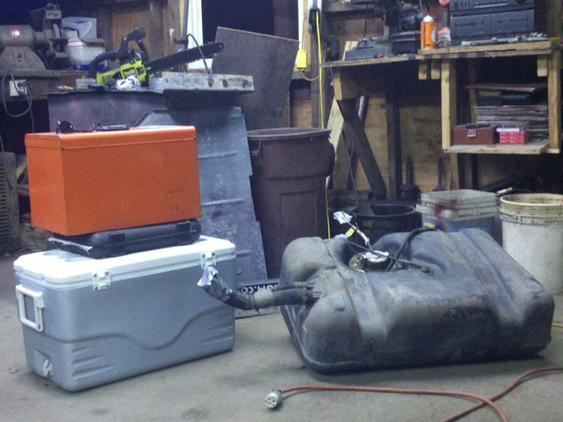

Today my fiance and I went to Carova Beach. The trip down was slow an uneventful. The beach was more crowded than I've ever seen it and they have a silly rule now that the dune and water lines are paths of travel. That means you have to park in the middle and to get in the water, you have to cross "the road". When it's as busy as it was today, it's a very dangerous arrangement.
The trip home got interesting as soon as we got off the beach. I stopped at the first gas station for Shannon to change clothes while I pumped the tires back up. I opted to use my new Viair 85p but when I cranked the engine, it turned very slowly a few times until I got a little smoke show from under the hood. I quickly opened the hood and another Jeeper parked next to me was like, "Dude, you got a fire!"
By the time I realized where he was talking about, it was out. Apparently I have a compromised ground somewhere and the starer was grounding through the thin braided ground strap that goes between the head and the body. It was draped on top of the wiring harness and burned a hole in the plastic conduit. (Pics later.) I took it loose, cleaned it and the bolt going into the firewall up, and it cranked over beautifully.
We left there, drove back to the bypass, and stopped for lunch. Leaving the restaurant everything went smoothly. I spent the 2-hour ride home relaxing with cruise control, AC and my iPod plugged into the receiver. Just as I got off the exit to go to my house, I lost engine power. I checked the horn, still had juice. I rolled down the windows, dropped in neutral and tried a few times in vain to crank the engine. I told Shannon to hang on as we took a turn a little more quickly than normal. I was able to maneuver us into a driveway for a used car dealer, onto the sidewalk and between a telephone pole and a fire hydrant, all without power steering, to park us in an empty parking lot, making it safe to me try some quick fixes and easy for the wrecker driver to come get my unreliable POS.
It's sitting at my parents' house now. I'm suspecting the fuel pump as that's the only part I haven't replaced yet. I'll do a more thorough diagnosis tomorrow.

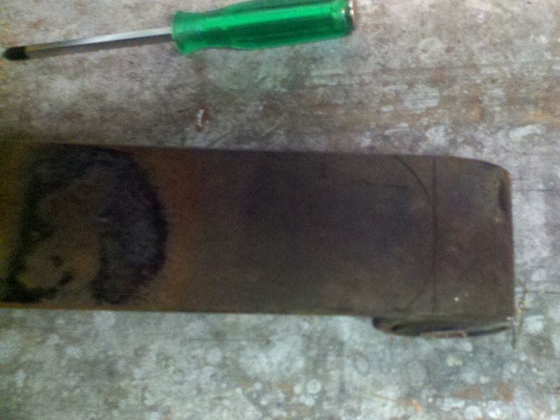

Tonight I started cutting up my spare stock XJ spring pack to build a bastard pack to level my rear springs back to stock height or there abouts. If I wind up with some lift, that's fine too, but that's not my goal here. My goal is simply to bring the rear up level with the front while maintaining that flexy, cushy stock ride.
The center of the spring eye is where the main spring starts to curve. I marked this with a speed square and a nail.
Illustrating verification for where the start of the curve.
I then drew a straight line all the way across the leaf.

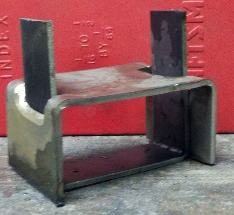

This is the basic pattern for my homebrew spring clamps. I used 1/8" flat stock in 1" and 2" widths. The 1" stuff has a center size of 2-1/2" and the 2" stuff fits over that, coming to 2-3/4".
Notching the 2" stuff is slow and tedious but for $12 worth of material, the price is probably tough to beat.
Once I know the size of my bastard pack, I'll trim the legs of this stuff down accordingly.

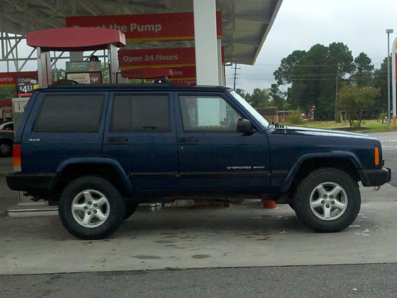

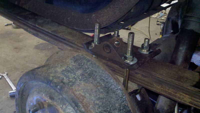

I finished my bastard pack yesterday. I got some great info from this thread while a printed copy of Skyjacker's standard AAL installation instructions helped as well.
I swapped out my Rough Country lift shackles for the stock XJ shackles. From there, I assembled everything finger tight with the used main leaf, minus the spring eyes, as a full-length AAL. That left me 1" low in the rear still. I considered reinstalling the lift shackles but I decided I wanted to go ahead and do it right. I bought some longer u-bolts, going up from 7/16" to 1/2" diameter and installed the 2nd longest leaf as well. It was strange going from a 4-leaf pack to a 6-leaf pack but it did the trick. (Yes, I cut the bolts down.)
My homebrew spring clamps came out great. When I made them, I measured the stock spring pack and added 1/2" to allow for 2 extra leaves should that be necessary. I had assumed I'd have to trim them down after installing the single leaf but as it required 2, the clamps worked out perfectly.
I'm sitting on empty and didn't have my loaded cooler in the back, but it's sitting 3/4" higher in the rear than the front now. Previously it was over 2" low in the back. I'm going to give everything time to settle but I wouldn't mind throwing a 3/4" spacer up front to truly level it out. That should give me adequate space to go up to 30s when I buy tires. I did discover I'm missing both rear bump stops, so I need to figure out where to order them from. Here's a shot as it sits now:
The ride is practically unchanged. It's slightly firmer, has a lot less body roll, but is every bit as comfortable as you'd expect for a SWB rig with a leaf-sprung rear. And even with the extra leaves and the rear sway bar still attached, it seems to flex as well as ever.

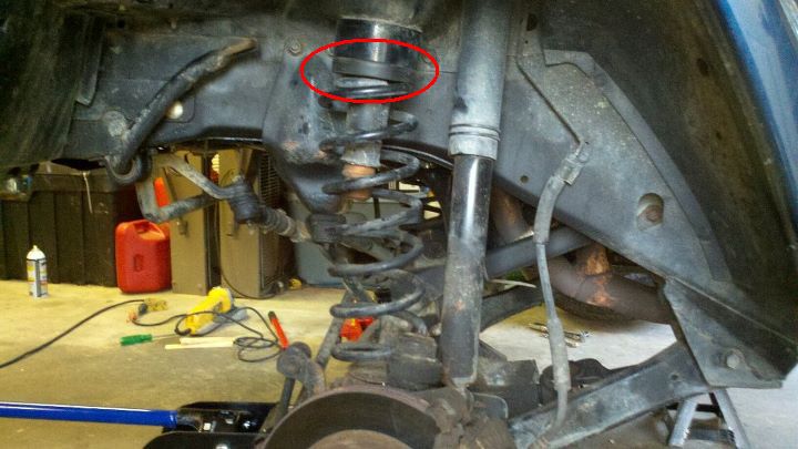

Today was a busy day. I finished installing my new rear bump stops. When I built the bastard pack, I realized one was missing and one was hanging by a thread. The gas tank had started leaking when full so I dropped it and installed a new fuel filter and gasket. While I had the tank down, I took the opportunity to install the heavy-duty tie downs I've had for 2 years or so as there was no easy way to install them securely that didn't run the risk of poking something into the tank.

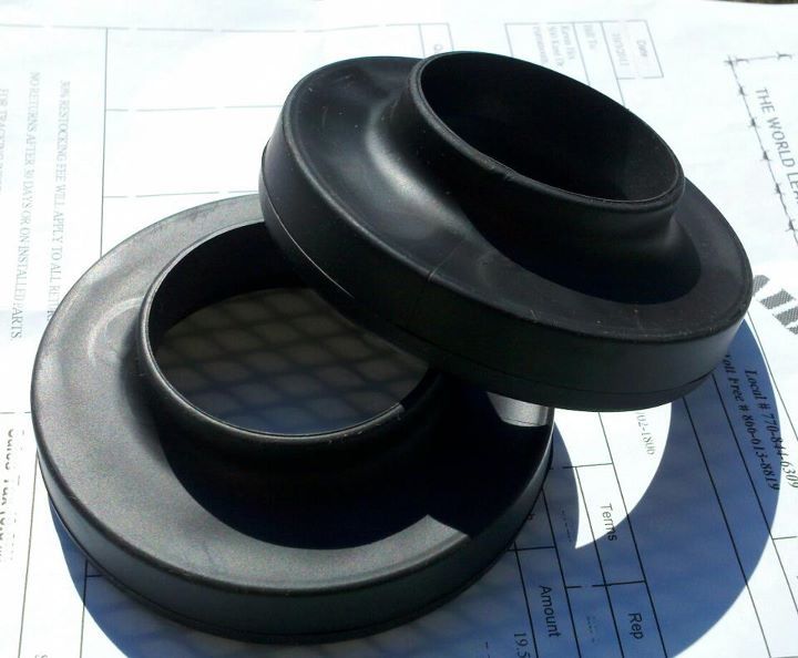

The only thing I have left on the short list is to order some 3/4" coil spacers to level the front up with the bastard pack. I'll order them the first of the week.

I'm planning on a wheeling/camping trip sometime soon so I thought I'd throw together an extension for the cargo area that fills the void when the rear seat bottom is removed and the front seats are slid all the way forward. When there's any weight on the passenger seat back, it lays flat.
I think with this, I could pile some blankets and sleeping bags in the back as padding and me, maybe me and my fiance, could sleep pretty comfortably back there.

My spacers for leveling the front came today. Generic eBay specials for less than $30.

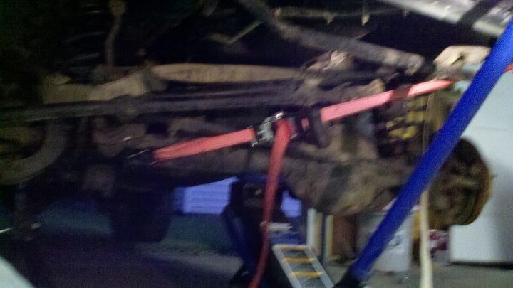

Shocks, springs, sway bar and track bar undone.
I had to rent some spring compressors from AutoZone and it still took some pry bar work to get the springs out and in.
It took two ratchet straps and the jack to get the track bar lined back up.

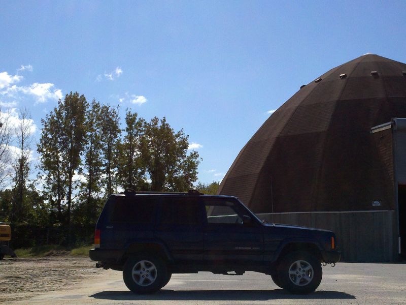

Took this shot at work today. I think it looks great leveled out! Think I have room for 30s?
