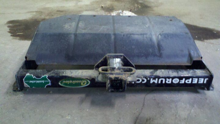

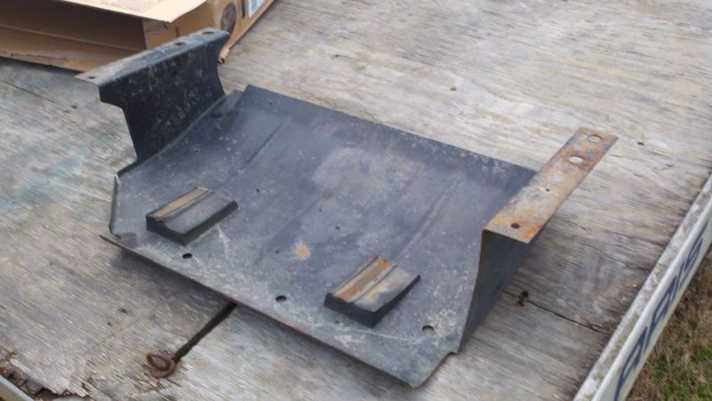

I won an auction for a stock Grand Cherokee gas tank skid for 1¢ last week (with shipping it was $27.16) and it showed up Saturday in fine condition. I'll install it maybe this weekend.

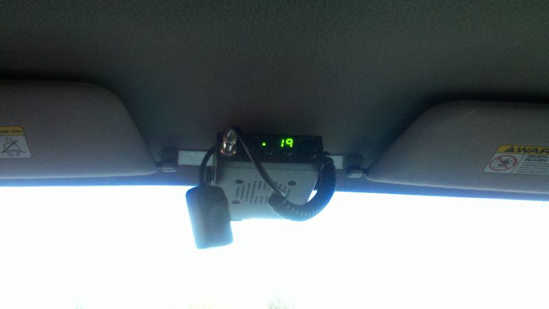

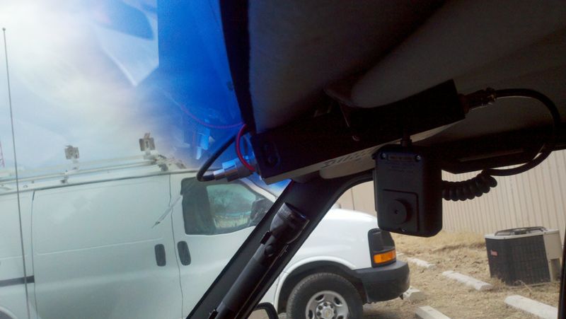

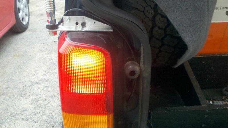

Saturday was also when me and my buddy Ray (willet over at fullsizebronco.com) finished up my CB installation. He is fresh off a full body swap on his white OJ Bronco so he's well practiced with interior trim panels. An extra set of hands is always of good use but having someone more capable than myself doing the stuff inside was a huge help. I'm very fortunate to have the friends I do as we all have 4x4s and are reasonably gifted when it comes to turning wrenches. Anyway...
I had already mounted the radio between the visors with some aluminum flat stock I had. I made it end flush with the visor clips and it provides a very simple and sturdy mount for the small, lightweight radio I chose. Despite his gifts with plastic trim, Ray was no so talented at leaving my rearview mirror attached but that's an easy fix and it not being there gave us more room to work so I'm calling it good.
Unless I'm on the trail, the mic will be in the center console. The power and antenna wires tucked up easily and cleanly into the headliner and the tint gradient at the top of the windshield almost makes the radio invisible from outside. Not pictured but for power I ran the wire down the passenger side A-pillar, underneath the dash and spliced into the passenger side 12v plug.

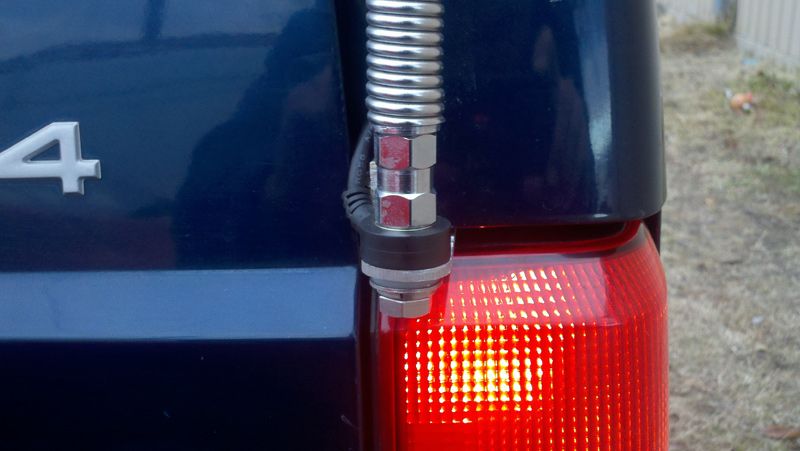

I had purchased a Firestik SS-174 no-drill fender mount that attaches to a stock fender bolt and protrudes between the hood and the fender but the tall antenna up front looked out of place. The antenna is a Firestik FS3 mounted on a Firestik SS-3M spring. It was very easy to assemble and tune. I borrowed a SWR meter from my brother in law's grandpa and tuned to just under 2, averaged out between 1 and 40.
I made my own interpretation of a rear mount I've seen a few times here. Usually what I've seen was just some angle iron bolted over the tail light but I like radiuses and working with aluminum.
I'll fab something more substantial at a later date. I've also secured the coax at several points. The coax was from Firestik as well. It runs inside through the plastic grommet, goes up the rear pillar, along the drivers side ceiling trim and behind the drivers A-pillar into the headliner. I left all the slack of the 18' coax at the rear so I have plenty of adjustment for the next mount I make.
This was my first experience with CBs and the parts I bought and everything I did was based on what I'd read at http://firestik.com I'm very happy with how it turned out. What I ended up with was similar to the kit Quadratec sells for $140 but I got better quality components plus a spring for about half the price by building the kit myself through eBay. Bear in mind the radio and antenna mounts, installation and tuning were free but I've only got $77.68 into this setup.
I just wish everything I did to my Jeep was as cheap as the skid plate and CB have turned out to be!

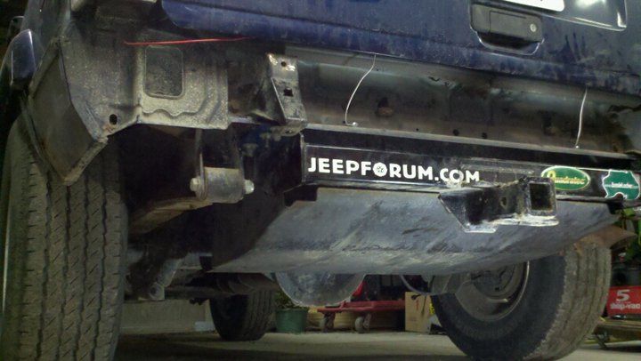

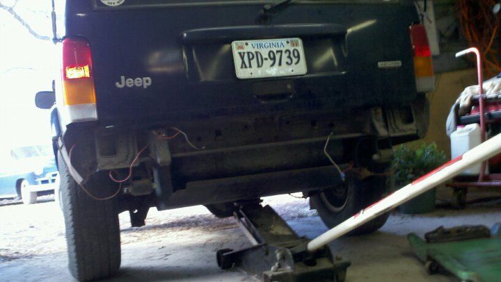

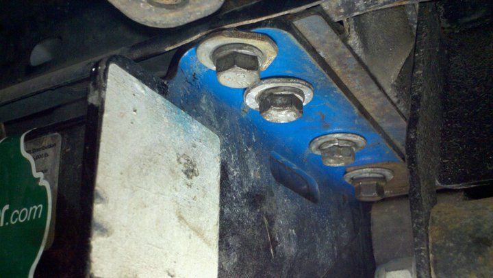

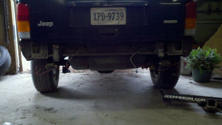

I backed into the garage late this morning not knowing what lay ahead of me

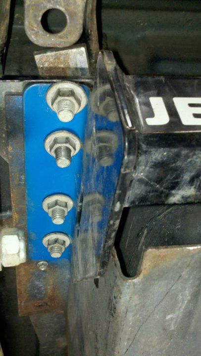

I dropped the rear bumper to make dealing with the bolts easier and to finally secure the wires for my auxiliary reverse lights.

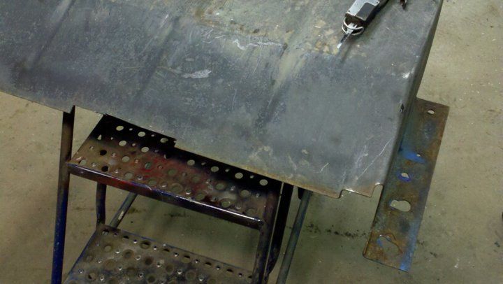

I test fit my hitch around the skid.
It took a few tries to figure out the best way to use my third hand. The skid didn't go up for the last time until after dark.
I had to trim for the hitch and wallow out a few holes to make lining the bolts up possible.
The driver side frame rail had bolts hanging down that you could push up into the frame and lose.
The passenger side frame rail has a plate with nuts welded to it floated around inside the boxed frame because I've previously broken the rivets.

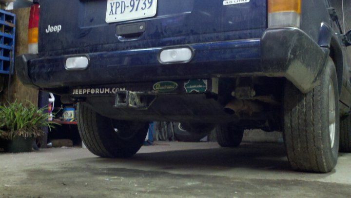

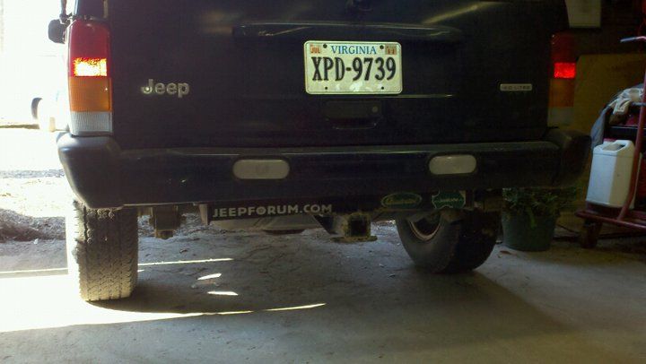

It was a complete ***** but with Dad's help I finally lined up 8 bolts and 24 holes at one time for a successful installation.
And now the gas tank is ready for the rocks. The tail pipe rattles against the new skid plate so some exhaust modifications are going to be necessary. I'll probably add a Dynomax Super Turbo at that point.
