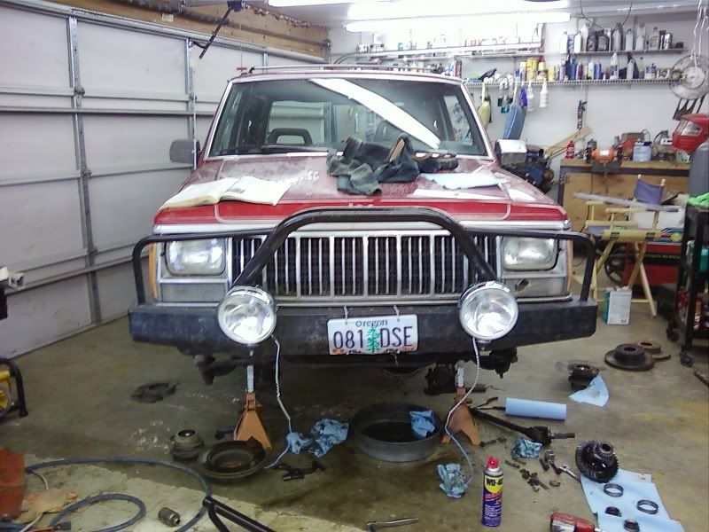

Make a mount for them on the front of the bumper. That's how mine are set up, and they are easily 4 inches deep, probably more. You can kinda see what we did here, and how big the lights are. I can give you a more detailed explanation if you'd like.

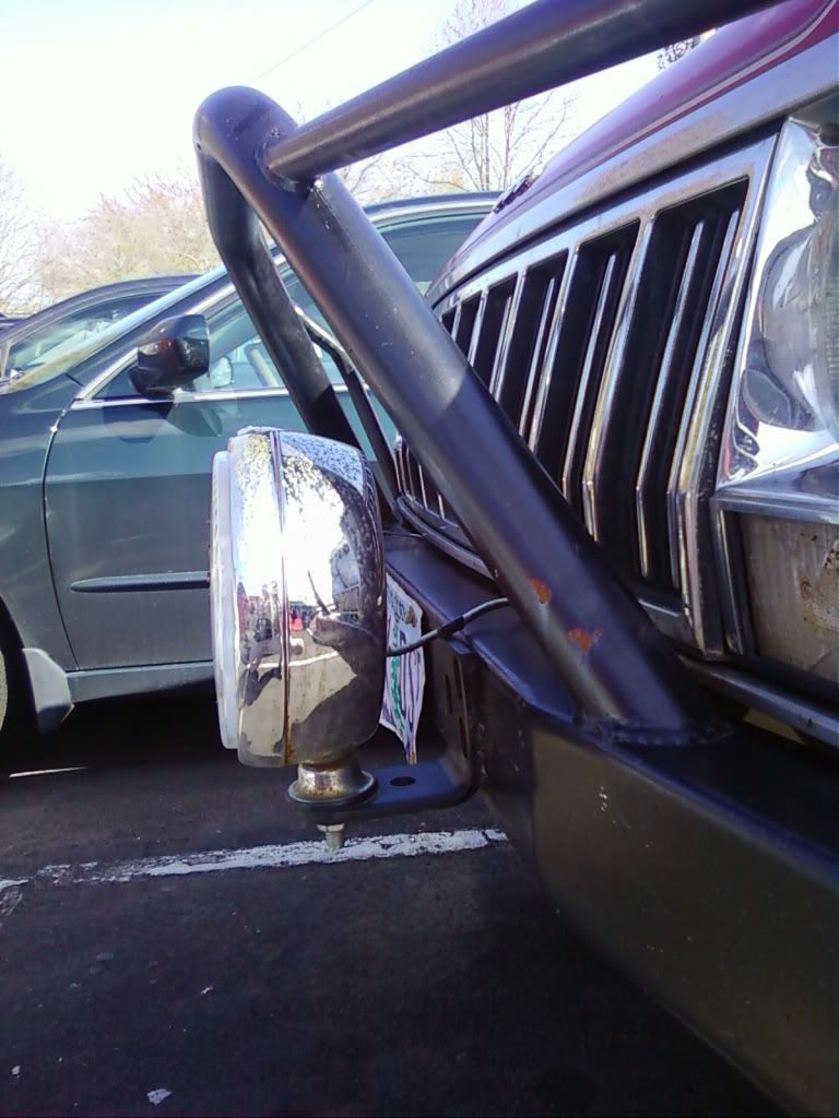

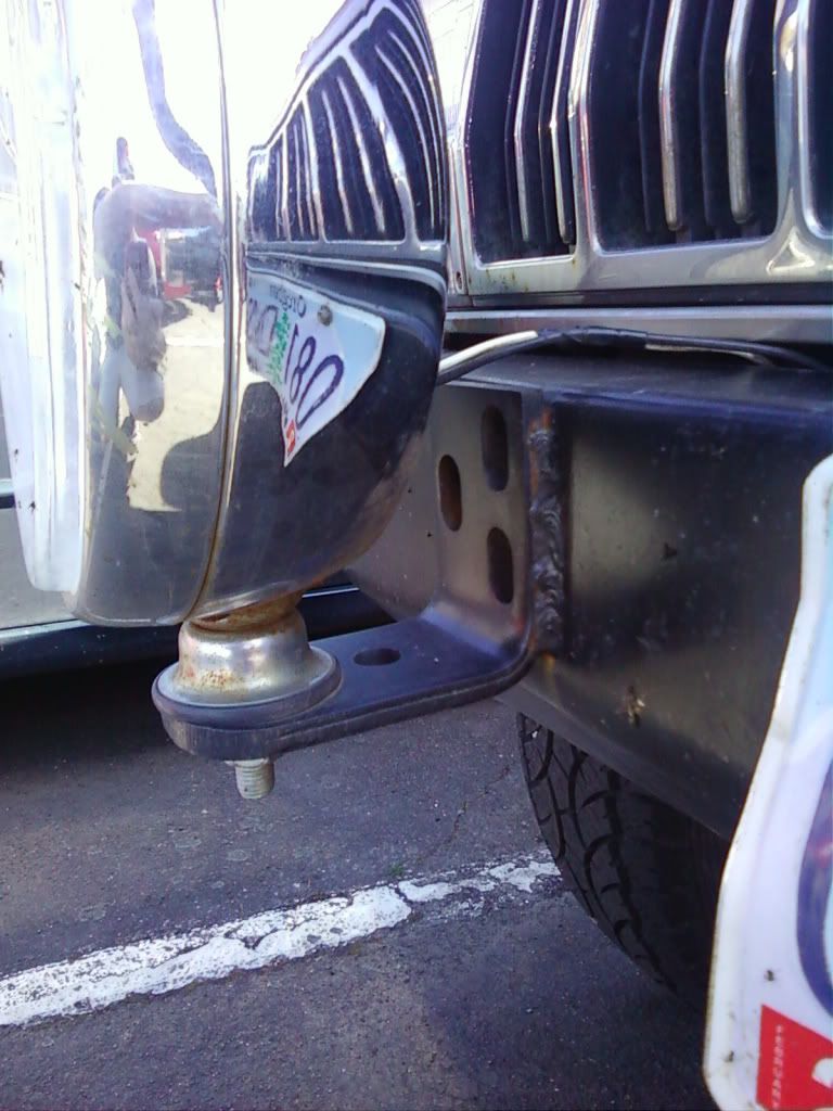

I got some better pictures of what I did. Fairly simple, but very effective.
