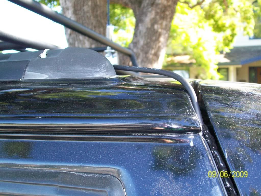

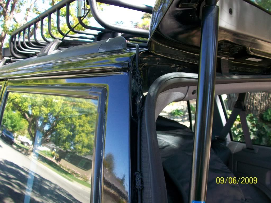

The summer after I graduated I got 4 KC 35 series lights for the roof and 2 KC 26 series fog lights for my brush guard. The fog lights were pretty straight forward and also liked how they came with 3 pairs of different lenses (2 amber, 4 clear), but wanted to make sure my roof lights wouldn't leak water inside and it took me about a week to figure it out. I did not drill any holes in the roof or anywhere that could leak water which was a concern of mine when I installed them. It hasn't leaked anywhere at all even when it's gone through an automatic carwash. (Note: I have pics of the driver's side but it is exactly the same idea for the passenger side)
Here's where the wires go over and under the gutter:
With the door open, I used black silicone to keep the wires in place and it's right where there is a gap above where the door meets the door seal. Then down through the hollow part of the weatherstripping:
The hole I ran the wires through into the fender from the weather stipping. The hole was pre-existing:
The wires coming from inside the fender. I drilled two (I believe) 3/8" holes and put a rubber grommet in them:
The holes I drilled through the driver side fire wall. One for my fog lights, and one for both pairs of roof lights all with rubber grommets:
My lazy, but reliable way to run the power for the lights and switches. The wiring harnesses that came with the lights already had a relay and fuses as a part of it so I didn't need to add my own:

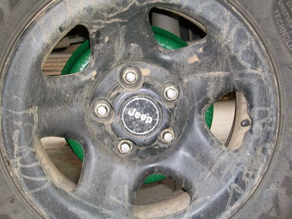

After I got my lights working, I decided to paint the stock steel wheels black with Krylon Fusion Satin Black. Before I did this I went to a pick n pull to see if I could at least find a wheel from an XJ and just happened to find one to match my stock ones. So after cleaning/prepping all 5 wheels I painted them.
Before:
After:

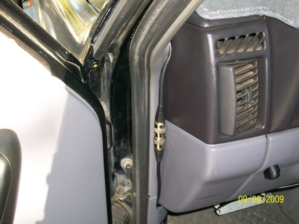

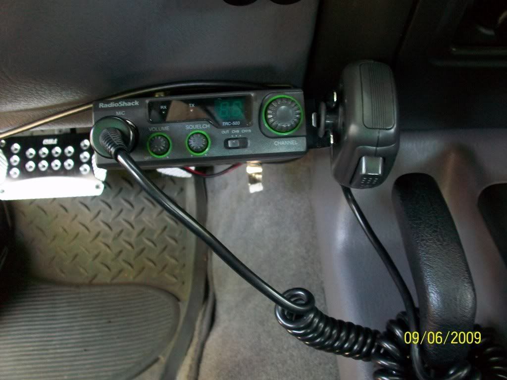

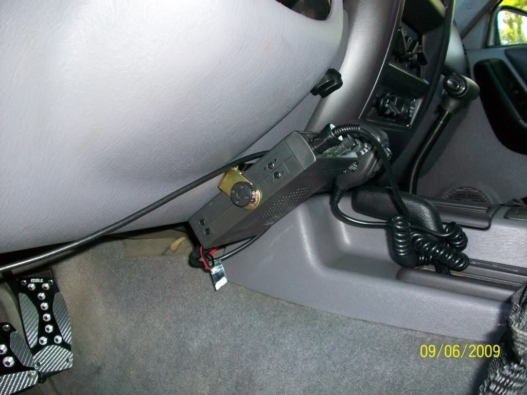

Then came the CB radio. I got a Radioshack CB radio for about $50, b/c it was the only one that had the dimensions I needed and heard pretty good reviews from a couple people I asked about it. I also got a Firestik No Ground Plane 4' Antenna kit, since I wanted it mounted on my rack and wasn't able to get a decent ground with a normal antenna.
Pic of the antenna mount:
Where I ran the coax cable:
I ran it up and over the windows on the right side and down the driver's side a pillar.
Since I still had the original antenna and mount I bought, I decided I’d mount it on the other side so it looks like a have a dual antenna set up.

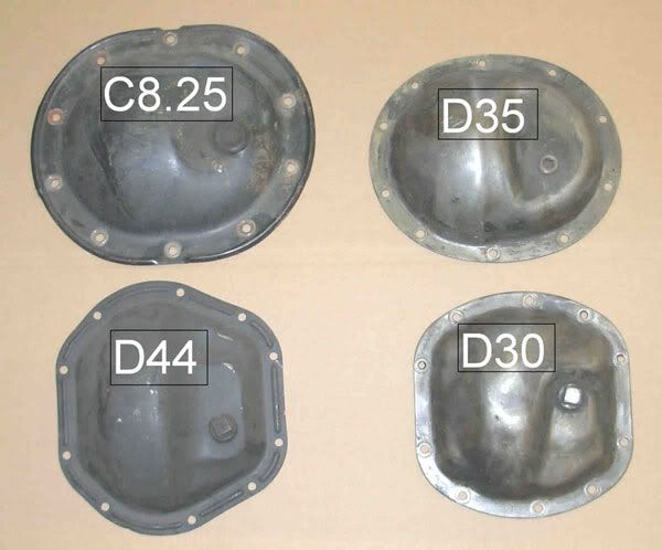

Then for a while I didn't really do anything to it. I did try to figure out what my rear axle was which took me a while and then with the help of this
I was able to figure out I had this
A Chrysler 8.25

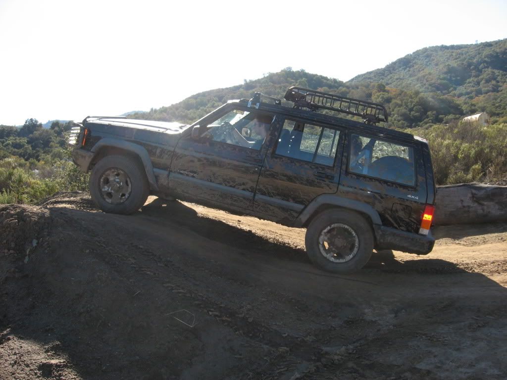

This is from my most recent wheeling trip from October

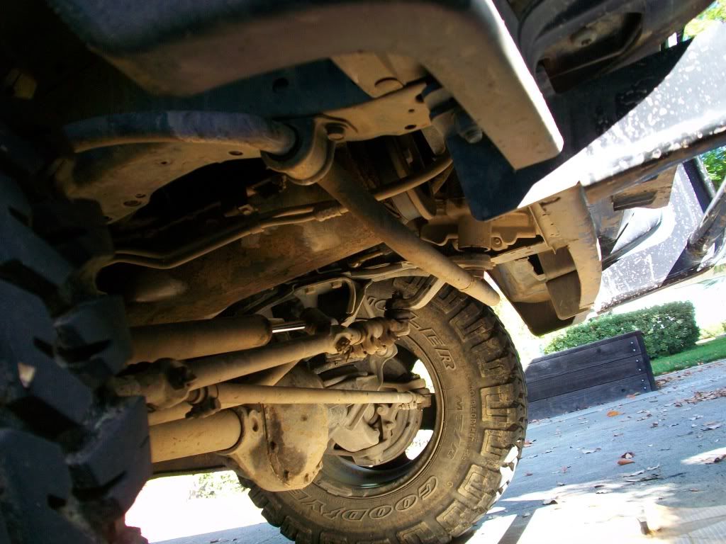

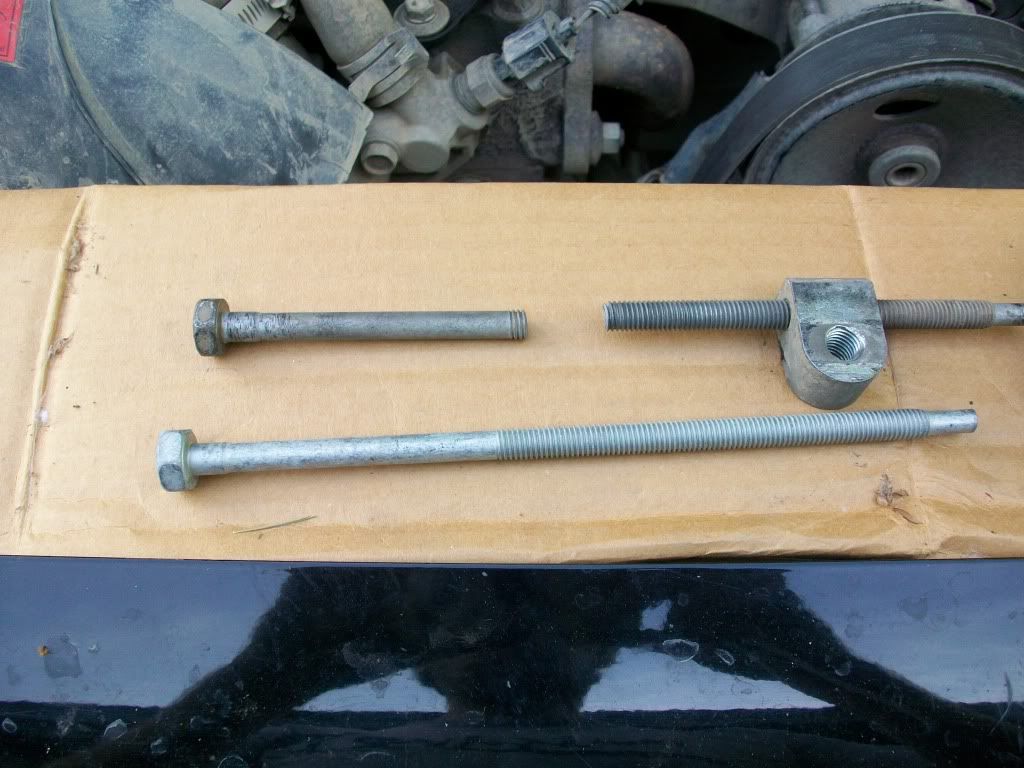

Then it was another few months of nothing, and then this happened:

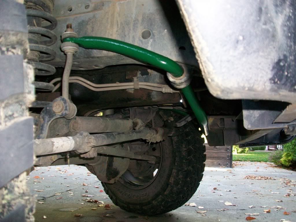

The idler pulley adjustment bolt for the fan belt snapped so I had to get a new one.

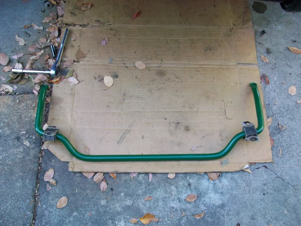

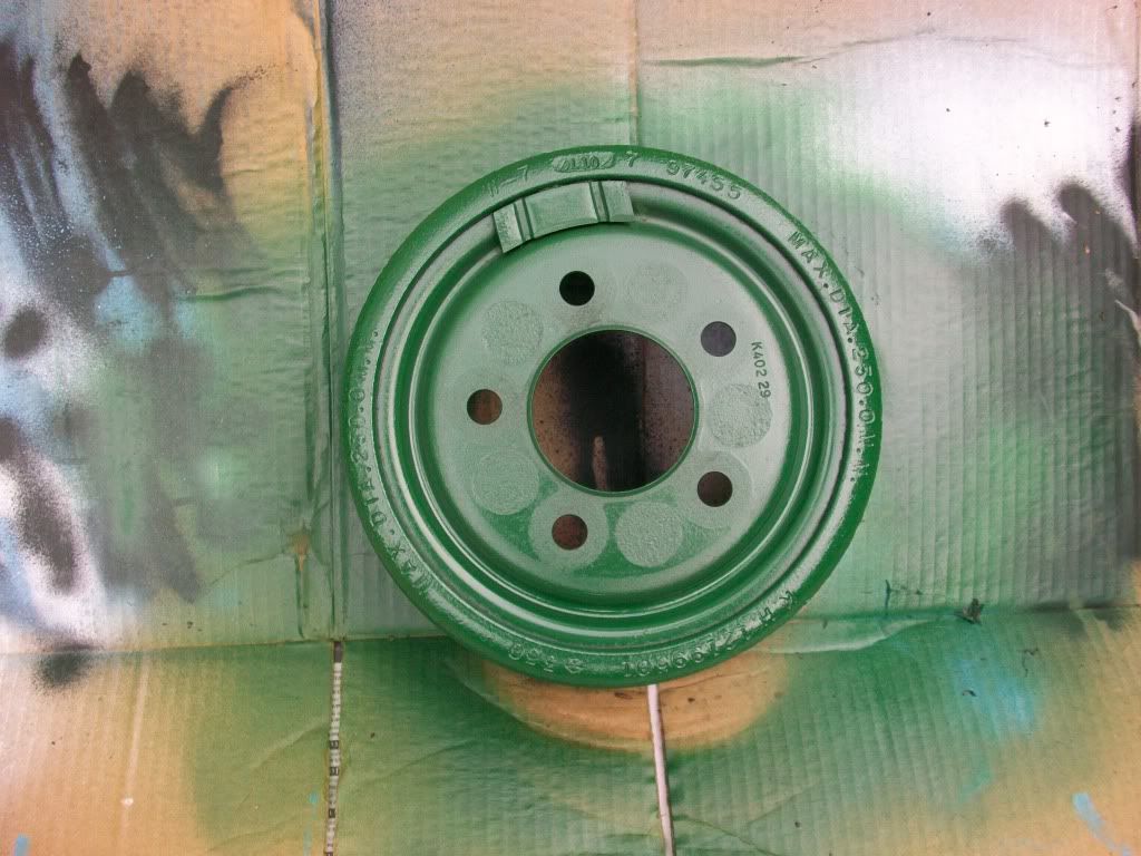

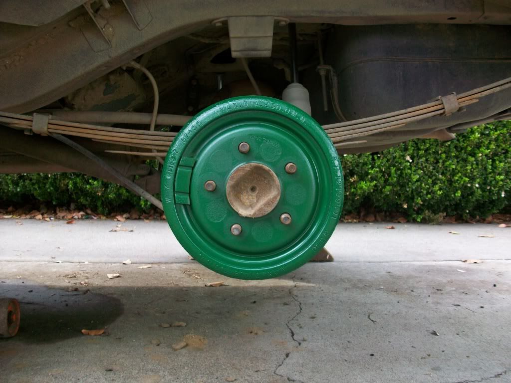

Then when I was bored I got a can of green spray paint and made my sway bar go from this:
To this:
About two weeks ago I remembered about that can which was still pretty full and did this:
