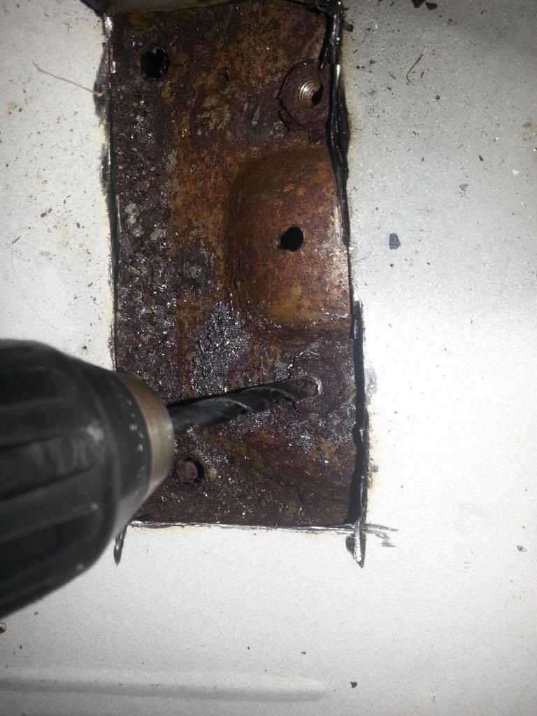

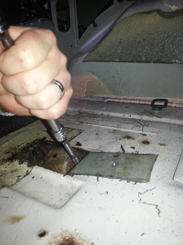

As I mentioned I broke most of the bolts while removing the old hardware to install the lift. I still have a few items to button up to complete the install mainly the rear shocks. After looking through the forms I decided to take what seemed to be the easiest method to getting the broken bolts out of the upper rear shock mounts. So I started by removing the rear interior trim which requires removing the seat belts (I recommend a big breaker bar for this). Then I pulled the carpet back. Once the rear was exposed I drilled pilot holes from the center of the shock mount from the bottom up into the cab. I then measured the mount and transferred the measurements to the inside of the Jeep using the pilot hole as the center guide (see the pics below). I then cut the area out and began soaking the top of bolts with PB blaster. I now just have to extract the bolts (still working on this).

Spent last night drilling and taping the upper shock mounts and finally got the rear shocks installed.

I did the rear shock bolts that way on my first XJ, it was a huge pain. When my last XJ snapped those bolts I did it a bit different and it went much smoother. The weld nuts up there are just tacked in so I knocked em out with a hammer and punch and fished new bolts in with wire. Was done in 20 mins lol. I wish I had known that the first time.
