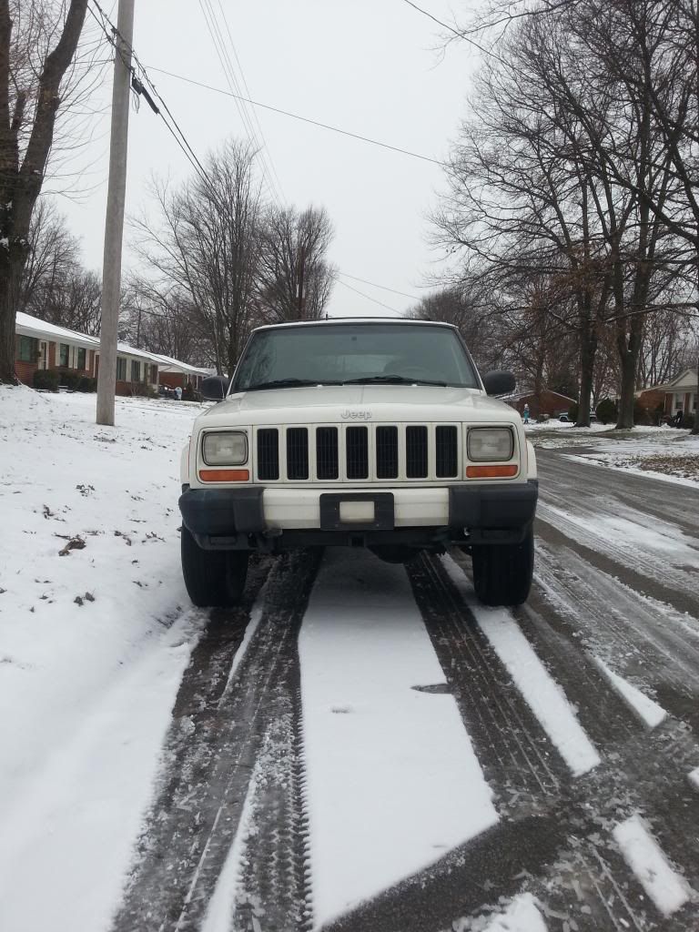

I picked up my 2000 XJ this February.
[IMG][/IMG]
[IMG][/IMG]
