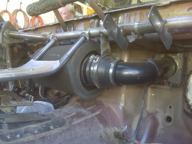

Originally Posted by DualPurposeXJ View Post
Ya it should help but what I would recommend is to re-route the intake into the cab for cleaner/cooler air
like so
loud, lol
