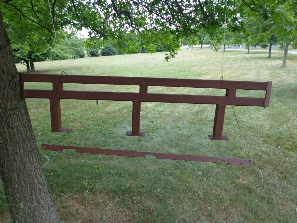

theres no need to use self tappers!!! I built my own and used a long enough grade8 bolt through the frame. I have three "legs" and two bolts per leg. you can see the mounting plates here. On the back side i used a flat stock the same size as the outside than a lock washer and nut. The rear leg is bolted through the frame than one bolt going into the front spring hanger.

I hope you plan on using a sleeve on the inside of the framerail so it does not crush

No need to sleeve it. The pressure from the tightened bolts is exerted over an area large enough that when properly torqued it wont cause a problem.
Keep telling yourself that
Lol your a special kind of stupid aren't ya. Eventually they will collapse the uniframe. I haven't done my Xj yet but I completely cut out the rockers on my Zj and replaced them with 2x4 and 2x2 directly welded into the a b and c pillars. I have yet to have a single issue.

I gues none of you have done the mechanical calculations on it have you...Iv had a very well respected and experienced Mechanical engineer do the calculations on it.
The calculation is, you won't be able to get the right torque on the bolt because the uniframe will be crushing.
We've been working on and playing with XJ's for 10 years. We have first hand experience with the uniframes crushing when bolted through without a sleeve.
The gains you think you are making by skipping "self tappers" is moot. The strength of the sliders comes from the winch seam mount.
