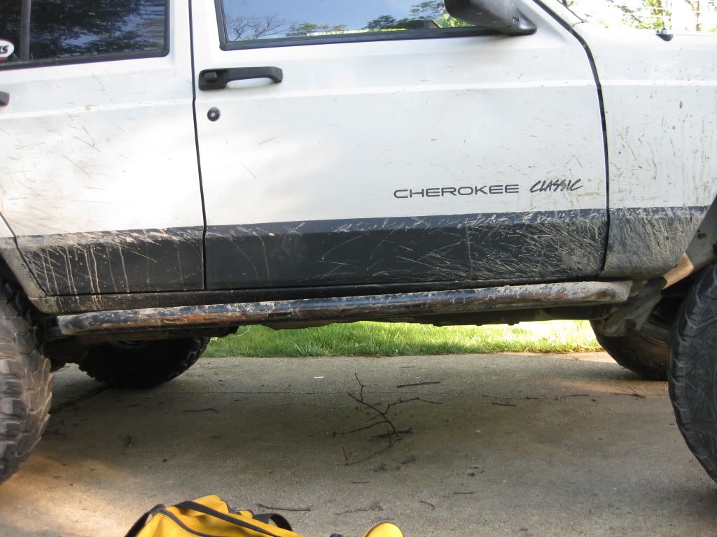

I'm sure they work great for blue trails or guys that want a hardcore look that don't really go hardcore wheeling. You're mounting to a soft spot on the body basically. That pinch seam and 'frame tie-in' doesn't do much, if anything to make them stronger.
The best review of them I've seen say they didn't fit well for install, the guy had to weld them on instead of bolting. Then they taco'd the body on the first hit and prevented the door from opening. On the same spot, he said the normal type sliders under the rocker panel held up just fine, and a guy with no sliders at all just got a small dent in his rocker panel.
Again, it's a great idea and they look really nice, but I wouldn't trust them to a hard hit without some serious internal bracing. I'd be fine purchasing them if they had some ribs on the inside and you had to cut out the stock rocker panel to install them.
Here is what happened to my normal rock rails after a few seasons. Shows you how stout the pinch seam and rocker panel are...
X2, it doesn't take much to dent the factory rockers. I would not want to "skin" the rocker with heavier metal that will just push in on the first hit they take. Google those rockers and throw "Pirate 4x4" into the search. A guy on their didn't have good luck with them.

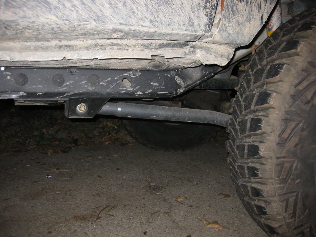

I like how they look, But I went with Rigidco Rx22 Sliders on my XJ you have to make 2 small 1" cuts on the pinch seam for the legs to tuck up into then they bolt to the uniframe and pinch seam. So you do not lose any clearance under the pinch seam like most sliders, and the bottom of the slider acts as a skid with the tube being on a 45* angle it keeps you off your doors .
Rigidco Rx22 Slider Pics:
