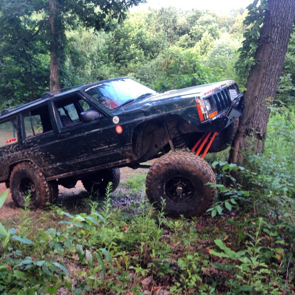

Long time, no update. However, work has been put in and it's drivable and wheelable! Balanced the tires with airsoft BB's and built a better track bar bracket (no pics) than the Rubican't Express mount. Got the new shafts in and installed....
Climbed a tree....
And the did the unthinkable....
I put some flares on the front. The front stuck out almost 8" past the fenders. VA law says no more than 4". I could maybe get away with it, but I really just rather not be hassled. It's right at 4" in the front now. I zip tied them on for quick disco action/ break away action WHEN a tree or rock rips them off No, I don't like them, but as long as I can drive it to wheel somewhere, I'll be happy.
