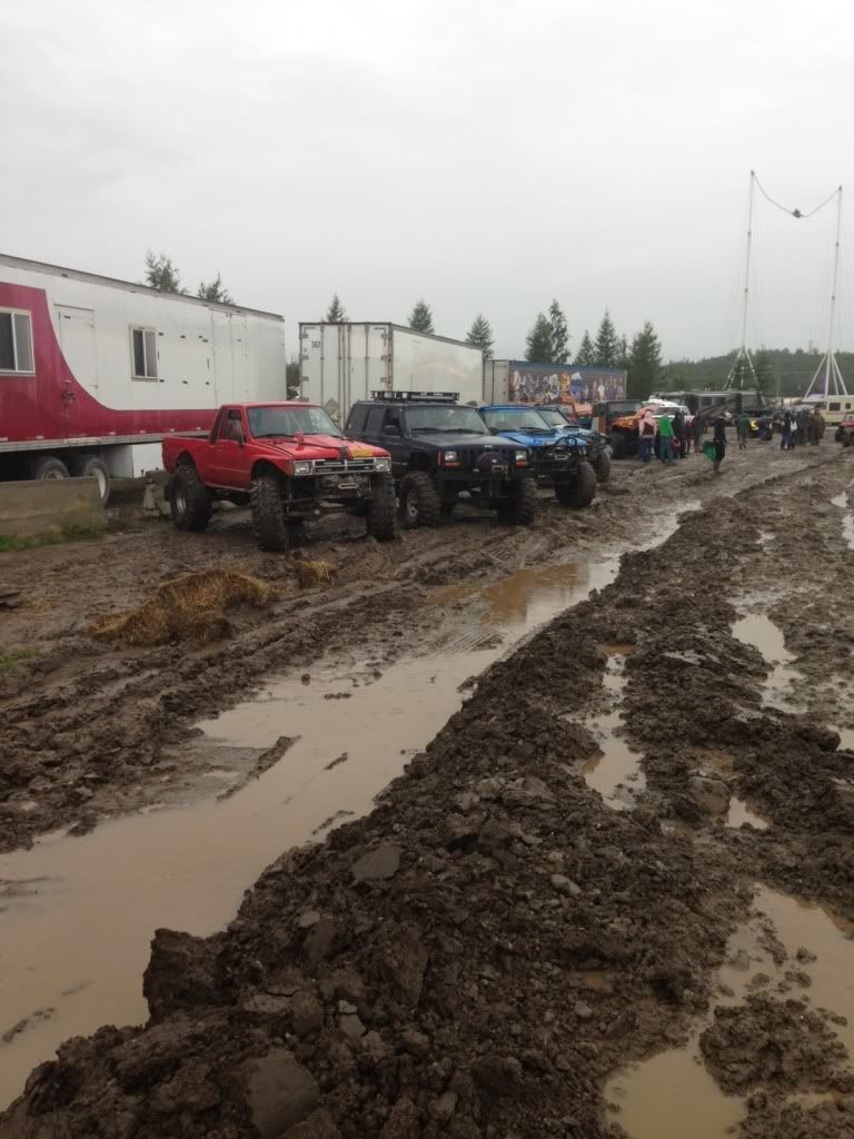

Here is a picture of the Toyota's and my "Grand" Cherokee. That red truck is pretty bad a$$. Tube frame and King air shocks. Ruff Stuff hand fabricated axles, front and rear. Supercharged V6. Brand new 40" Super Swampers. He has more money in one axle than I do in my whole rig. All the Toyota's had tube frames.
The real key in a race like this is the AW4. The Auto can roll through the gears so much faster than a manual tranny. Acceleration is key.

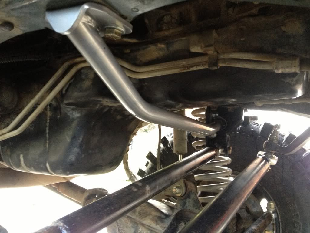

I installed my Rubicon Express RE1670 Track Bar Brace/Frame Connector today. It was a tight fit for sure as one of the bolts didn't line up perfectly but I got it on and bolted up tight. I feel so much better not that I am tying the frame together under the motor and supporting the track bar brace better. I'm kinda hard on this old girl and this may help prevent serious damage to the unibody frame.
And I just ordered the next component for my frame support upgrades. I decided on the C-Rok steering box and frame support kit. It is simple but effective and should help strengthen the frame behind the steering box. The kit was reasonably priced and I can't wait to install it after it comes in.
