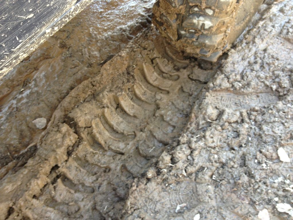

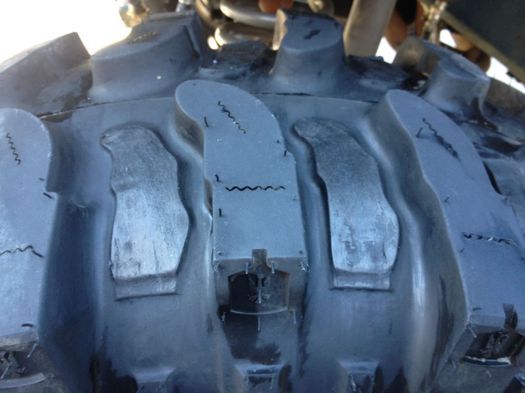

Well it's been a little while since I updated this thread. I've made several changes to my rig and they all made huge improvements. In no particular order:
I decided it was time to look for more traction. Most of the rigs I wheel with are on AG tires and I needed to do something to improve my chances of keeping up with them. I decided to cut the small lug out of my boggers. There are many different ways of accomplishing this. I used a hot chisel blade on an air hammer. Worked fantastic and was very controlled. Every lug came out perfect and there was no damage to the adjacent lugs.
These tires are 38.5 X 15 X 16. They were basically brand new. Under 100 miles on them before I took the knife to them. I left about 1/8: of the lug to help prevent punctures from sharp rocks and sticks.
The tires clean out much better. The performance is night and day difference. They aren't AG tires but they are a lot closer than they were. If they do start to Que Ball a slight blip of the throttle and they are clean instantly.

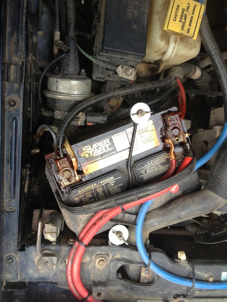

It was time for some Winch maintenance so I did a complete rebuild on the planetary side of my little Warn M8000. The winch is very new but had ingested some water during it's very short time with the previous owner. The planetary side was full of water, rust and mud. I soaked every part in the parts washer and cleaned them spotless. I then soaked them in 2 stroke oil for a half hour then covered them with grease and put it all back together. Thing works so much better, it's like brand new. I use the winch on almost every outing so maintenance has become a weekly thing. I respool the winch after every weekend and inspect the cable for damage washing it and lubing it with AeroKroil as I rewind it. The neoprene cover keeps mud and dirt out of it when not in use.
I also ran all new power cables to the winch and from the battery to the chassis. I ran a 0 gauge cable to the control box and ground directly from the winch to my bumper. I also ran a 0 gauge cable from the negative side of the battery directly to the chassis for additional grounding capacity. In the process of all this I added a 350 amp 12v Accessory plug to the bumper so I have power available for jump starting and or doubling up on batteries without opening the hood.

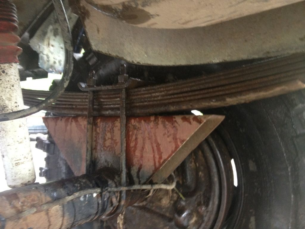

My XJ was starting to sag just a little in the rear and it couldn't take big bumps or drops very well without bottoming. It was really bad when i was all loaded up with 500lbs of camping gear. I pondered many different options including Monroe Max Air shocks and or spring overload shocks. My existing rough country shocks are in good shape and I didn't think it was a real good idea to put that extra load on the frame end of the shock so I decided it was time to rebuild my spring pack.
My existing springs in the rear were stock XJ with a single helper spring added to the pack. With the addition of longer shackles this gave me a super soft ride and fantastic flex. I've never had my rig on a ramp but on the trail it flexes really well and everyone I wheel with has always been impressed with how well it flexes. All this is great but if it can't drop off a 12" ledge while loaded without bottoming then it was not going to cut it. I found an old set of F250 springs at the junk yard for $20 and I went about building as set of custom springs for my jeep. I am a self proclaimed Shock Valving expert and a leaf spring is very similar to the insides of a shock absorber so I had a pretty good plan for what I wanted to do. I wanted a soft ride that could carry a decent load and wouldn't bottom out every time I hit a bump at speed or dropped off a ledge.
I took the top three springs from the XJ and mated them up with the bottom 3 springs from the F250 and bolted it all together. I used the factory plastic pads and the F250 alignment straps to keep things working smooth and staying in alignment. The combination came out perfect. Still a super smooth, soft ride i can hit bumps at almost any speed I want now. I tested it over the speed bumps in my neighbor hood and I can hit them at 40+ without even a hint of bottoming. The suspension rolls through those bumps like they were warm butter. Flex is slightly compromised but so far I have yet to lift a rear tire off the ground during wheeling.
For those of you wondering my lift blocks are made out of 3" X 6" rectangle tubing. They are welded to the axle just like a spring perch is welded to a stock axle. The funny angle allows the spring to flex really well but the axle doesn't try to wrap as much under acceleration and braking. Linda like a lift block and traction bar all in one. I got 2" of lift out of this spring pack combo and it makes my Jeep sit almost perfectly level now.

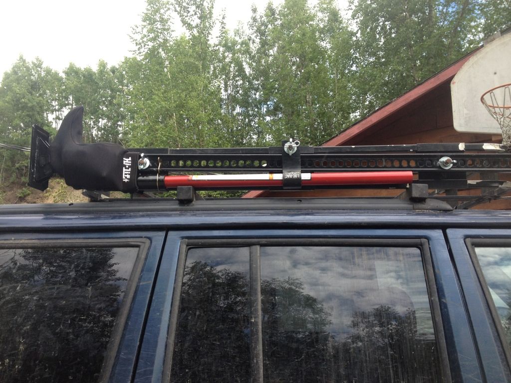

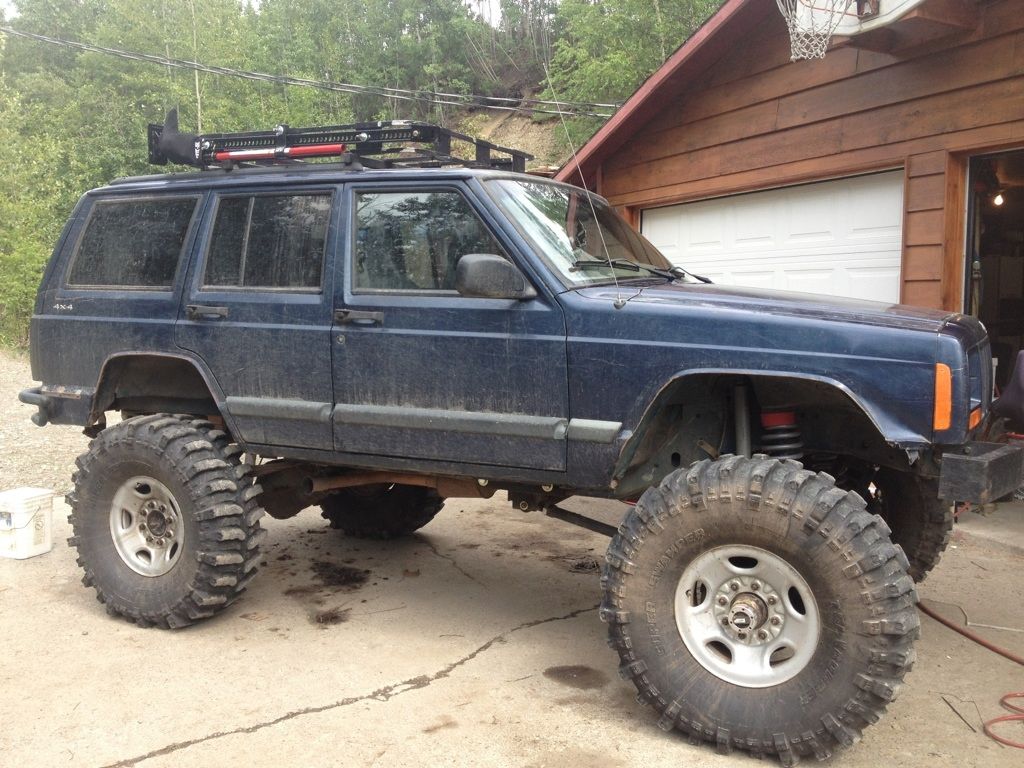

We do lots of Jeep camping around here and I needed a place to carry my recovery gear. I have been looking and looking for a roof rack but shipping to Alaska has kept me from pulling the trigger. At the 4X4 Meet and Greet in June I met a guy who had a rack he didn't need any more. It was just the size I was looking for and perfectly priced. It already had Quick Fist clamps for my shovel and a lock and ride bracket for my HiLift Jack. It's made out of aluminum and is 43" X 50" on the inside so my full sized 38" spare will fit right inside with no problem. I removed the factory sliding rails and used the existing bolt holes that hold the factory rails in place. I went to Fastenal and bought four 6mm X 80mm Allen head cap screws and bolted the rack directly to the roof. It works perfect. I mounted the rack just forward of center on the roof so the load would be more evenly spread over the suspension and so the lights wouldn't reflect off the roof so much.. The paint is pealing in some spots and this winter I plan to remove the rack and take it to my powder coater.
Here are a few pictures of how it sits. I have a high lift jack on one side, a shovel on the other side and an ax on the rear. I just ordered a 32" Combo 14400 lumin LED CREE Light Bar for the front and a couple 18watt LED floods work lights for the rear. I will update the pictures when I get the light bar mounted.

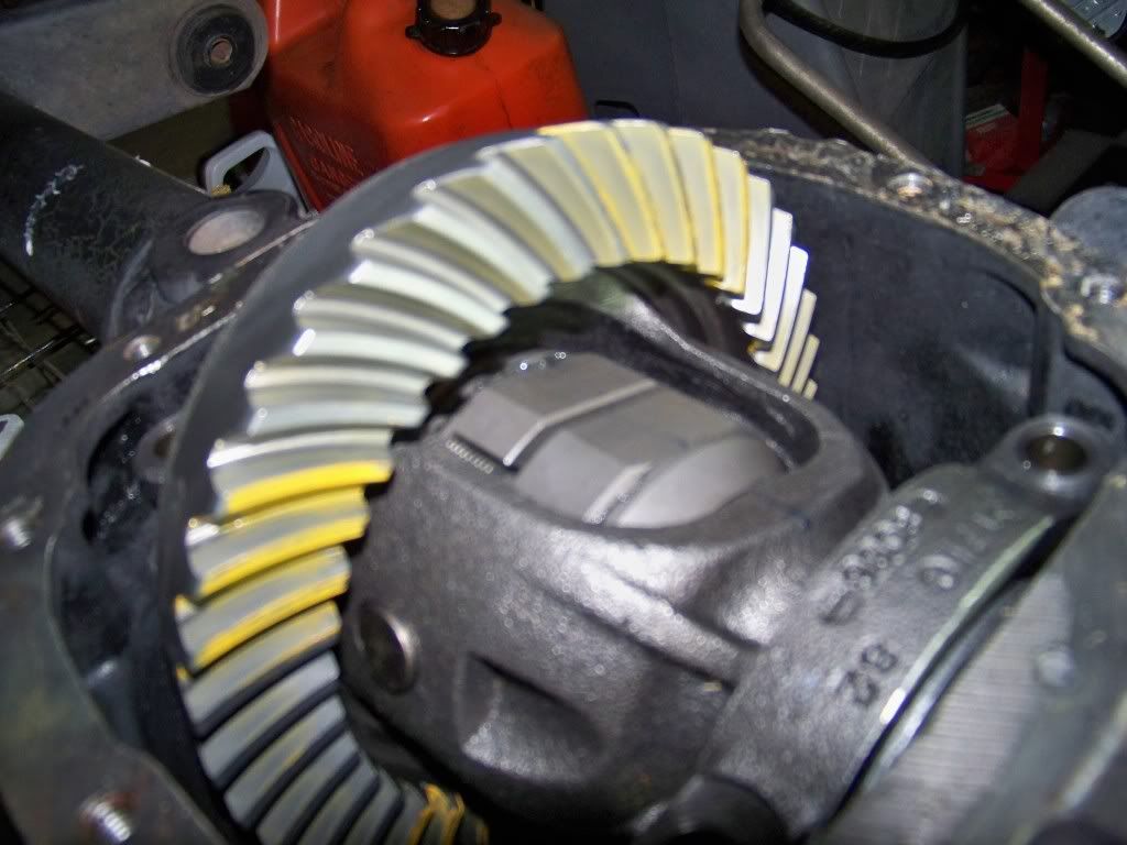

As mentioned earlier, many of my wheeling buddies are rolling 42" or larger AG tires so my little XJ on 38's has a tough time keeping up. I decided to lock up the front axle. The rear was already welded so I just needed that extra little bit to keep all 4 tires pulling all the time. My budget limited my options so I did a little research and decided to go for a Drop In Lunch Box style locker. There are several different Lunch Box lockers out there and they are all fairly similar in how they operate. I knew my spider pin was worn so I decided on a Spartan Locker because it came with a brand new hardened pin with the kit. $265 shipped to my door UPS Blue Label. From what I read all the different style Lunch Box lockers are pretty equal in design , function and quality.
Install was simple and the locker works exactly as designed. The difference in performance is amazing. I can't get over how good this jeep wheels now. All my buddies with AG's are amazed as well especially when it's time to use a little side bite and climb out of a rut or up a slippery off camber surface. I can drive with my head now instead of using my right foot all the time. I've been on about 10 different outings now and I am so happy with this inexpensive upgrade I can't get over how well it works. Big Props to the guys at US Standard Gear and their Spartan Locker.
