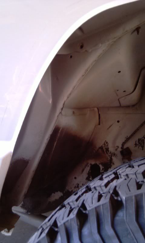

pounded pinch seam over to clear tires. partially trimmed the fenders so i could drive it. i am going to retain stock flares with custom mounting brackets.

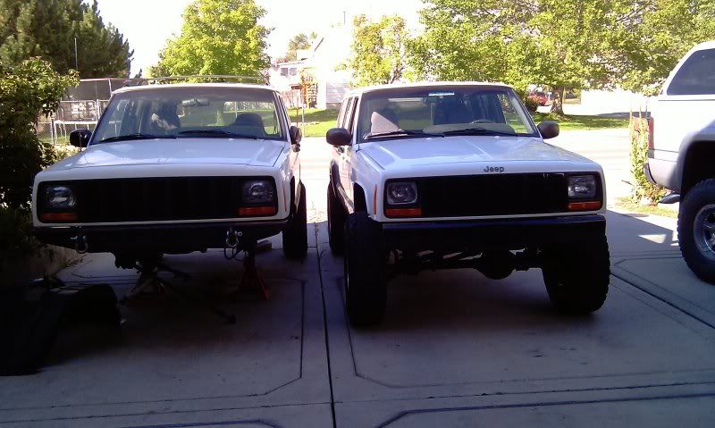

pics next to my "tired" 97 i was orignally going to pull the bumpers off my 97 and use them but i now have new bumper ideas. i want to run a spare tire on the rear and i also have a 9000lb winch i want to mount up front.

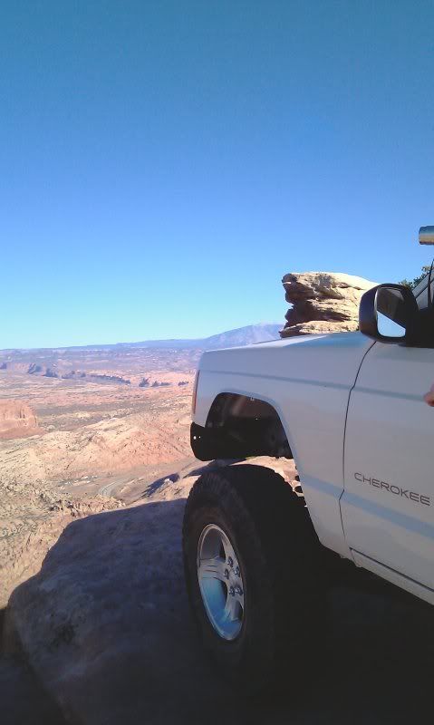

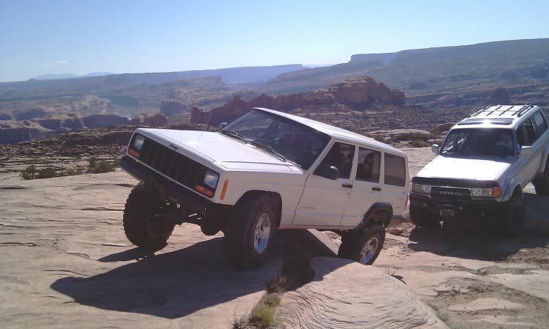

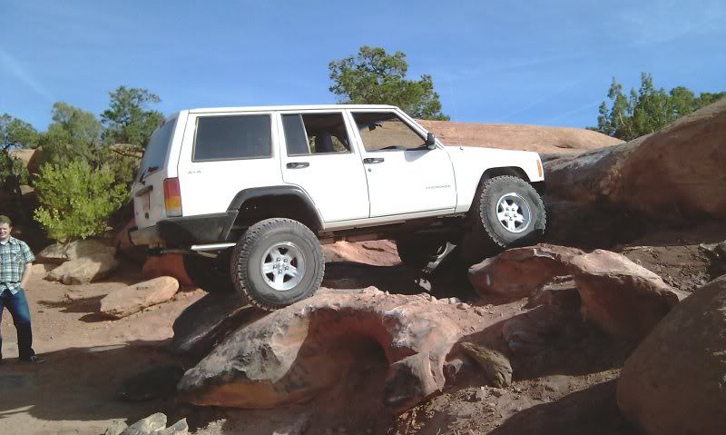

jeep worked impressively in moab. got my heater core and interior reinstalled about 430am friday morning and left for moab at 6am. ended up adjusting control arms out 1/2" for tire clearance which in return also improved ride quality. jeep died after returning to camp friday evening and wouldnt restart. gauges didnt function properly and motor would turn over and not fire. ended up being faulty CPS which was simple (yet expensive).

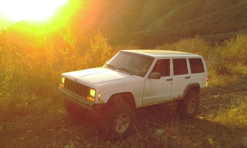

very clean xj MCObray, took xj wheeling up af canyon last night.... i need to get sliders on ASAP. i came too close to the rockers for comfort. then this evening i ran up to some local mnt trails with some narrow shelf roads and alot of brush. gave the jeep a nice coat of rocky mountain pinstriping. but on the bright side it did brush all the mud from the previous nights adventure off.
