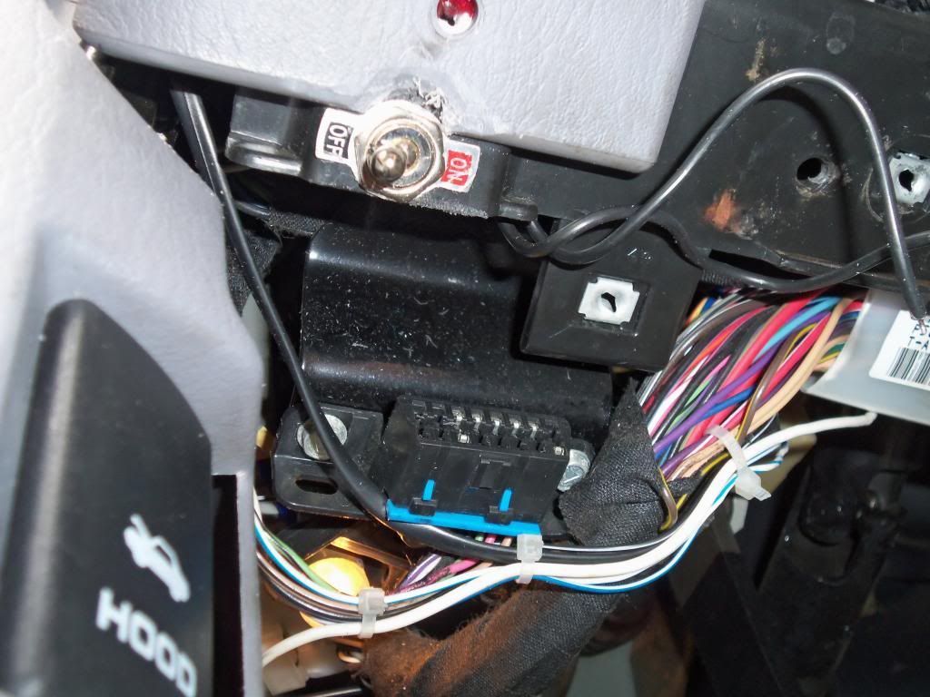

Extended Idle Switch
Had some free time today so I added a nice extended idle mod. It was extremely simple and only took about 15 minutes to do.
First I found Pin A-12 on the Black (Frontmost) PCM connector.
Then found a good location to tap into the wire.
Then ran a wire from the splice location through the firewall under the dash. Also tucking everything nicely back into the plastic harness cover.
Finally mounted a small toggle switch under the dash.
All in all, I think it came out pretty good.

Yeah I was pretty simple man! If you run into any problems just message me. Oh and be careful when you are tracing the grey wire back up the harness from the connector. There are two identical Solid Grey wires in that harness along with grey striped as well. Other from that I spent $4 on that switch from Advance Auto. The wire was actually some speaker wire I had laying around.
