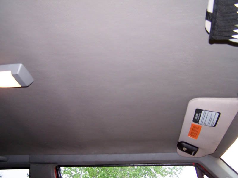

To do it correctly, you need to remove the headliner board from the Jeep. Dont bend the board, remove all material, and scrape off all the old foam and glue. Grab some headliner glue (not 3m super 77) get whatever material you want (I used actual headliner material from the fabric store) glue it down, and let it sit overnight before re-installing the board.
This pic shows the results of my reupholstered headliner (25 bucks in material and glue) and I re-wrapped my overhead console the same way.
