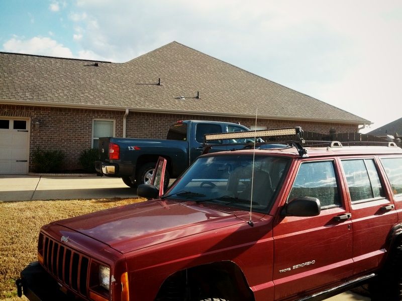

I made a couple brackets that will put the light bar between the roof and basket. The brackets that came with the light were about 1.5" to long to work for how I want it mounted.

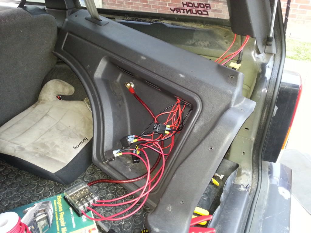

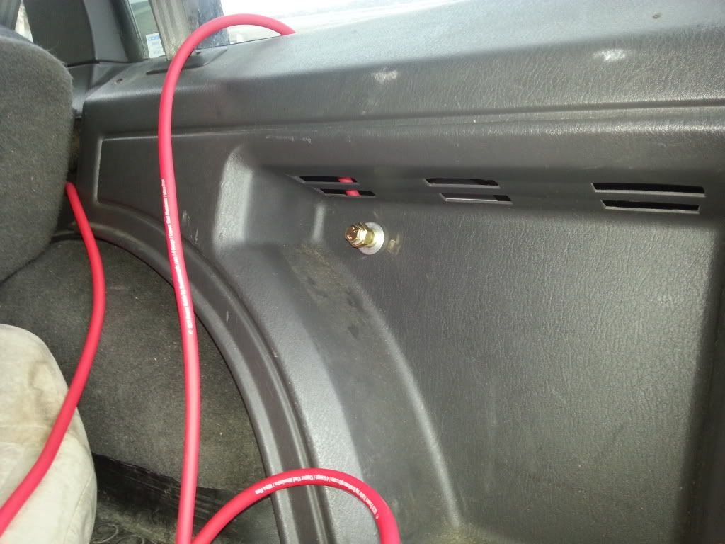

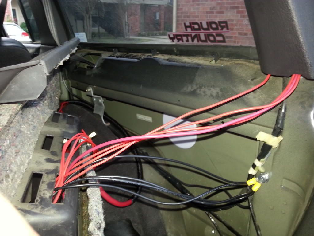

Made a power point in the back using a side battery post and some 4AWG wire. 13.67 volts at the battery and 13.65 volts at the back of the Jeep.
It's a mess right now. I will get it looking better tomorrow.

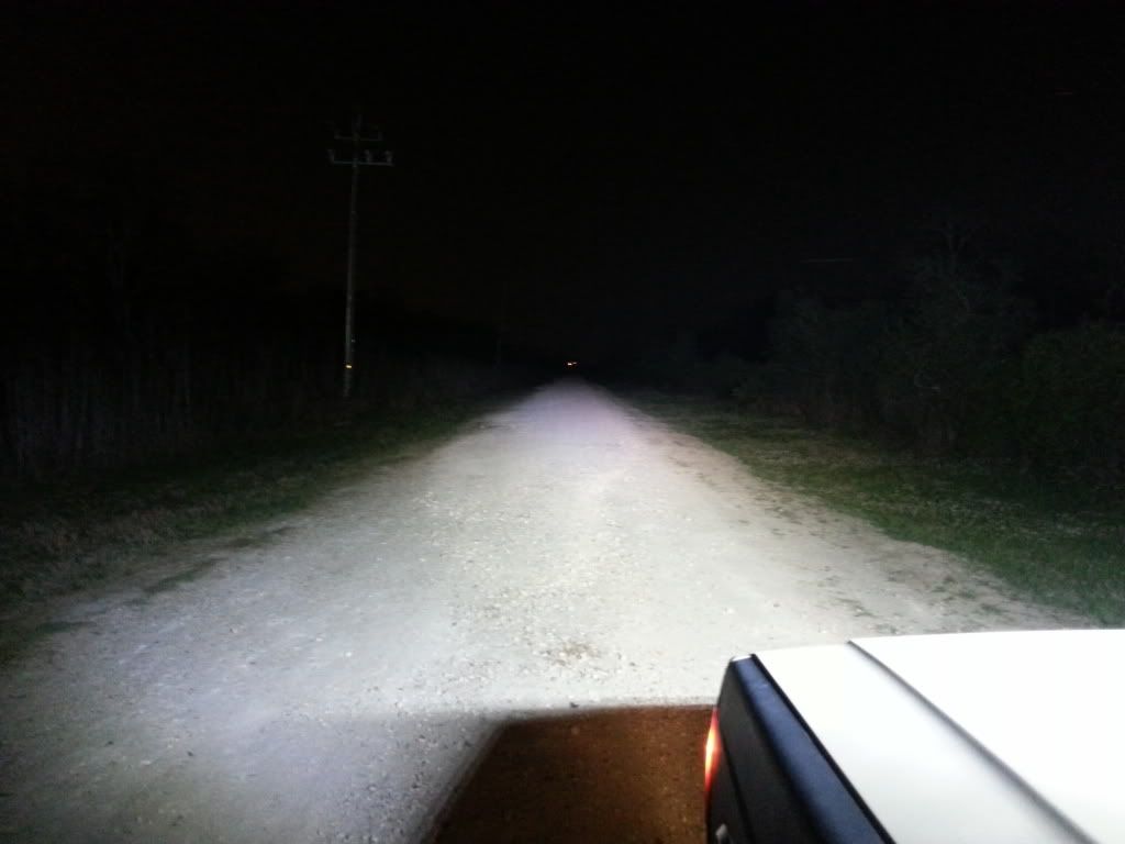

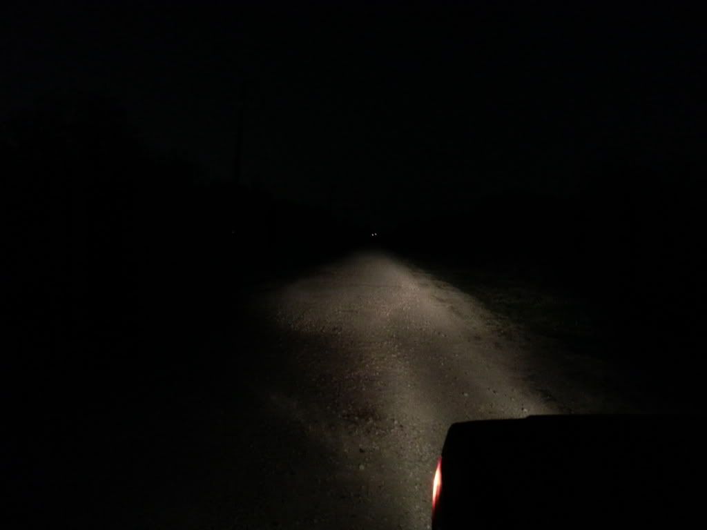

Low Beams
Low Beams & 31.5" Bar
From the back
From the front
gfox48 is offline
