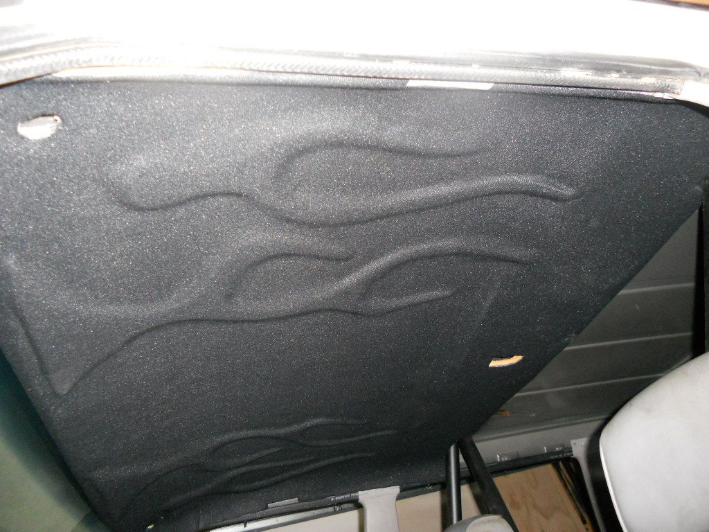

headliner build
took down the stock headliner, stripped all the foam and covering.
then used some high density neoprene type interior foam.
cut out the designs, and glued them to the backer.
then glued the new headliner material to the backer.
im a old school hot rod guy, so i went with flames for fun, you could cut out any design you like and wrap accordingly.
end result.

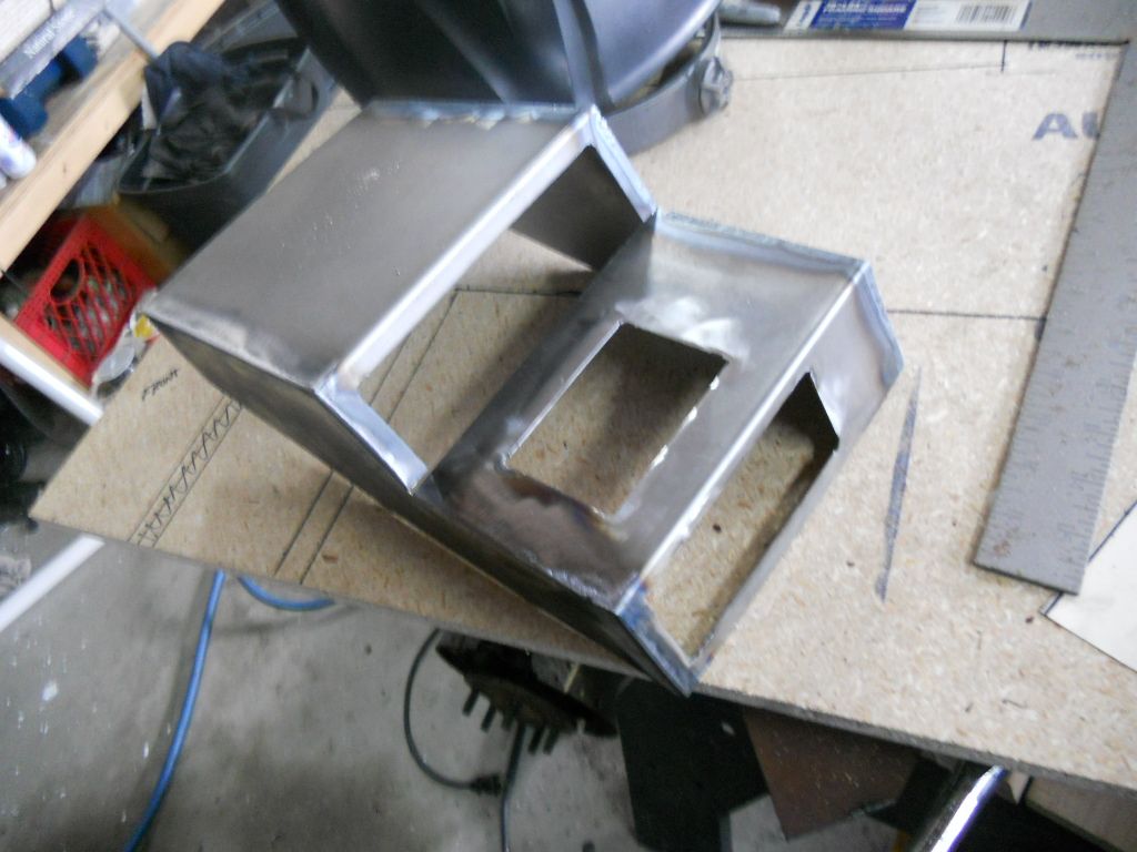

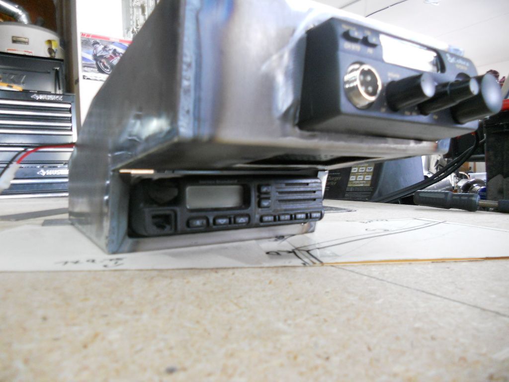

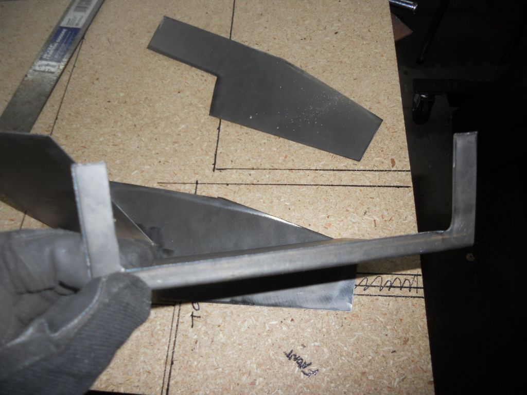

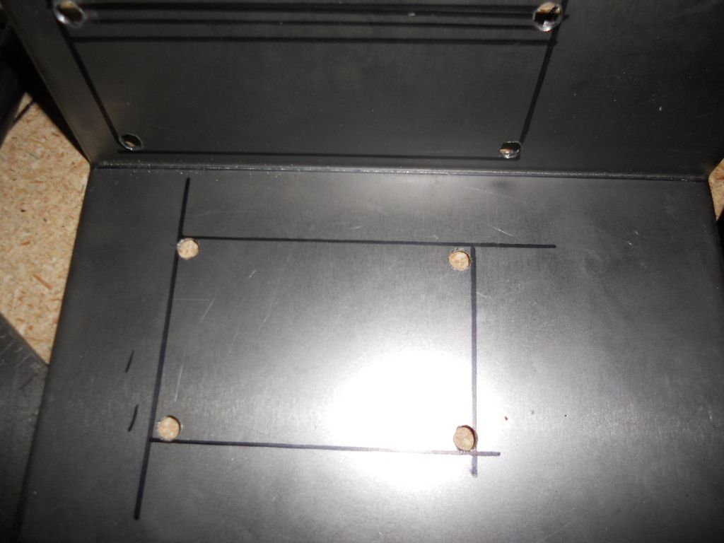

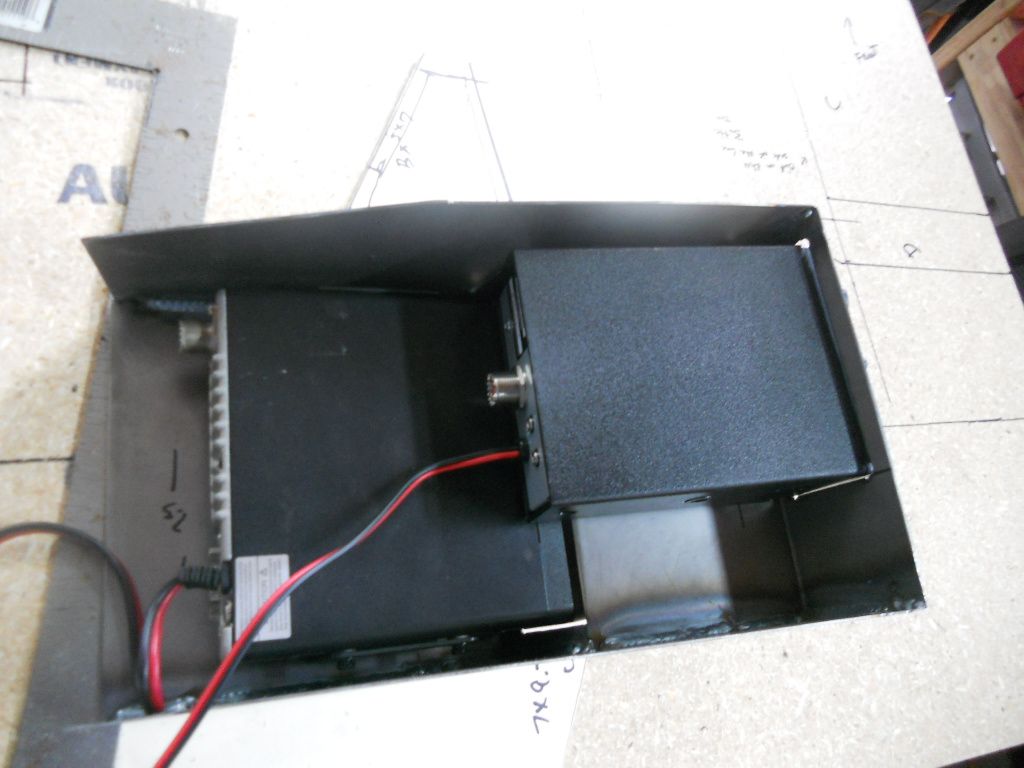

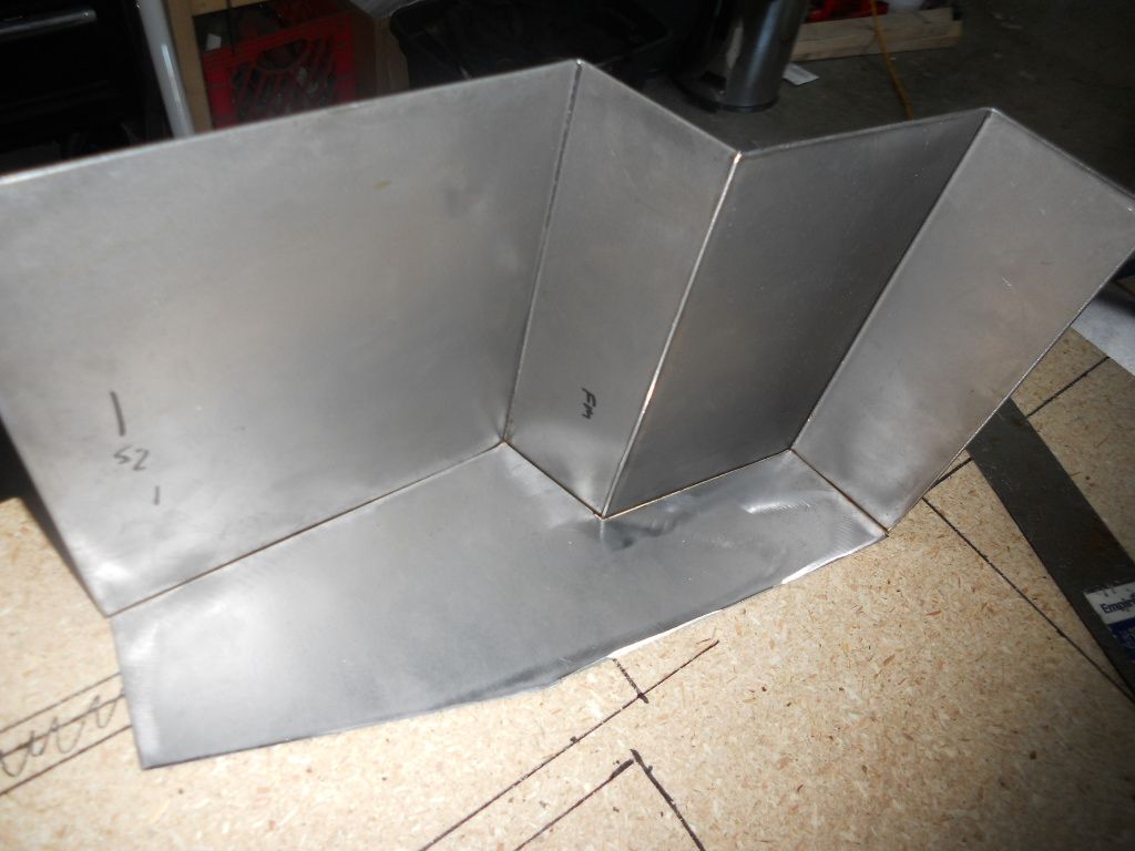

pics of the overhead console build.
started with some 18g sheet. and plasma cut out all the pieces.
bent up the pieces on the brake, and test fitted them.
pre drilled the holes to cut out the access holes.
cutouts made for the CB/ and the radio.
burned it all together.
test fitted everything before asm.
installed.
