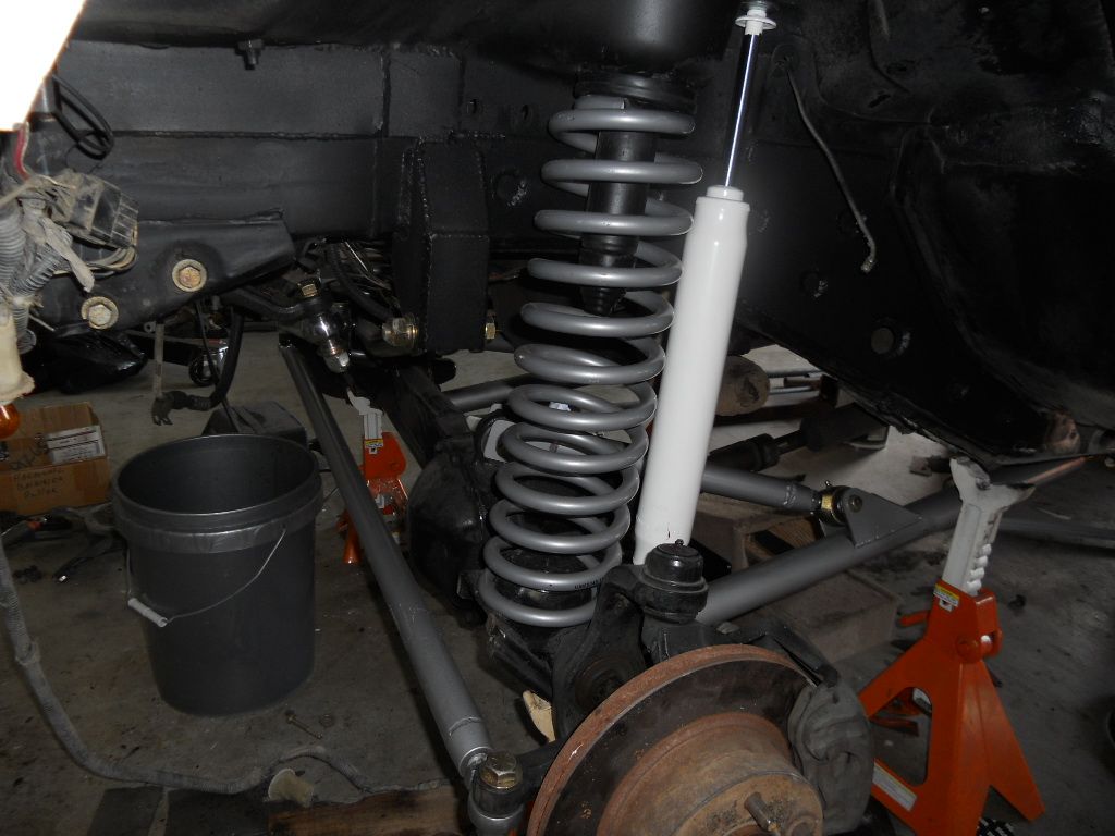

grabbed some 4.5 RE springs for super cheap, used these with the shackle relocation to net about 5.25 lift.
5.5 RE springs for the front.
and some cheap ES3000 shocks to shake it all down, will replace these with some bilsteins sooner than later.
also added a trans cooler while i was in there.
