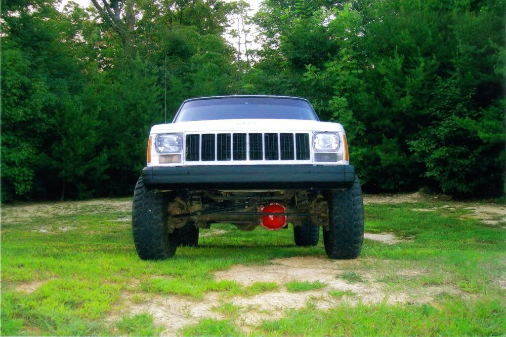

I painted one while it was on (front), and my rear I painted during a gear oil change, with it off and prepped nicely.
Both have been holding up very well. I had intentions on painting the front one again with proper prep work after I changed the front oil, (like a year later) but when I had the cover off and de-greased it, the paint looked great again so I didn't bother.
I used Rustoleum "industrial" safety red.
Degrease with acetone, scuff with sandpaper, wipe down again, and spray.
