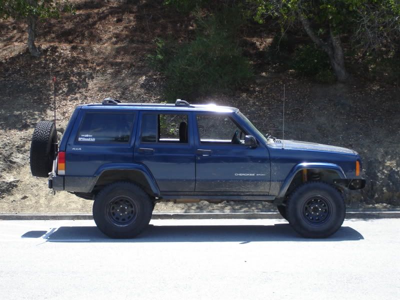

I has a lot of fun with just a 3.5 inch lift and 31's. Power was still ok on 3.55's, and it looked great.
I haven't lifted it any higher, and it's clears 32s now.

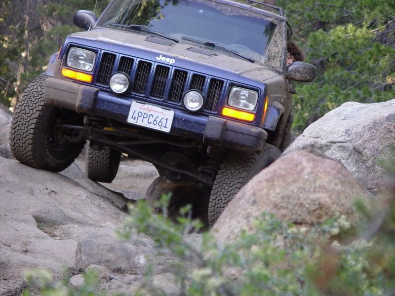

This was 2 years ago. 31's and the RE 3.5 superflex. RE just got bought by 4 wheel parts so you may be able to get their stuff again.
