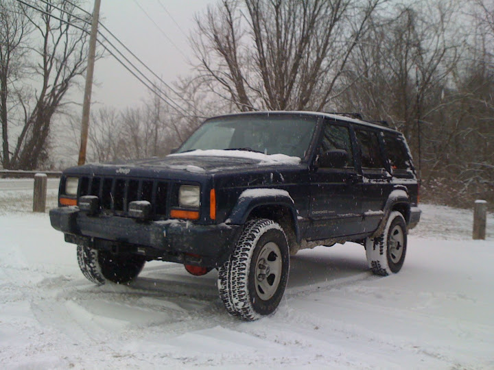

IRO hooks or a hitch are my vote. I had a draw-tite model. Instead of cutting the lower air dam so the hitch was hidden, and protruded from it, I just cut it out between the end caps. The hitch nearly perfectly took its place and it looked great IMO. I had bought the hitch so I could mount a winch. I never did get a winch until I had upgraded to a front bumper though (with receiver). I did use its pull hooks a few times, worked great.
