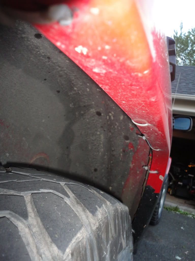

I just snipped the extra metal to the inner fender, making sure to preserve the mount holes, and folded in with a hammer massage. Then I trimmed the flares around my rocker replacement and zip tied from the mounting bolt holes to drilled holes in the flare.
