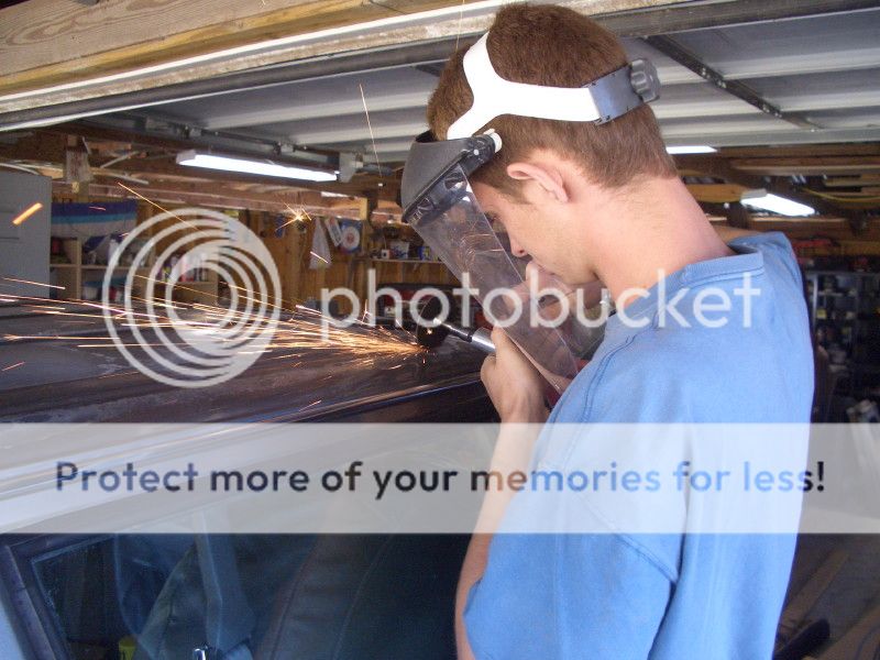

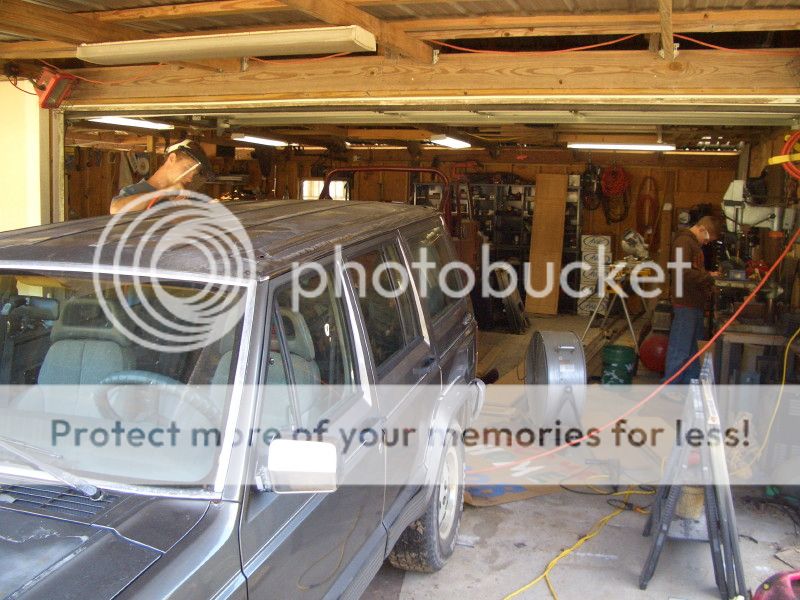

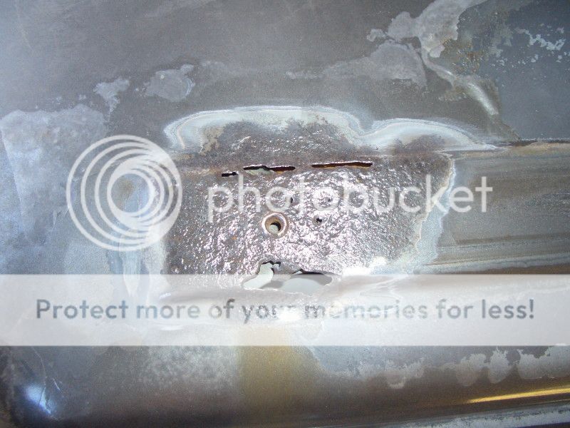

Here is a little bit of meat and taters! Starting to get into the repair of this truck. We are cutting out the bad spots and welding in new metal. My son, Clay, is a certified welder. And my other son, Fallon, is a willing wrench-twister!
Here are the 4 corners of the roof after the roof rack has been removed.
I want to remove the rusted metal and weld in new metal. Clay is cutting out the rotten stuff with a die-grinder.
Another angle of Clay, and my youngest wire-wheeling some bolts for another project. it's GREAT to have kids!
First cut.
First patch. The "foot" of the roof rack will cover over these repaired areas.
HOW do you remove the lift gate hinges?

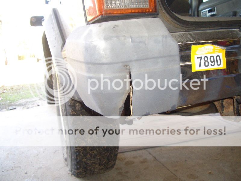

Clay on the creeper, Fallon kneeling next to him... trying to remove the rear bumper. The BUMPER is a CHALLENGE!!!! I am wanting to save it in case someone needs a nice chrome bumper, but I am leaning toward taking a cut-off wheel to it. We can't get to the bolts, and they are rusted into mutated lumps. Is it worth saving? Anybody need one?
Here are the plastic corners. Same concern... anybody need the corners? We will be making front and rear bumpers for this heep.
That's all for now. Mama has plans for us this evening. Going to see Christmas lights! I always grumble about it, but I end up enjoying myself!

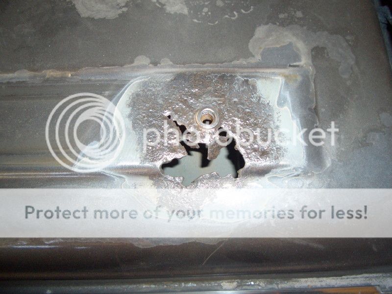

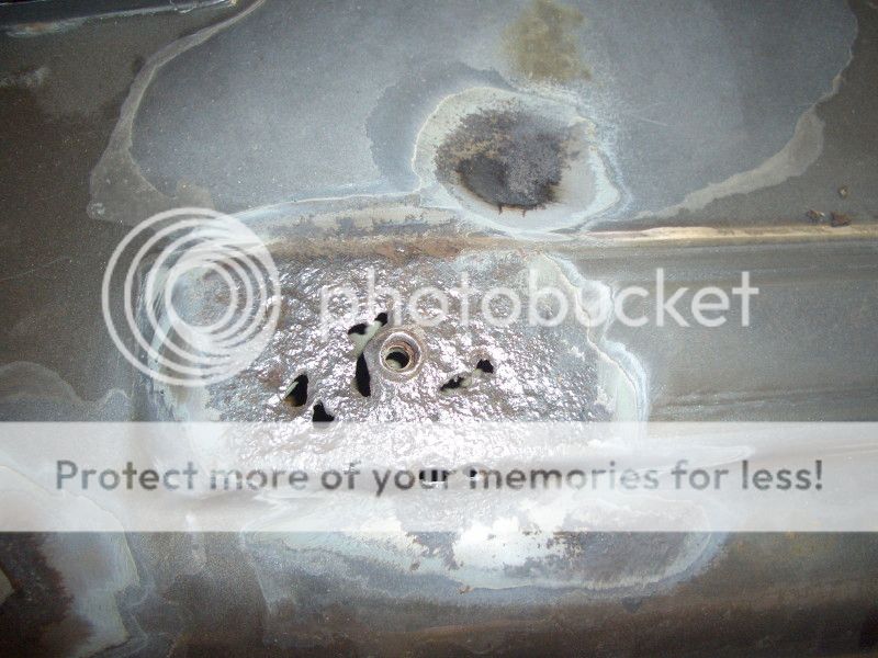

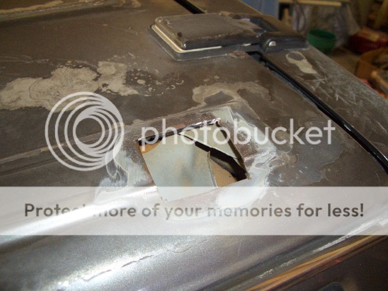

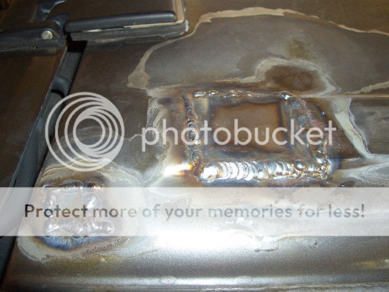

We finished cutting out and welding up the rust holes in the roof. The patches are okay, but they sure warped a TON! I'm guessing I can smooth them out once I remove the headliner. I plan to build and install some kind of rack on top, and my mental picture includes a foot that will cover these areas, so I'm not TOO concerned. Yet, you know how plans change...
Is there a trick to removing the hinges for the lift gate? I have some rust there too, and I don't want to ruin the covers by experimenting.

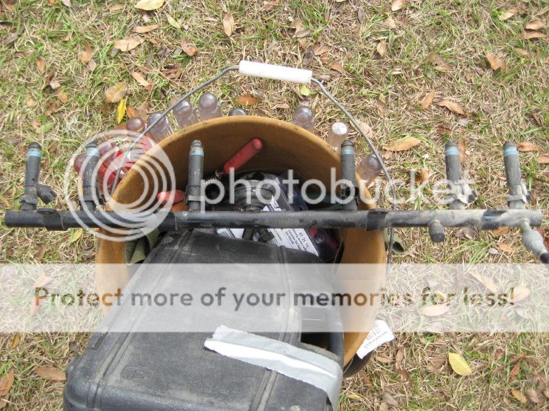

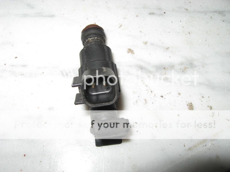

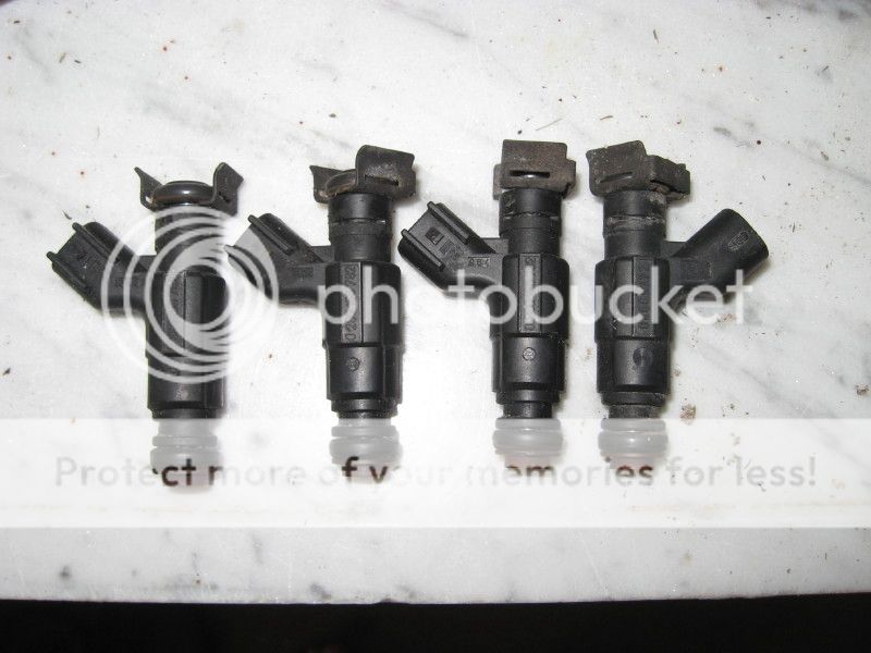

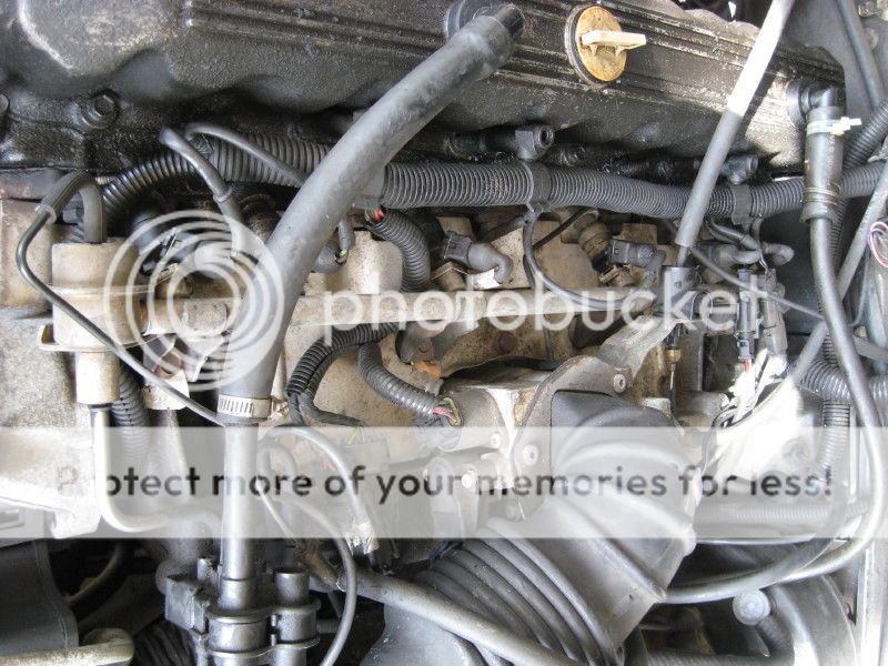

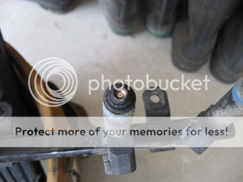

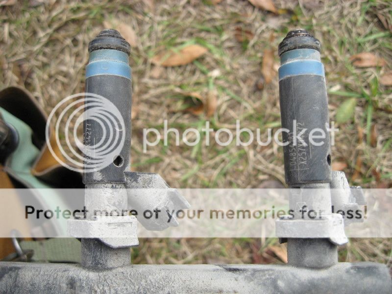

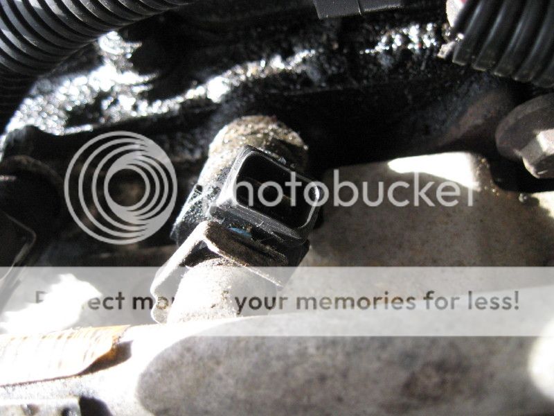

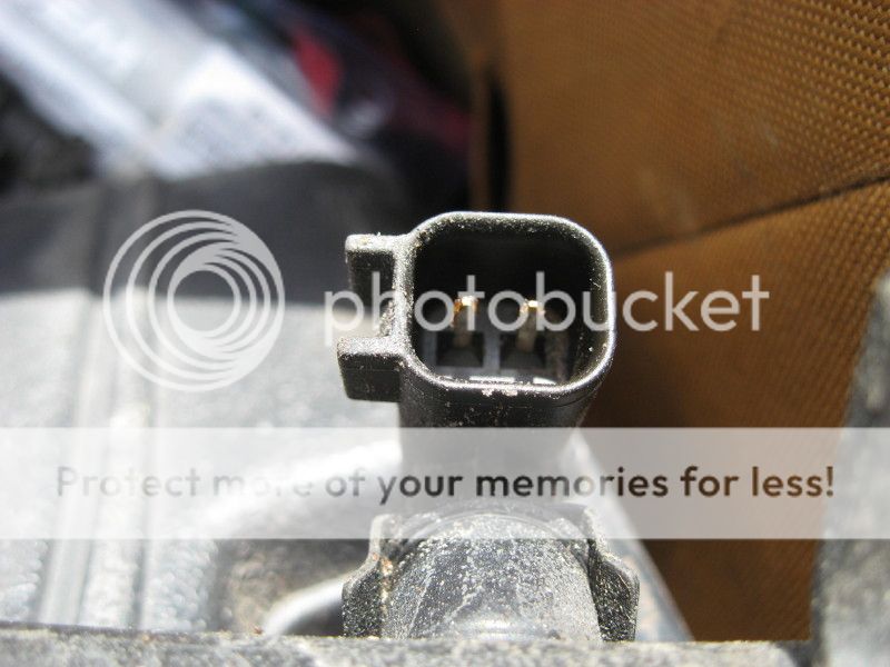

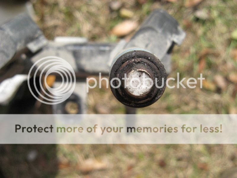

I spent about 4 hours at the JY yesterday with the idea of pulling Neon injectors for the 4.0L swap. There is a ton of info about this swap, and I, apparently, had it swimming around in my head! The JY owner had 3 Neons, but only one had an engine. I easily pulled those injectors and I moved to the Stratus sitting next to it. It had the same 2.0L engine, so I pulled those injectors only to find they are single ported (one hole for atomization). So I left them there. I looked around for a 5.0 Ford, but I saw a line of Taurus cars. I have the impression that the injectors from the 3.0L Taurus is the Coup de Gras, and I went after them. I had to remove the plenum on top of the engine to get at the injectors. It took awhile, but Hey, if you want the good stuff, you have to work for it... right? I managed to remove the first fuel rail only to find that these injectors, also, were single ported. Bummer! A total waste of time! So I went over to one of the dozen or so Cherokees sitting in the yard. I wanted a spare fuel rail. The 2nd XJ I checked still had one, with injectors, so I pulled it. I was thinking that these factory injectors would be better than what is on my son's XJ as he has a leak or two. I got out of there with 10 injectors and a fuel rail for $40, which I thought was outstanding!
And that brings us to this morning. I was going to change out the leaking injector (it leaks badly) with one of the XJ injectors on the fuel rail. I thought I would take pics for your viewing pleasure! But guess what? Total bust. Wrong connectors!! So I need to go back and read again. Here's the pics.
Neon injectors that I pulled.
Close up of the numbers.
Wrong connector! This is USCAR type. I didn't notice this.
Fuel rail from 4.0L with factory injectors.
Just a close up of the XJ injectors...
Showing the single port for atomization. Still XJ.
I'm betting this XJ ran poorly!!
This is also the USCAR connector. I need to go back and determine what year this changed. Plain stupid!

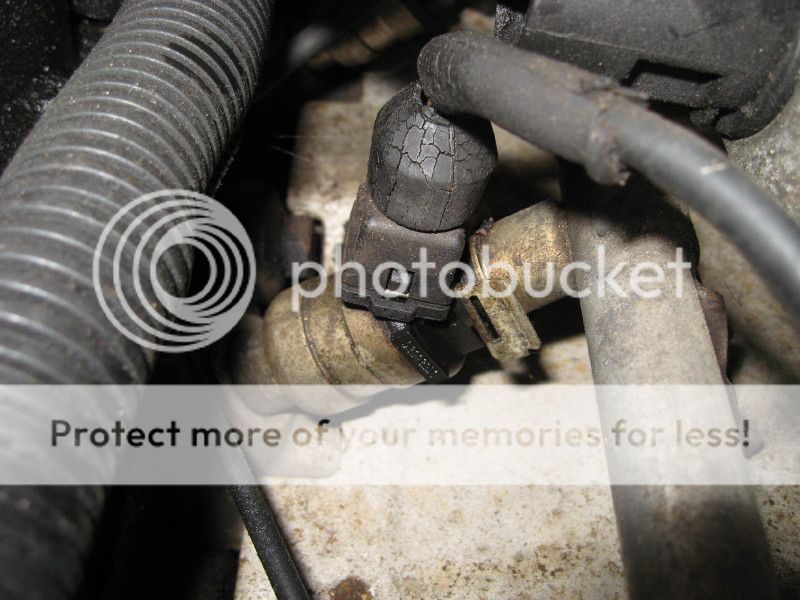

Fuel rail on my son's XJ. PB wouldn't let me rotate the pic!! Grrr...
This is number 4 from the front. It leaks like a sieve! I wanted to at least change this out.
Jet tronics/mini timer connector... what I have on the '90 XJ.
A comparison of the two together.
JT/MT
USCAR
Back to the drawing board!
